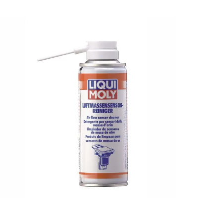

Your guy is referring to your Mass Air Flow meter needing cleaned and that would be the cheapest place to start, plenty of info on how, product should be easy to find.
After that you have read about the Manifold Absolute Pressure sensor, again plenty of info on how to swap and they are very very easy to do.
Good luck and have fun! Up to you to figure out what parts are on your car.
Another thing that can cause issues like this is the idle air control valve (IAC). There is a simple way to check that is working by simply removing it and watching it move when you move the key to the on position without starting the car.
I would probably clean the MAF, check the IAC and if all else fails try to log the MAP or replace it.
