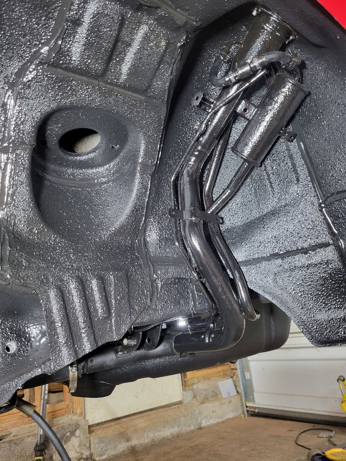

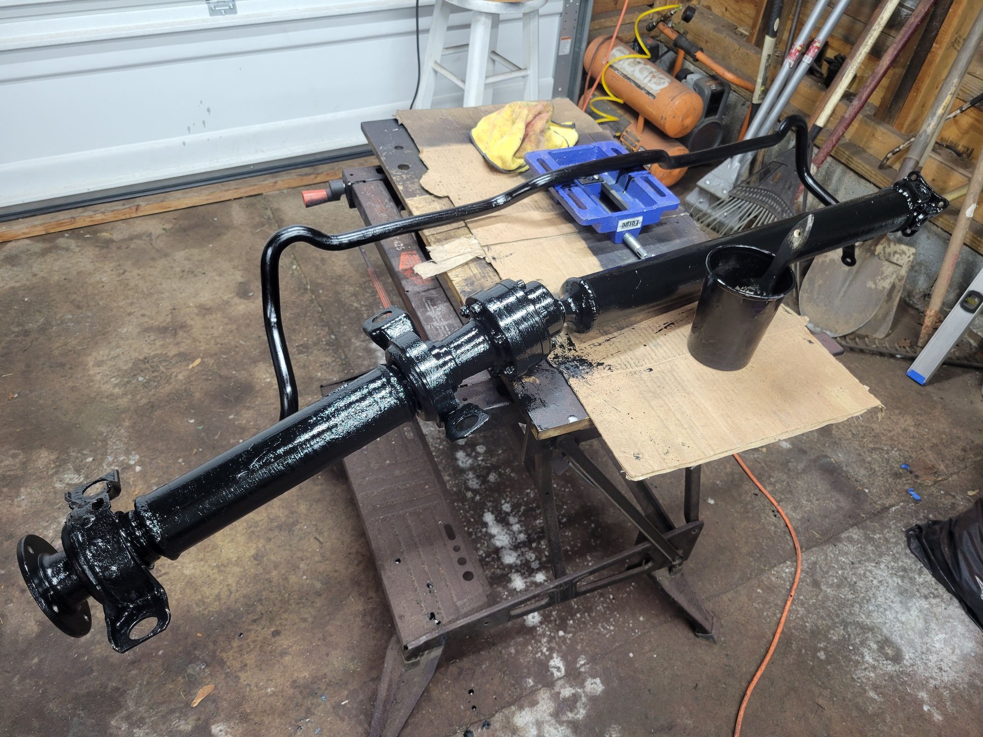

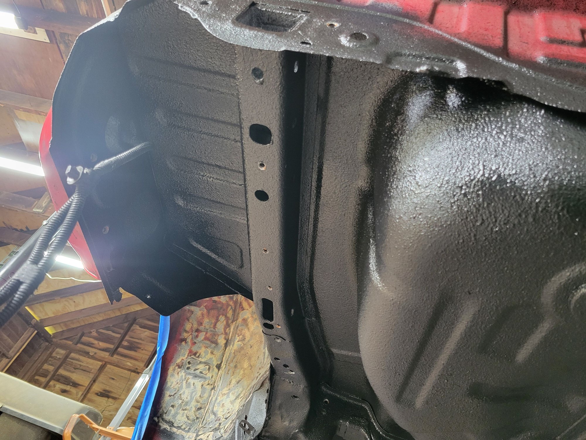

Another productive weekend. I put 2 coats of bridge primer on with a paint brush and then sprayed it with raptor liner. I also finished painting the rest of the parts with the black top coat. I still need to finish grinding down the wheel wells and then paint those. Im kind of regretting doing that because it didnt need it at all, this is just overkill to make it look nice. I also need to finish prepping/painting the fuel tank since that will be the first piece to go in. The bedliner was very sticky and goes on thick, I'm feeling more hopeful that this will be a lasting rust free chassis.

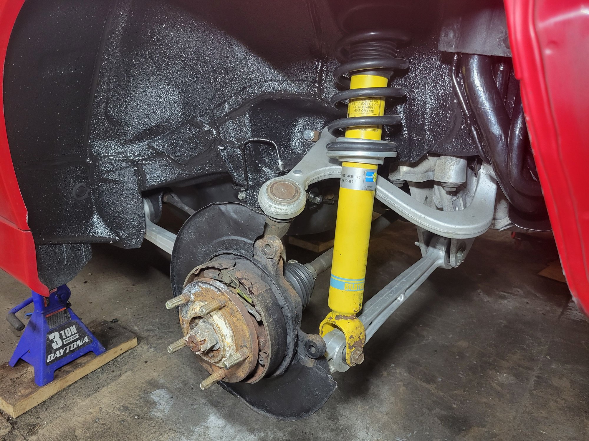

Parts are going back in!

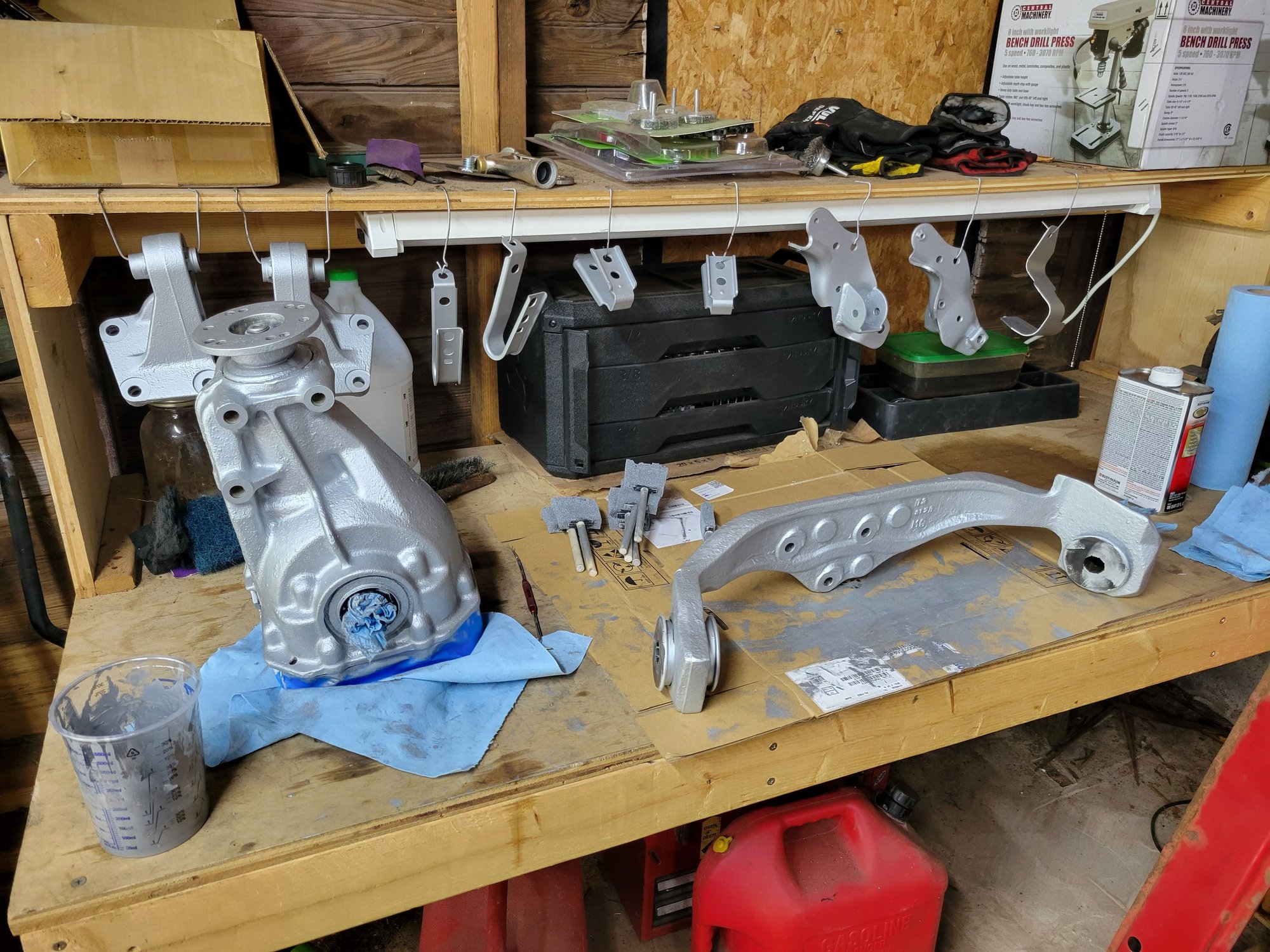

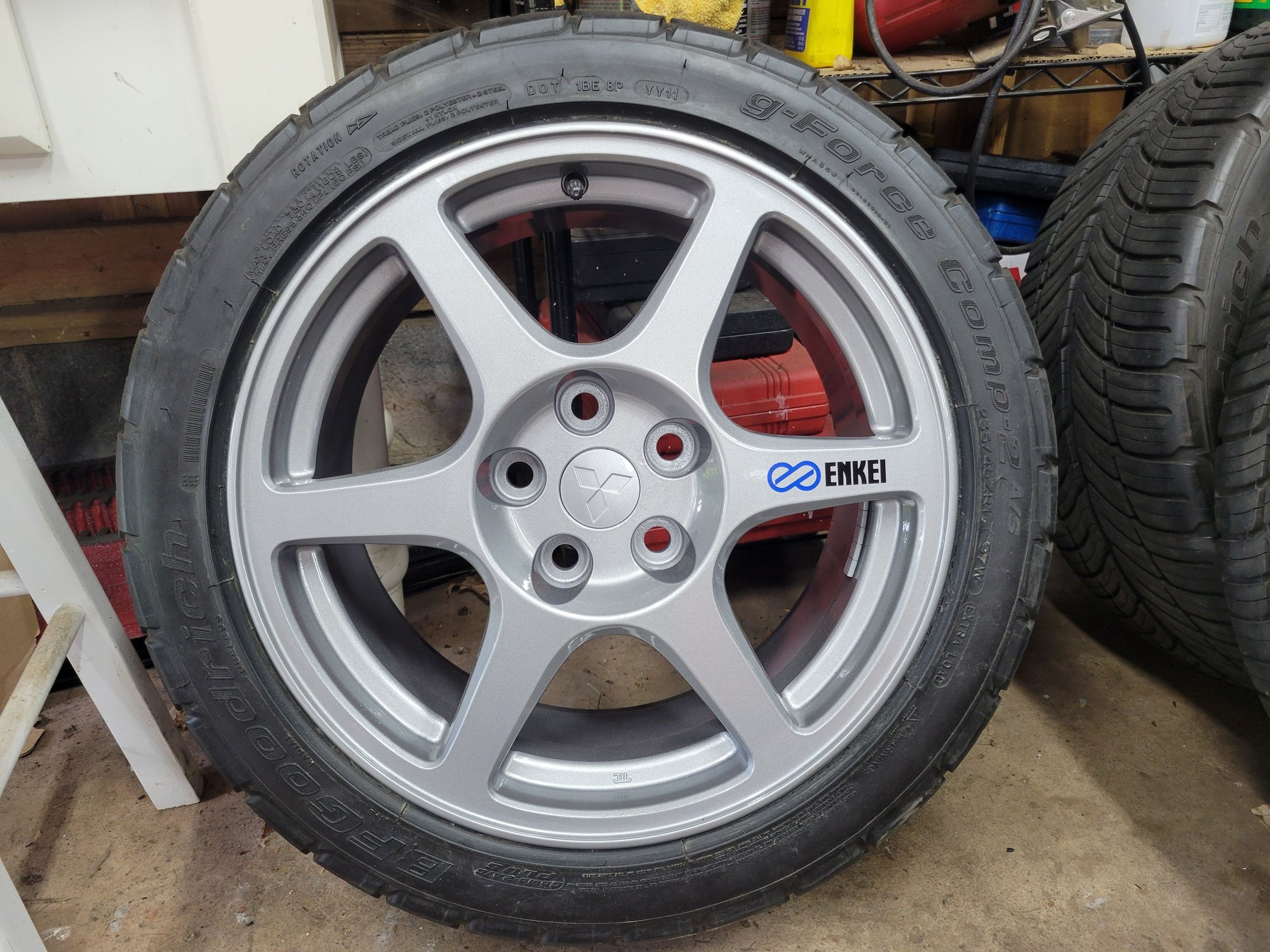

The Evo is back on the road! I briefly painted and cleaned up all the remaining parts to go back on. I wanted some visible improvement so I had the wheels refinished, sprayed the rotors with high temp matte black, sprayed the rear calipers (front calipers will be done soon), and replaced the old wheel lug nuts to complete the look.
