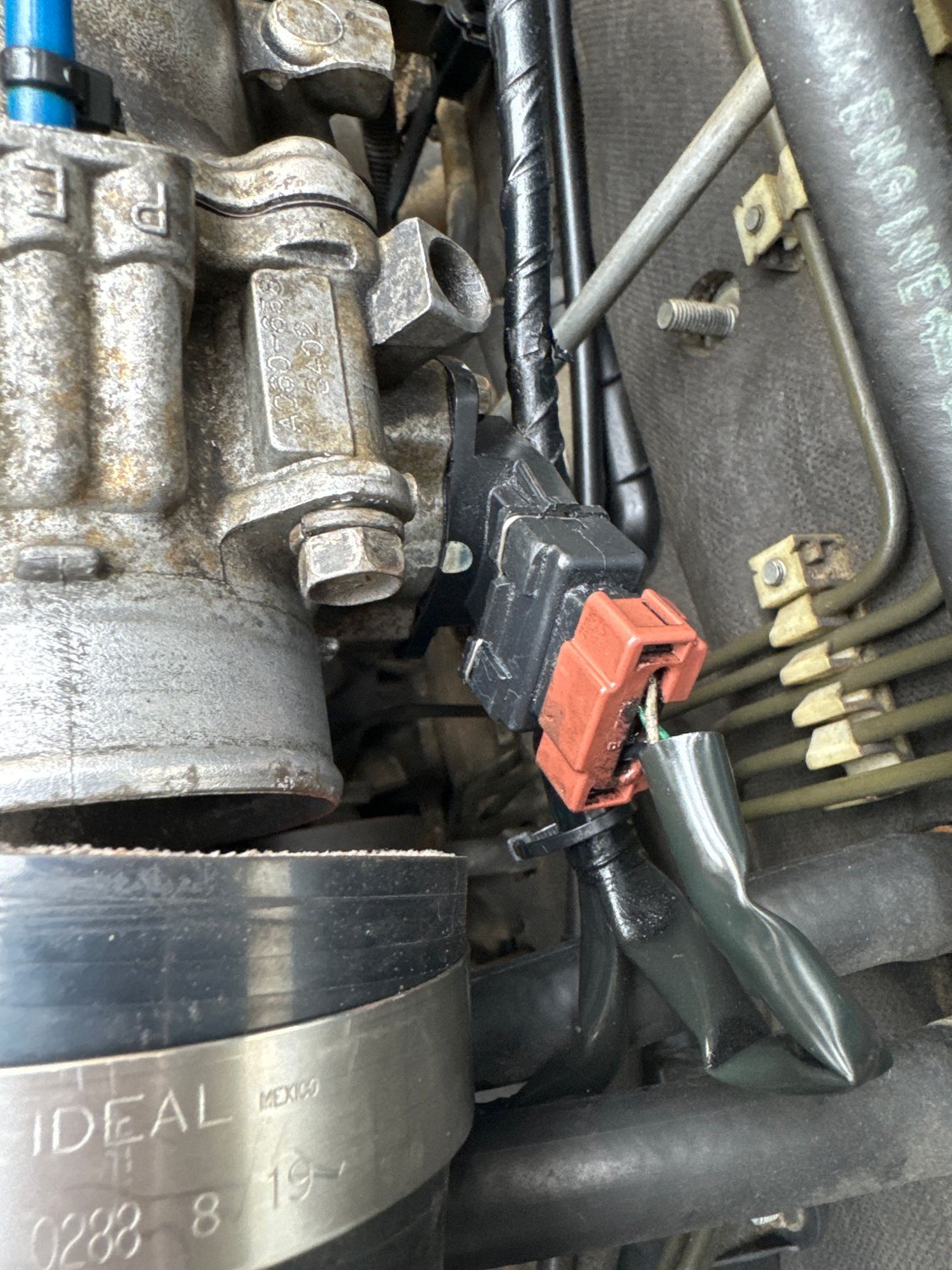

Hey, I was going through the process of rebuilding my throttle body and I can’t figure out how to remove the throttle position sensor clip. Do I just yoink it off? I was thinking about unbolting it but I don’t wanna have to buy Evoscan and the obd2 cable and recalibrate it and stuff.

Pry up the little metal clip, BEWARE it'll try to jump free and get lost.

flathead screwdrier

Thanks I got I out by pushing the side of the flathead into the side of the metal clip and it popped out.
