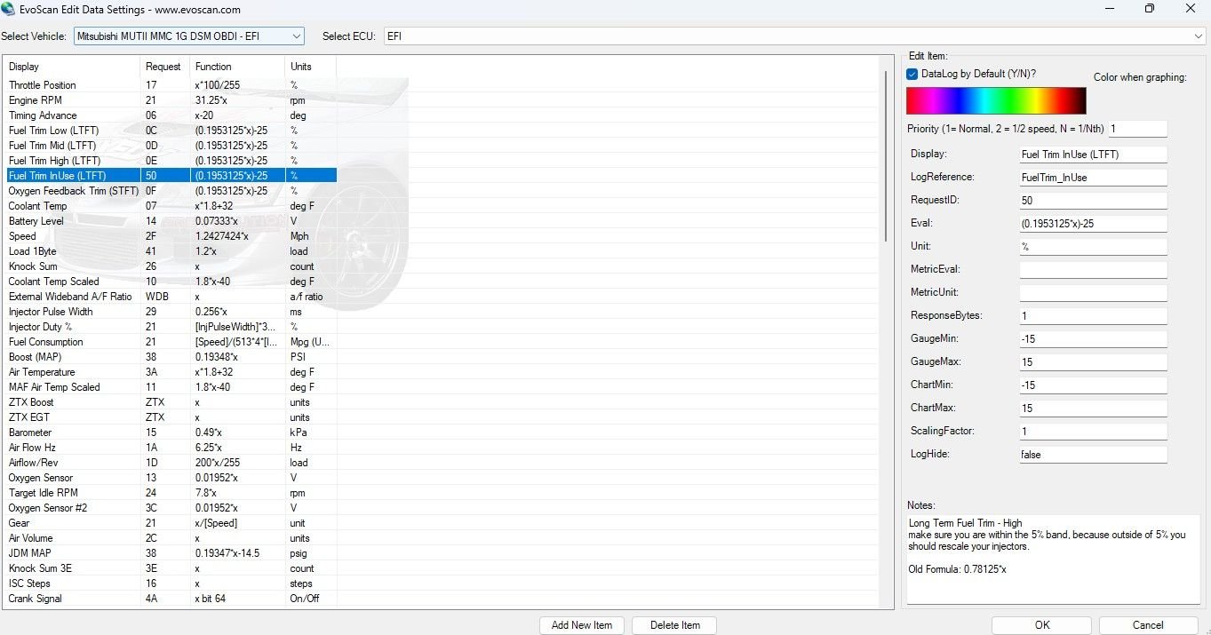

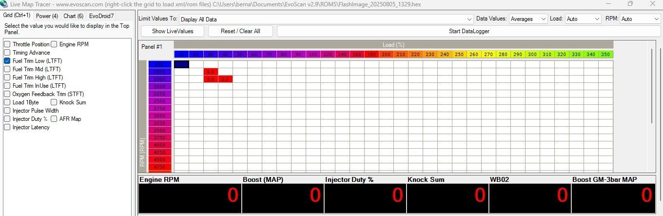

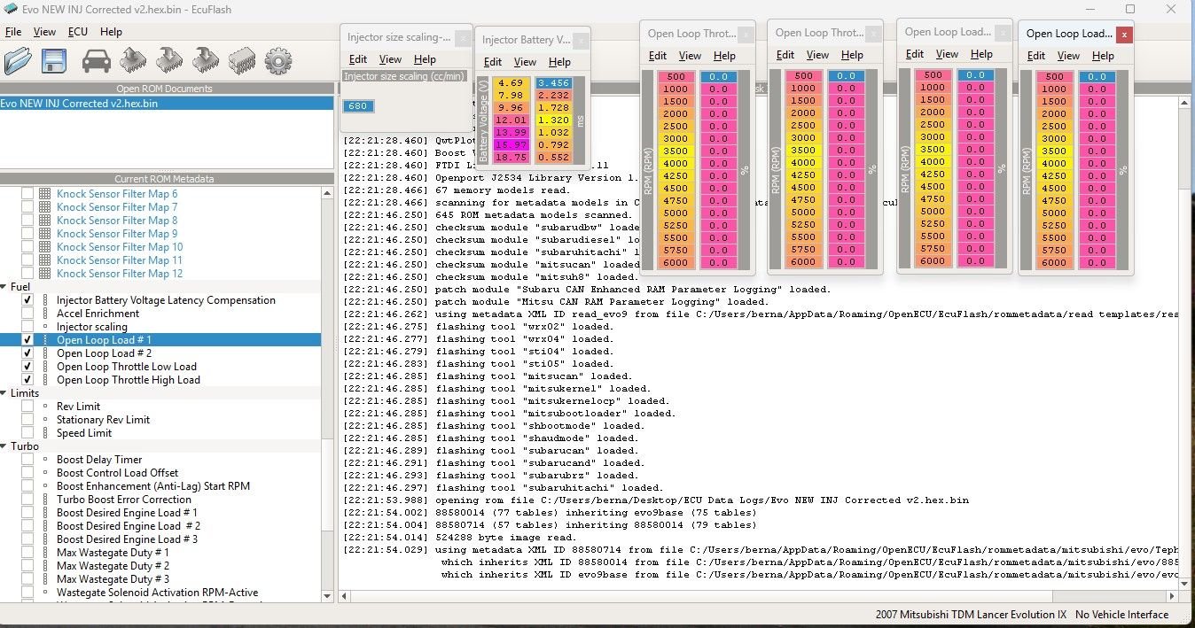

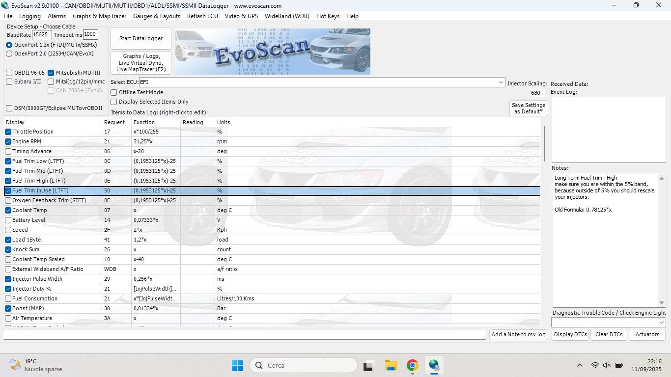

Originally Posted by KK0ng
post a screenshot of your evoscan
thanks for the reply and sorry for the delay,
this is evoscan and ecuflash
main page
main page
edit of LTFT
edit of LTFT
one quick log with values at 0
thus is the openloop
thus is the openloop "problem" with the actual scaling, it work, but i can't make adjustments without LTFT

LTFT sometimes doesn't populate until you actually drive the car for a short time (30 seconds or so)
for the logging in live tracer, you cannot have values set to Auto, you have to correctly define the values that match your tables from the dropdown menu, else you will get skewed data
but from my opinion you should only use LTFT to check the correction, and log AFR with a wideband and log the correction vs actual values to dial in scaling & overall base fuel calibration before moving to actual tuning

13.0 (should be 14.5-14.7) would definitely overcorrect, are you getting o2 readings ? log your STFT and set your openloop throttle to 75, and load should not be % but load based that matches the load calc and set those to 120 ish (just at boost )

So, i made some work and searched around...since i don't have the rear O2, was disabled in the FEA Bits...i activated this and the O2 simulation in Tephra Tab...set up the open/closed loop in FAA bits...but still nothing LTFT don't show up, nether the STFT

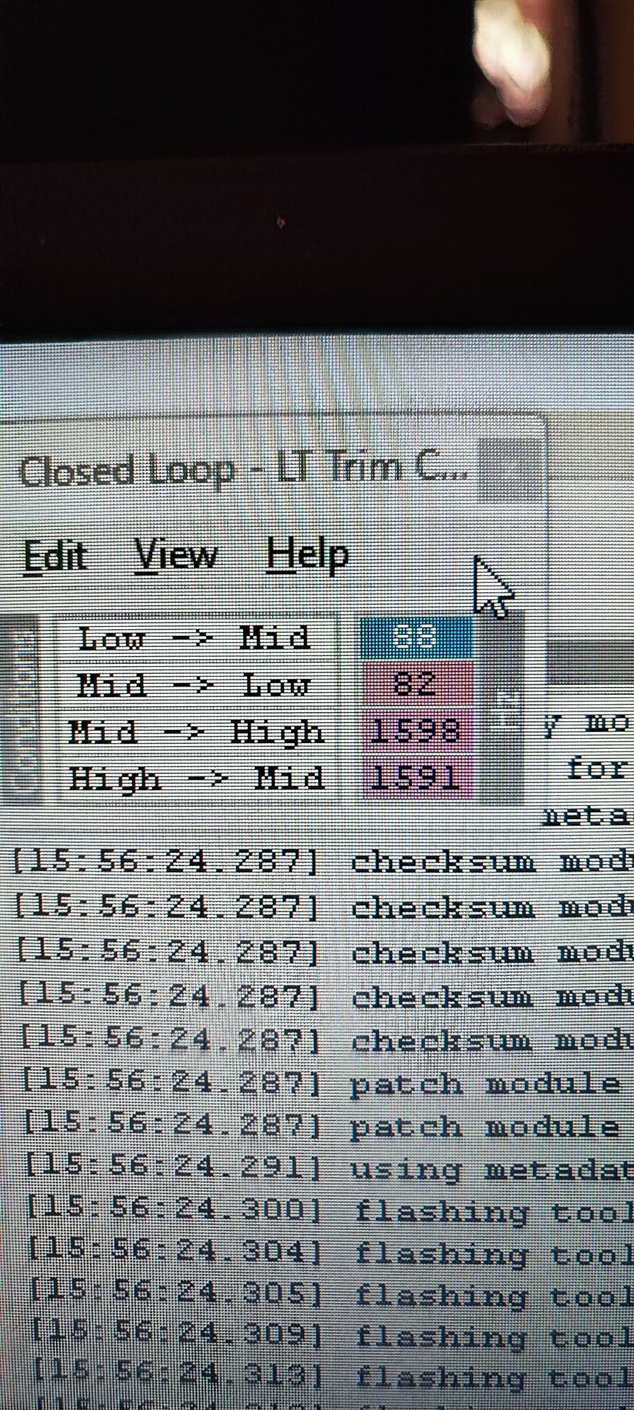

No at the moment, i need to eventually buy one...front O2 readings are shown...but now i saw something regarding the MAF Hz and LT...my values are 85 for low, and 1500 for high...and i think this can be the issue...my low Hz reading in idle Is around 35
Old Sep 15, 2025 | 07:05 AM
Luca Bernardi's Avatar
Joined: Apr 2021
Posts: 67
Likes: 9
From: Italy
Those are the actual parameters that i think prevent me to log LTFT
Old Sep 16, 2025 | 10:45 AM
KK0ng's Avatar
Joined: Aug 2015
Posts: 52
Likes: 23
From: the internet
seems high, mine are usually around for LT trim control
57
44
1598
1591
Old Sep 16, 2025 | 11:02 AM
Joined: Apr 2021
Posts: 67
Likes: 9
From: Italy
57
44
1598
1591
In fact this was the issue i think, i found some lower values on the forum and now everything is working properly, thanks to everybody, i will edit as solved
