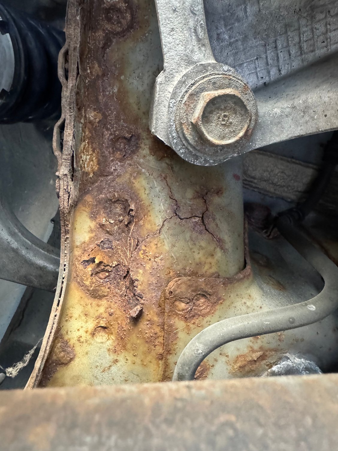

I recently got my car out of heated and temp controlled storage after a few years. While its been started regularly or needs a tune up. Anyhow, I got it on a lift and noticed the read frame.
How ****ed am I?
I feel like I need to get the car raised again and clean the debris to determine the situation, but I'm wondering if that's best left to a professional. I don't know how much damage I can do.
Should I go to a collision repair shop or should any body shop with a reputation be able to handle this?

Find someone who specializes in auto body unibody/chassis rust frame repair if you want the best work. I feel like this should be readily available in Chicago of all US cities.
Looks minor enough to have descaling and spray/paint on treatment.

Probably won't be cheap but it's totally salvable by a professional as already suggested, mine was in a similar situation.

Has anybody actually seenthese fail and cause the suspension or subframe to collapse?

It would have to be most severe. Take a look at the rear sidemember: https://www.4turbo.pl/sidemember-rea...,3,49895,52085
