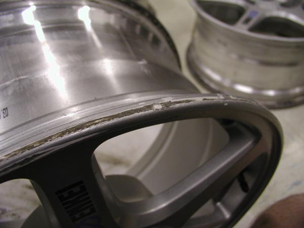

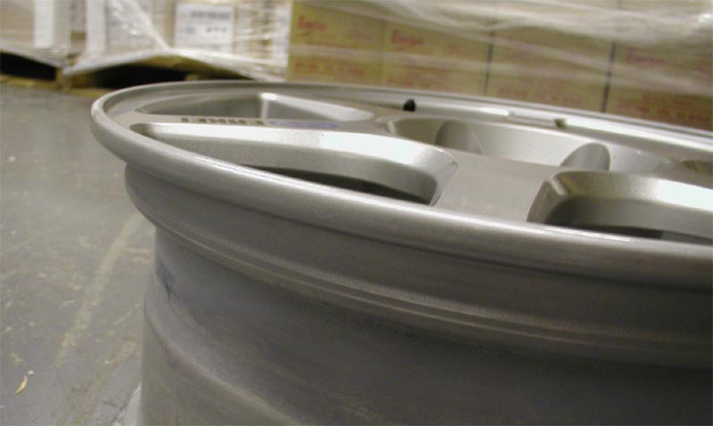

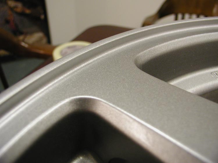

I finally found a perfect match for the stock wheels.
I first tried the computerized paint matching system at a local Dupont color mixer, they mixed a color that was shaded perfectly however did not contain the right amount or size of metal flake.
I then started thinking, and decided to compare, the silver touch up paint for my motorcycle. What are the odds but the match was perfect.
the first pic should be a before pic of the horrendous gouges put in my rims when I had my winter tires mounted.
Then the second 2 show the finished wheels. I only repainted the lip and feathered the color and clear in on the ½ inch or so flat section around the perimeter of the wheel.
The paint used was :
Suzuki metallic sonic silver, Suzuki color code YD8 color-rite color code 4915.
I used color-rites urethane touch up paint which I had laying around, and sprayed it with a hobby airbrush.
And remember when changing tires make sure you insist on a touchless tire changing machine, and stick on weights.

How deep were those scratches? They didn't look to bad, I have a curb scrape on one of my wheels that chunked some of the wheel metal down a little that I would love to see repaired like this

Ev8sive the majority of the scratches were through the paint without too much damage to the wheel underneath. I did have a curb scrape which I fixed at the same time using a file to smooth out the major scrapes, and was ready to fill the area with spot putty but didn't feel putty was necessary. If you do try to fix it, have some putty ready, and make sure you use a primer that bonds well with aluminum.
There are a few places where you can see ripples in the paint along the outer lip that were caused by removed aluminum, the second pic above has these ripples in it, but you wont be able to see them with the tire mounted, so I didn't go crazy trying to smooth them out perfect.
