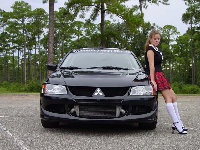

90GSX-03EVO's Avatar
iTrader: (27)
Joined: Jul 2003
Posts: 2,217
From: Virginia
Originally Posted by g6civcx
14. Lane discipline is something we Americans lack. Drive on right. Pass on left. It's that simple!
The reason for my windshield banner.....
