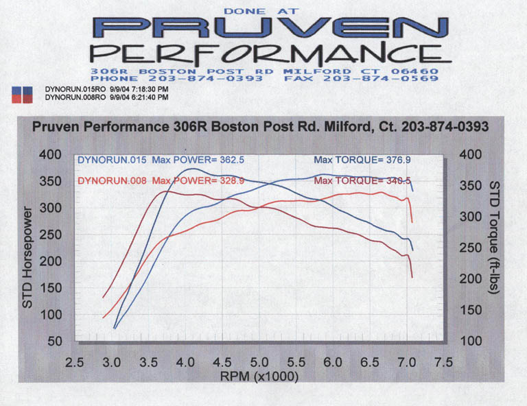

I know that there have been a lot of threads recently about Al and DynoFlash, and my car was part of the contreversial dyno day at Pruven last Saturday. Let me put the issue to rest. Here is the truth about what happened with my car- at the dyno day and today.
At the dyno day, my car was making very low numbers on the dyno. My previous DynoFlash setup had resulted in 297 whp, 315 torque. I added cams and a test pipe so I needed a retune. After a few pulls and some tuning on the dyno, it was only making 303 whp on pump gas. Obviously something was wrong. Al wanted to see if the stock bov was leaking or the cheap mbc I had on there wasn't working right, so race gas was added and the boost was turned up to 25 psi. The car again made no power- something was obviusly wrong.
At this point my car was taken off the dyno for some diagnostic testing. The techs at Pruven found a boost leak and fixed it. However, I was told by Dan at Pruven and Al that there was something else wrong with my car. Al then gave me the option of coming back at a later date for a free reflash.
To tell the truth, I was pissed when I left Pruven. I thought that since the boost leak was fixed, Al was just making up excuses to keep me off the dyno so that other customers could be tuned. He told me the stock bov was leaking, the mbc I had on was junk, and that maybe the cams I had just had installed where put in wrong. It all sounded like BS, but it turns out that Al knew what he was talking about.
Fast forward a few days. I talked to Al about having my car tuned sometime this week so that it would be ready for the big race Saturday. He said that in the state my car was in, it wouldn't run right, so he reccomended some parts. He told me to get a bov, a better mbc, and the HKS RS intake. I figured that I would give Al this one last chance to fix my car, and I would get the parts he reccomended.
So today I rolled into Pruven with a new bov and the HKS RS intake. I had a Hallman mbc swapped in when I was there and the car rolled onto the dyno. The first pull (baseline, no tuning on pump gas) was 329 whp 340 torque! Al quickly started on the race gas map. In no time, the numbers shot over 350 whp and 370 torque. For the last pull, Al invited me into the dyno pit to actually perform the dyno myself. This was to prove that there was no way Pruven or Al were messing with the numbers. I ran the car through the dyno, pushed all the buttons, and even printed out the dyno sheet. The end result: 363 whp 377 torque!
I know that Al can seem rude at times, or can even **** you off when he tells you that the parts YOU spent time carefully choosing by doing research on this site suck, but it turns out he is right. Al knows what these cars like and which combinations of parts work best. I came into Pruven on the dyno day with a combination of parts that should have worked well- but they didn't. With Al's advice and his tuning expertise, now my car is making numbers that are unheard of with nothing short of an AEM. I have a stock block, stock intercooler, stock IC pipes, and stock injectors, but we were still able to make a ton of power safely with the DynoFlash. The dyno sheets should speak for themselves.
