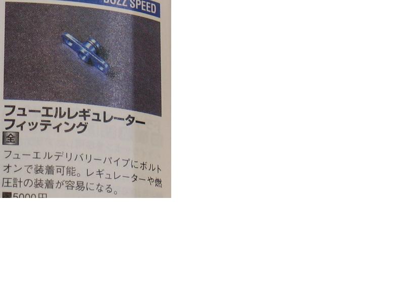

i saw a fitting on the hyper rev n don't know if it's for fuel pressure, i will post u the pic later n see u had any idea. btw, how's the perrin fuel rail, does it make any different? i was thinking not to bother it before i do any power upgrade.

i just got a reply from japan, they said this adapter is for the fuel regulator, and they said to install a fuel pressure sensor can be rubber hose to the fuel rail then put a 3way adaptor to fit a sensor, and they have that 3way adaptor for 3000yen, no picture though...
