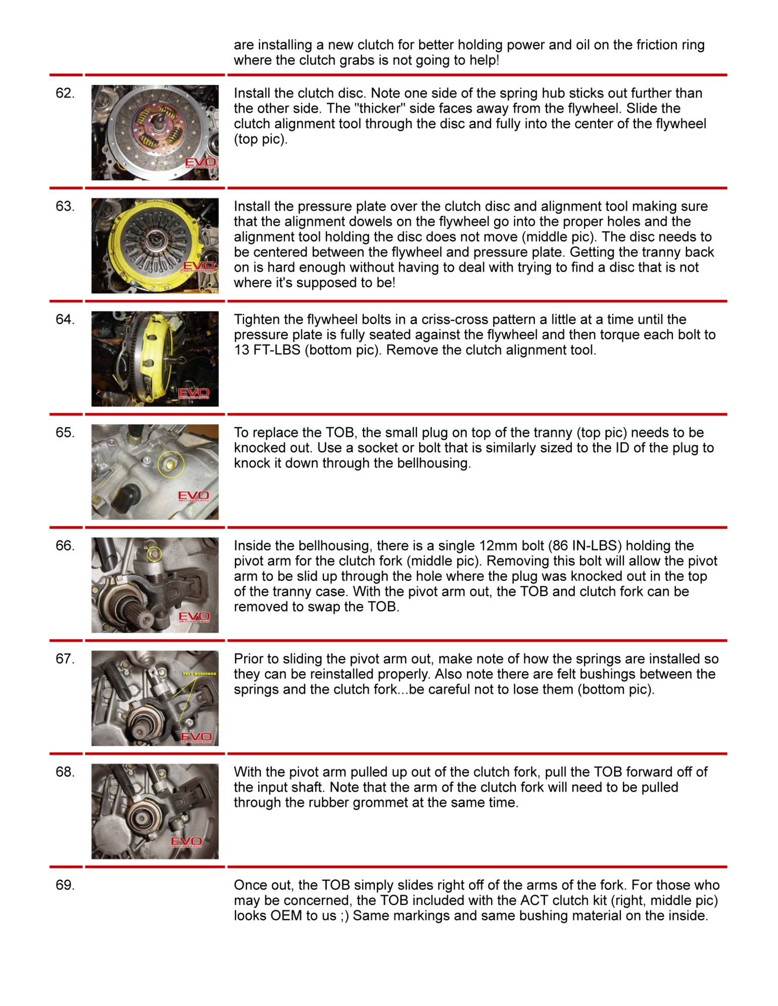

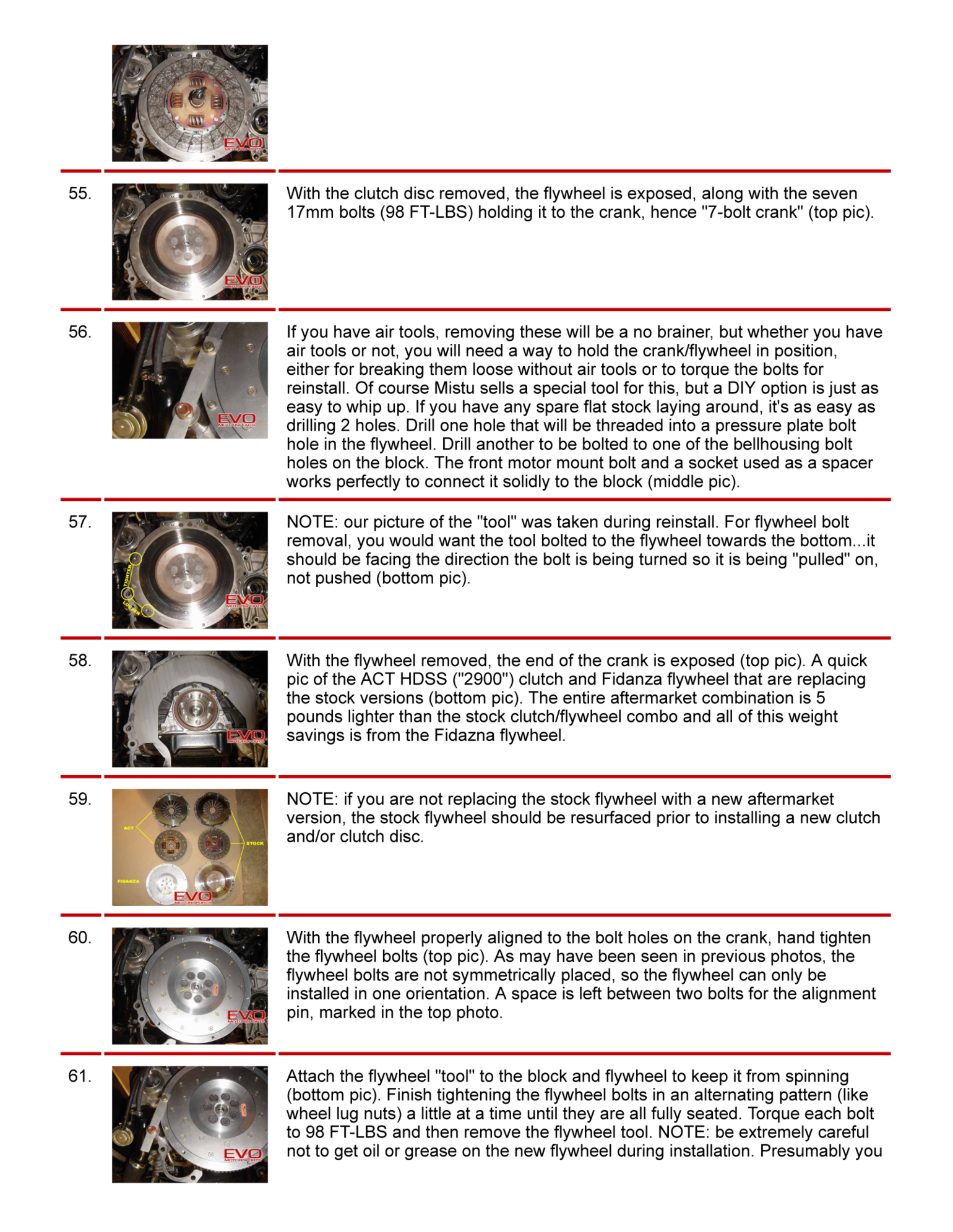

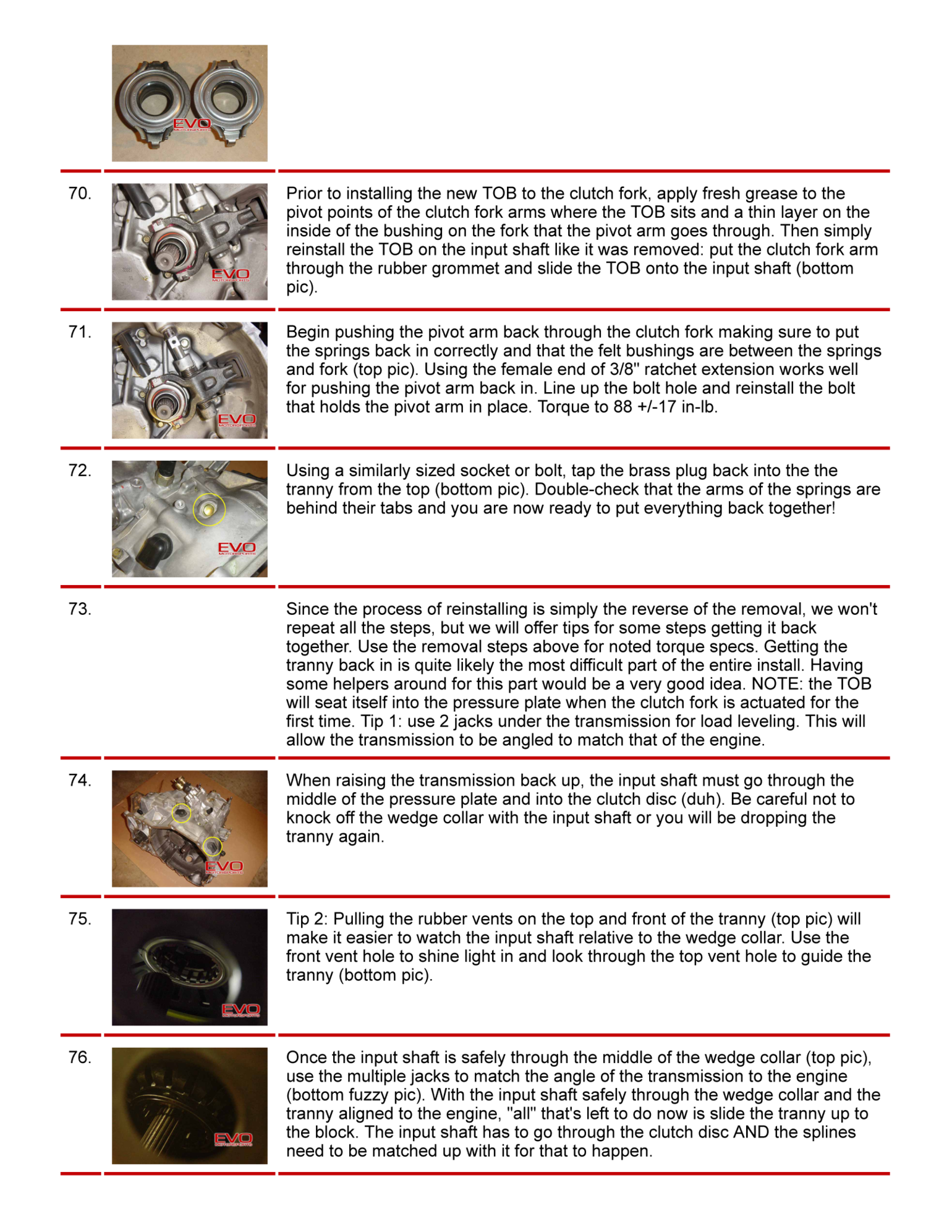

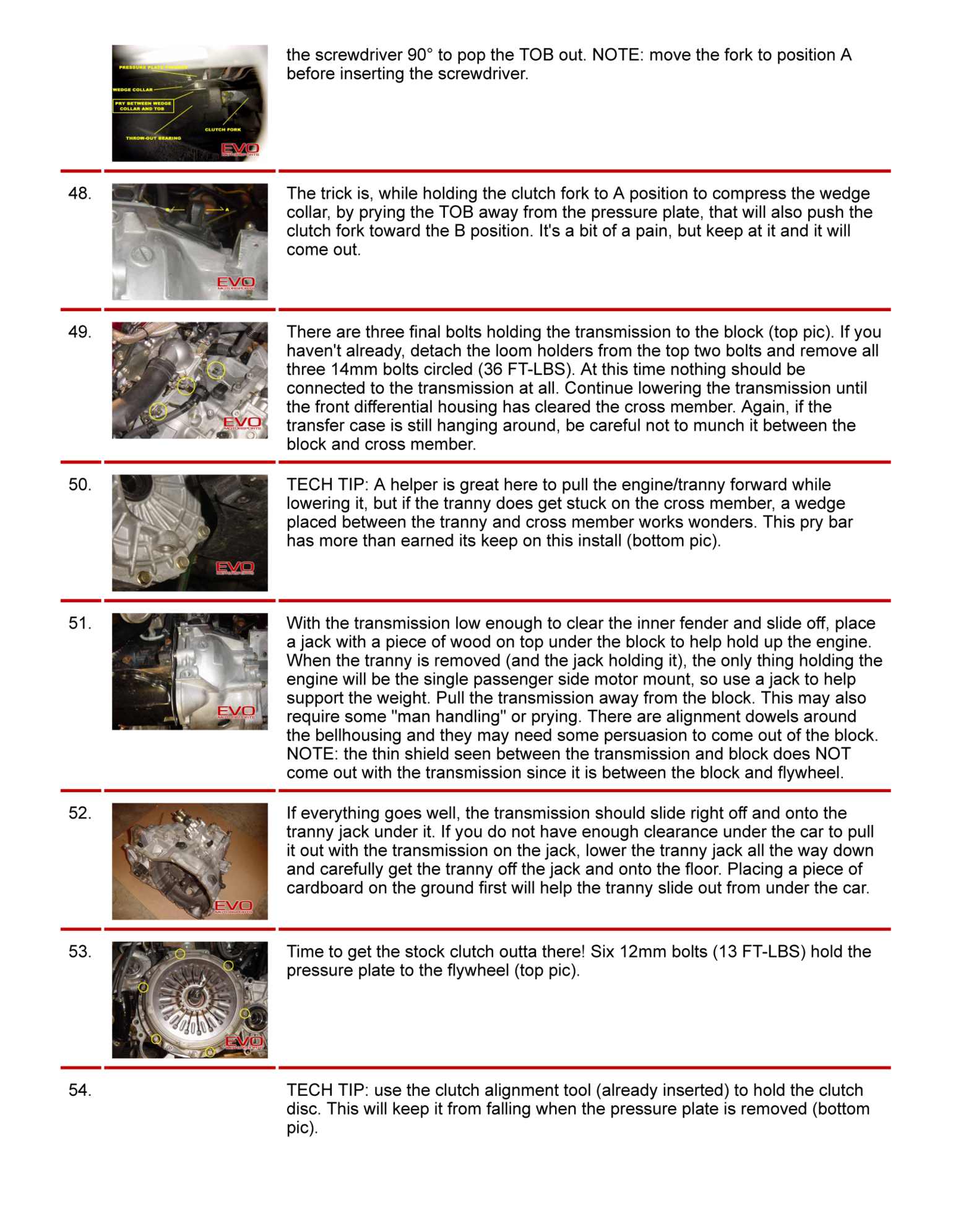

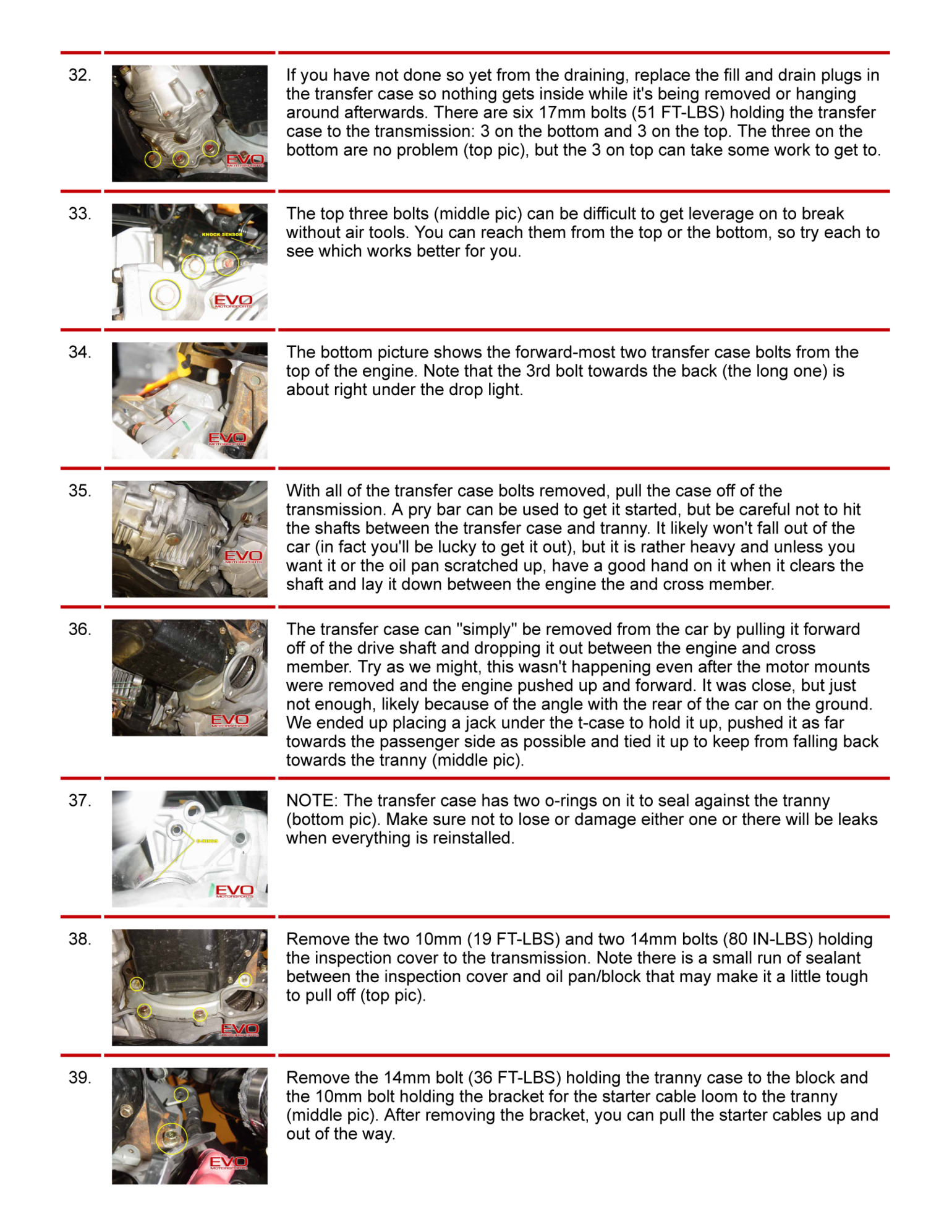

No!!! EvoMoto has closed down their website?! Well, I had been referring to this clutch & flywheel guide a lot.

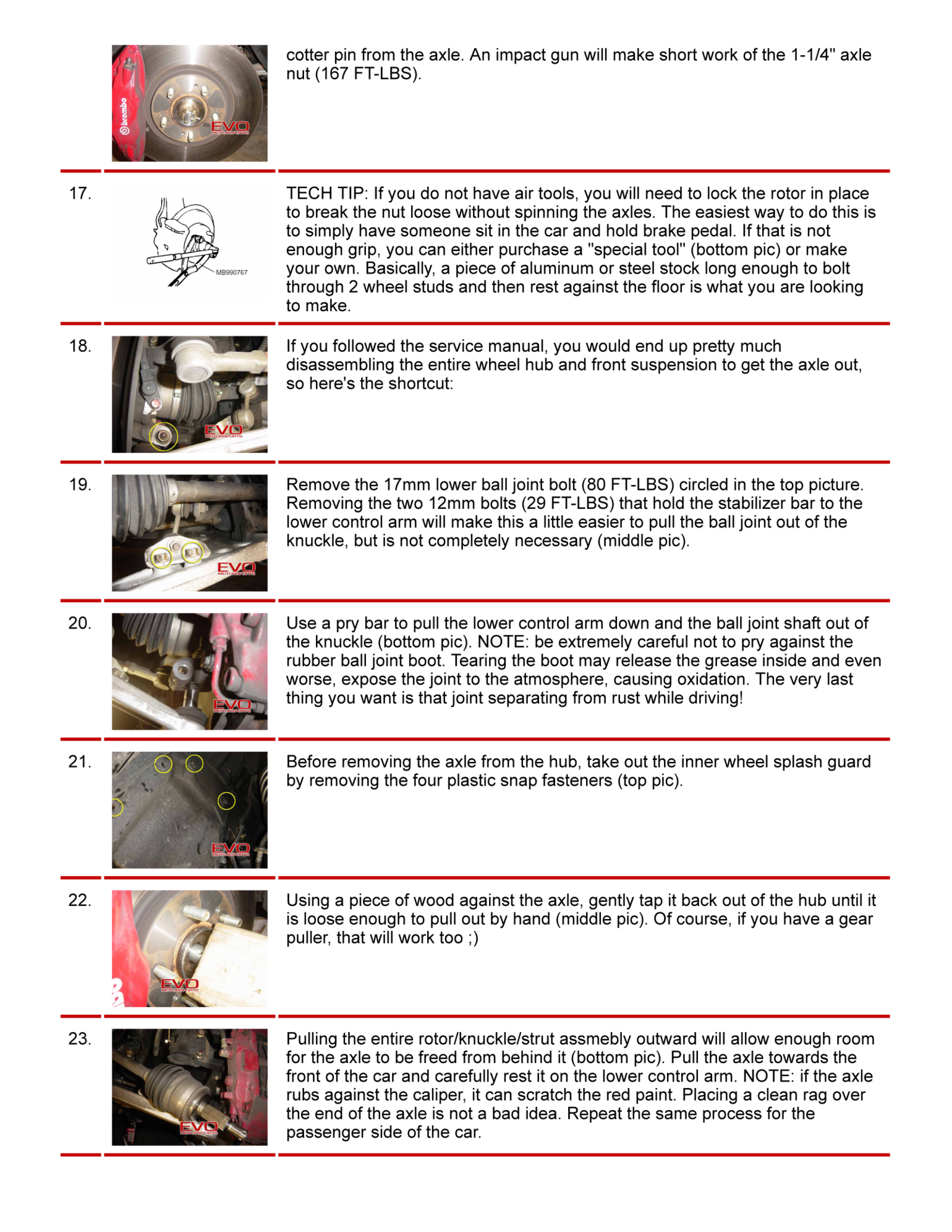

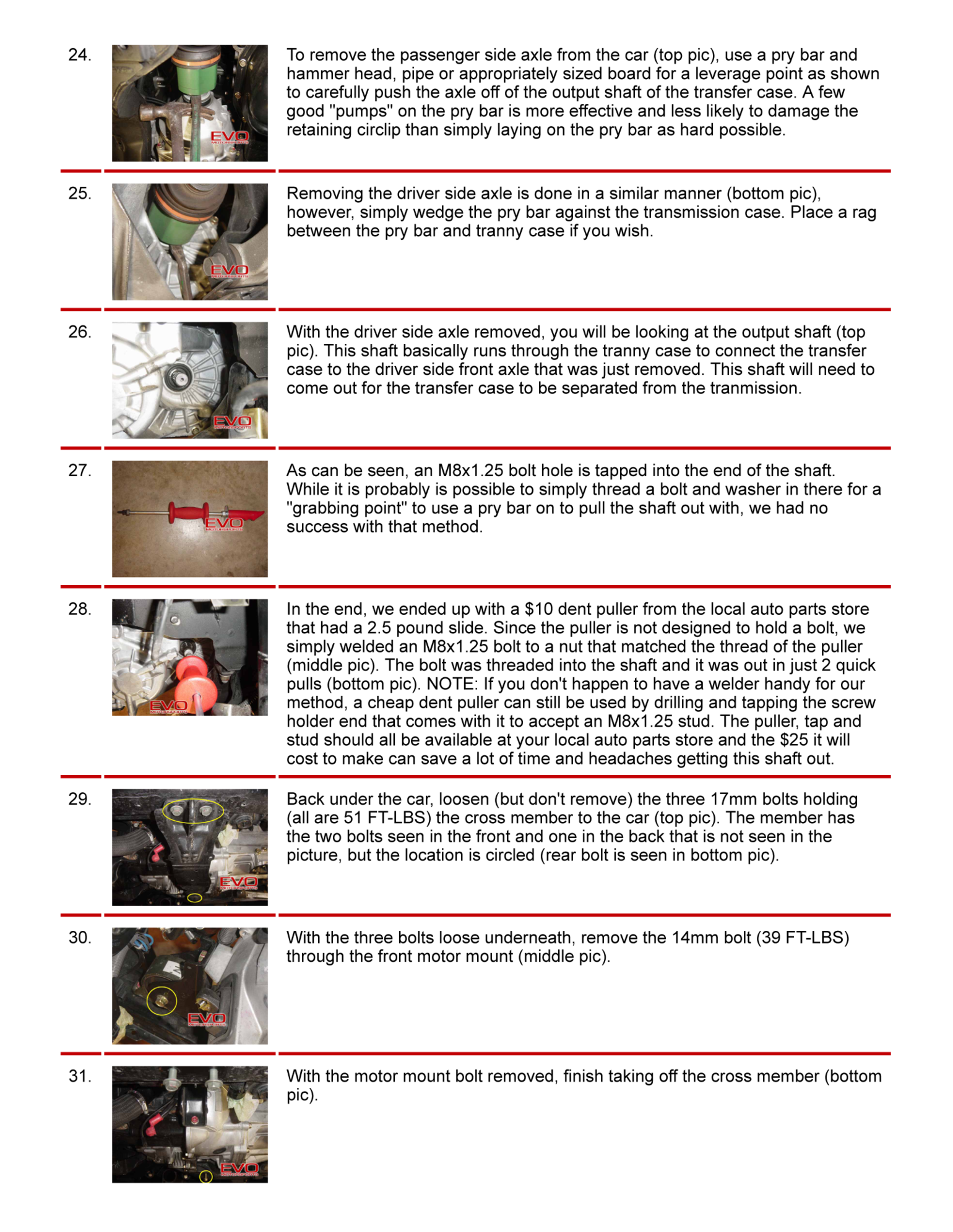

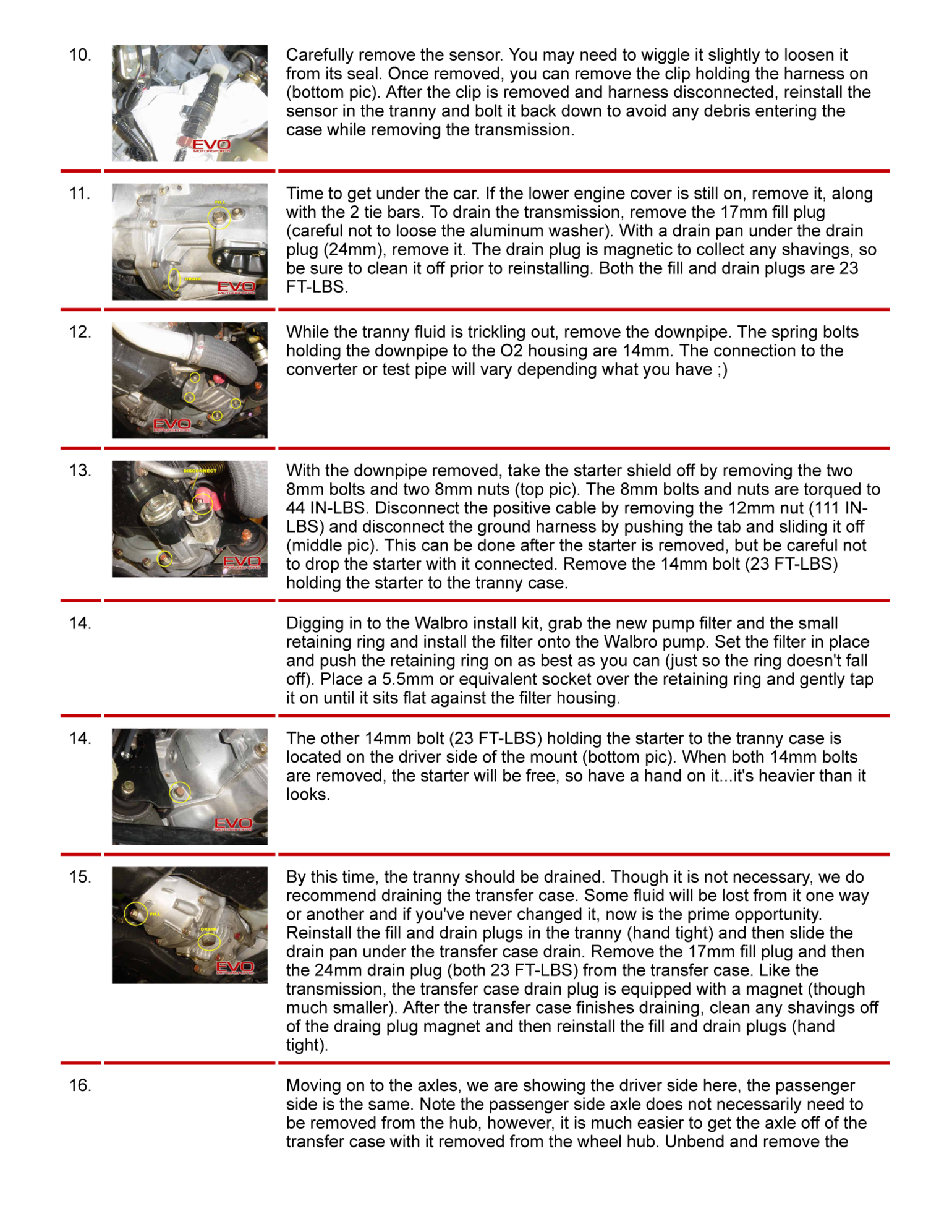

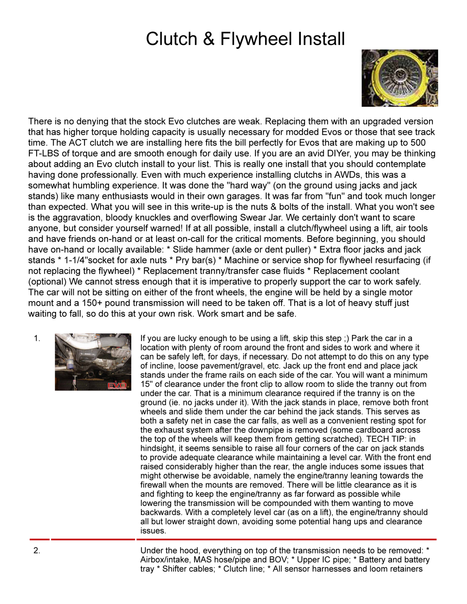

However, you know what, praise the Machine God, in 2023 I saved a pdf copy of the EvoMoto guide. I can share this to EvolutionM, so our Evo owners can still have access to this godsent installation instruction:
Step 1 ~ Step 2
^Step 1 ~ Step 2
Step 3 ~ Step 9
^Step 3 ~ Step 9
Step 10 ~ Step 16
^Step 10 ~ Step 16
Step 17 ~ Step 23
^Step 17 ~ Step 23
^Step 24 ~ Step 31
^Step 24 ~ Step 31
^Step 32 ~ Step 39
^Step 32 ~ Step 39
^Step 40 ~ Step 47
^Step 40 ~ Step 47
^Step 48 ~ Step 54
^Step 48 ~ Step 54
^Step 55 ~ Step 61
^Step 55 ~ Step 61
^Step 62 ~ Step 69
^Step 62 ~ Step 69
^Step 70 ~ Step 76
^Step 70 ~ Step 76
^Step 77 ~ Step 79
^Step 77 ~ Step 79
That's the guide! Kindly reply if you have any comments or inputs.

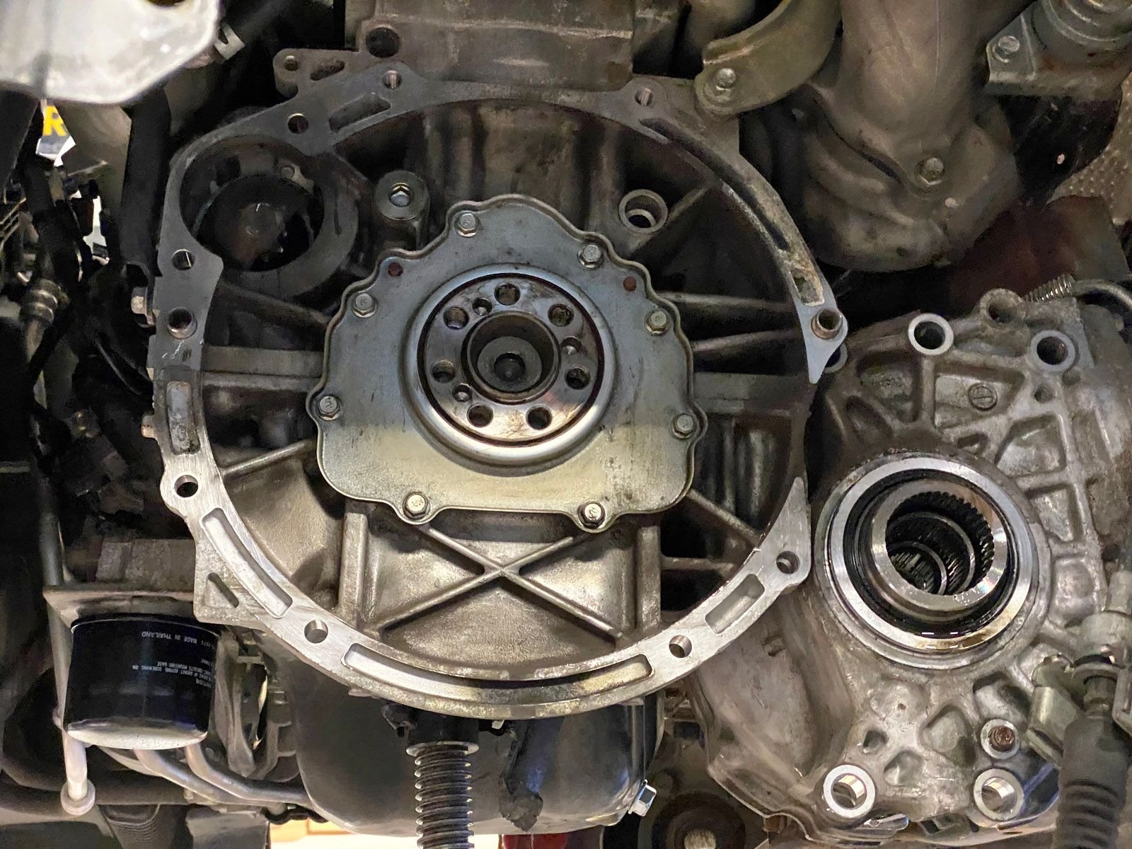

My Evo X is getting its OEM clutch replaced (by an Exedy OEM clutch kit). The Evo X's transmission design is so very different from that of the Evo 8 and 9, and the EvoMoto guide here certainly does not apply to Evo X.
Mitsubishi Evo X transmission, clutch, and flywheel removed.
^My Evo X with its transmission, clutch, and flywheel removed for clutch replacement service.
