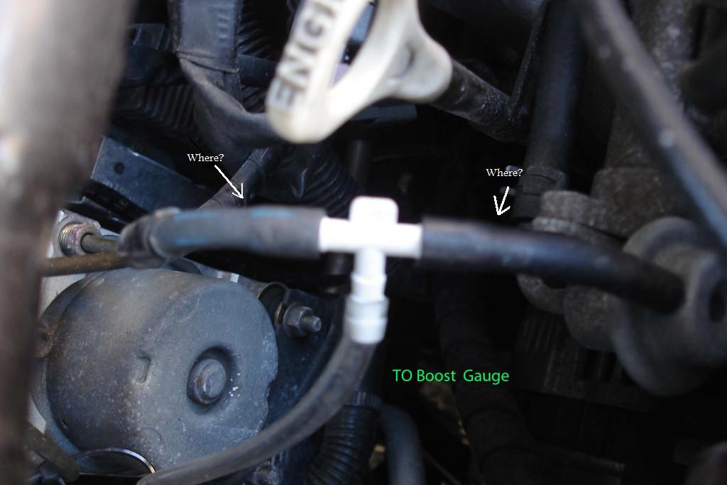

OK I got that, just 2 more questions. the first is where does the t'd hose goes too? I've copied and marked on your picture so you could know what Im talking about. Also you wont happened to have a pic of your old solenoid? so I could see what how you capped it off? Thanks

That line is already there. look for the blue lines on the hose.
Its on the back of the fuel pressure regulator.
Left side if your facing the car near the dip stick.
