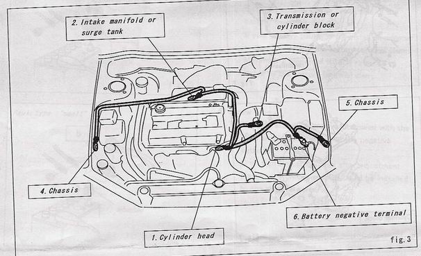

i did not ground the tranny
why would you?
1. i have wire running to body right beside the air box and in fornt of the fuse box. I also removed the paint between the other grounds and the body
2. i have a wire running to the firewall were the strut bar connects. I used the driver's side bolt. From the bolt i ran a wire down to the intake manifold were there is an existing ground. This is a small ***** wire.
3. i have a wire running to the back hoist eyelet connected to the block. From that i ran a wire to the top mounting bolt of the alternator. You can loosen this bolt without taking hte belt of and dont worry about the alternator moving.
4. (I just did it for the hell of it) i ran a wire to the left side were the strut bar is bolted to the strut
Also on the number 3 wire i ran a wire from the back hoist eyelet to the front one.
i noticed a big difference in the idle paticularly with the a/c on
it also pulls a lot harder throughout the revs
i am very happy with mine!

do you have any pics of the extra wire coming off of number 3

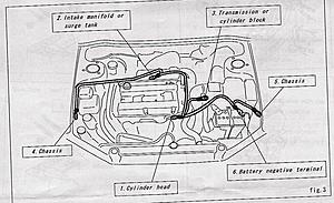

wire routing
This pic is one of reasons I ran to the Tranny..

once i find my digital camera ill take a picture of the extra wire coming off three
but i dont see any point of grounding the tranny
Old Jul 15, 2003 | 09:51 PM
bpclements's Avatar
iTrader: (41)
Posts: 960
From: Oceanside, CA
Well I guess as along as you ground some where on the block you will be good since all of that stuff is bolted pretty tight. Hey, the more the better right. It was easy for me to do so I did it.
