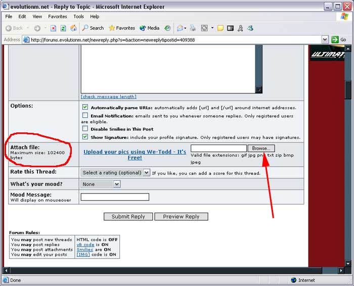

You need to ground specific locations: cylinder head, tranny, intake manifold, and chassis to the negative battery post. How can we attach images anywayz? I can show you my set-up.

Here's a pic to show you how to attach a pic. You'd have to post a reply for each pic though, since they only allow one pic at a time.
