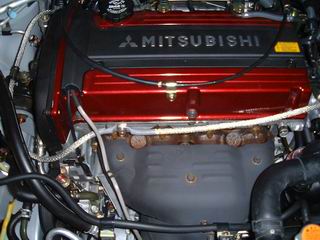

Originally posted by Karash
What is the best way to work the bolt on the back of the head (tranny to head connection). Seems like there is little or no room to do anything with back there. Can we bolt it on top of the block for the same effect or no?
How about using the front of the head instead? like in this Lineage Grounding kit install?
I wouldn't recommend doing that because the heat at that area might be hot enough to melt the wire cover.
Old Oct 23, 2003 | 10:37 AM
  #118
Karash's Avatar
Posts: 1,274
From: Okie in PHX
yea the heat issue I think would come into play. Those headers might melt the wire... (?)
Old Oct 23, 2003 | 04:08 PM
  #119
SinCityEvo's Avatar
Posts: 898
Yes, it WILL melt the wire cover. I had it there and took a drive and it was on the verge of melting. What I did is use the back one, but instead of using the hole on the block which is hard to get to, buy a bolt and nut and attach it to the rear engine hoist bracket like front one you removed. There's a hole that's a perfect size for attaching the wire on. It as much easier to wrench it tight and it stays cooler back there.
Old Oct 23, 2003 | 04:35 PM
  #120
jemm's Avatar
Joined: May 2002
Posts: 719
From: Jamaica.
I thought this was a bad place to put it.. but have seen a few installs with it, was just wondering about their outcomes with that location.
SinCity : good tip.
I will be building and installing mine this weekend.
