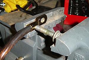

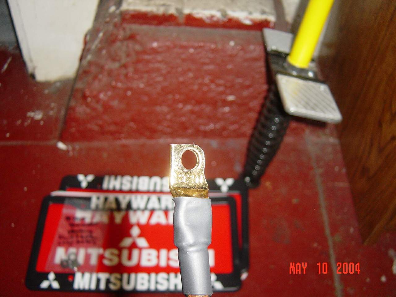

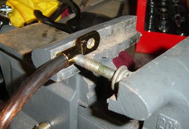

Yep, I just did mine 300 miles ago and my car definitely feels smoother at idle, especially w/ the AC on. The low end/off-boost power and throttle response was noticeably better. WOT felt about the same, maybe gained 1-2hp. It was definitely well worth the $45 and 4 hours I put into this project. I like how my black ground wires just blends into the background in the engine bay. It looks really stealth.
I used the bling bling gold plated Monster ring terminals w/ black 4 gauge wire. Crimping the connectors onto the wires were somewhat tricky since I didn't have that large of a wire stripper and crimper. I ended up using a razor blade to strip the wire, and a bolt in a vise to crimp the connector.
I also had to take my die grinder and grind down my big fat ring terminals mounting to the battery to get it to mount flush.
