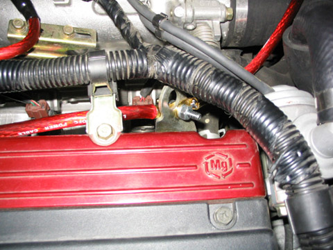

I did not use the bolt on the back of the head as it was too hard to get to, Instead I bolted it on to the rear engine hoist, which is itself connected to the head. I did not ground the tranny.
