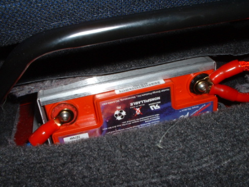

Odyssey 680 install pics
Got the idea from another member. check it out.

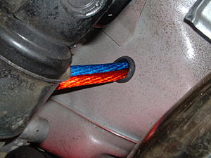

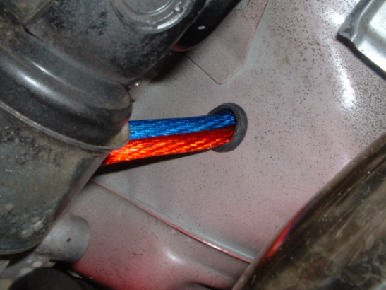

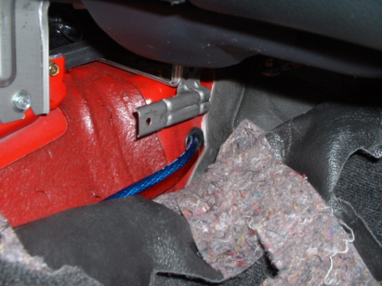

pass through gromet in front of tunnel
Old Nov 2, 2003 | 12:56 PM
bishiboy's Avatar
Joined: Jan 2003
Posts: 942
From: Yuma AZ

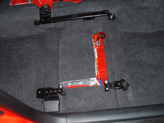

underside

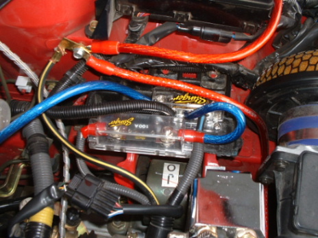

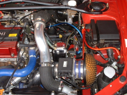

enginebay
Old Nov 2, 2003 | 12:58 PM
bishiboy's Avatar
Joined: Jan 2003
Posts: 942
From: Yuma AZ
connections

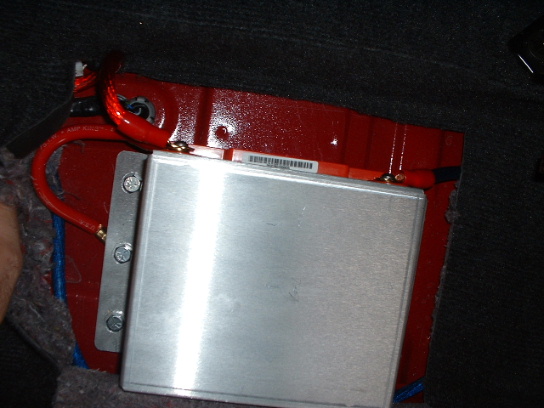

box (kinda dark)

Very nice
But now the battery is under the seat, is it really hard to get to it when you need a jump start?

Really nice. I want to do the same thing. Where can I get the box and all other necessary parts?

ReHeat:
I have the connections where the battery used to be. I can jump start it by taking the plastic cover off the power distribution block and hooking the Pos there, then ground the Neg to any ground point, (fire wall, engine, etc..)
Mojo:
I got the battery and box from this Ebay seller. ($93 shipped for both) http://cgi.ebay.com/ebaymotors/ws/eB...category=34284
I bought the wire, connectors, power distro block, 100A fuse at a local car stereo shop.
If any body is interested in a detailed shopping list and "how to" PM me.
PS. I've been driving on it for a little over a week. No problem. The Odyssey has a 3 year replacment waranty if used in automotive applications. This battery is designed for Harleys and BMWs but is advetised to be used in cars. 280CCA.

...It's also easy to disconect the battery under the seat with an allen wrench.
