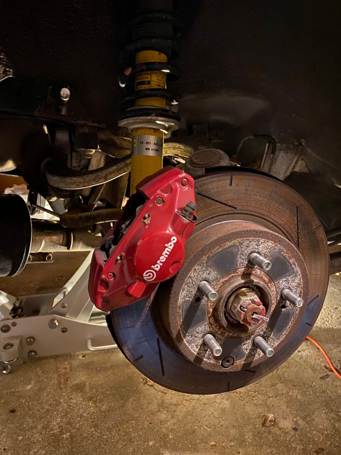

What is the best way to remove the rear subframe and suspension all in one piece?
I am trying to do some undercoating and want space to work.
Picture for attention:

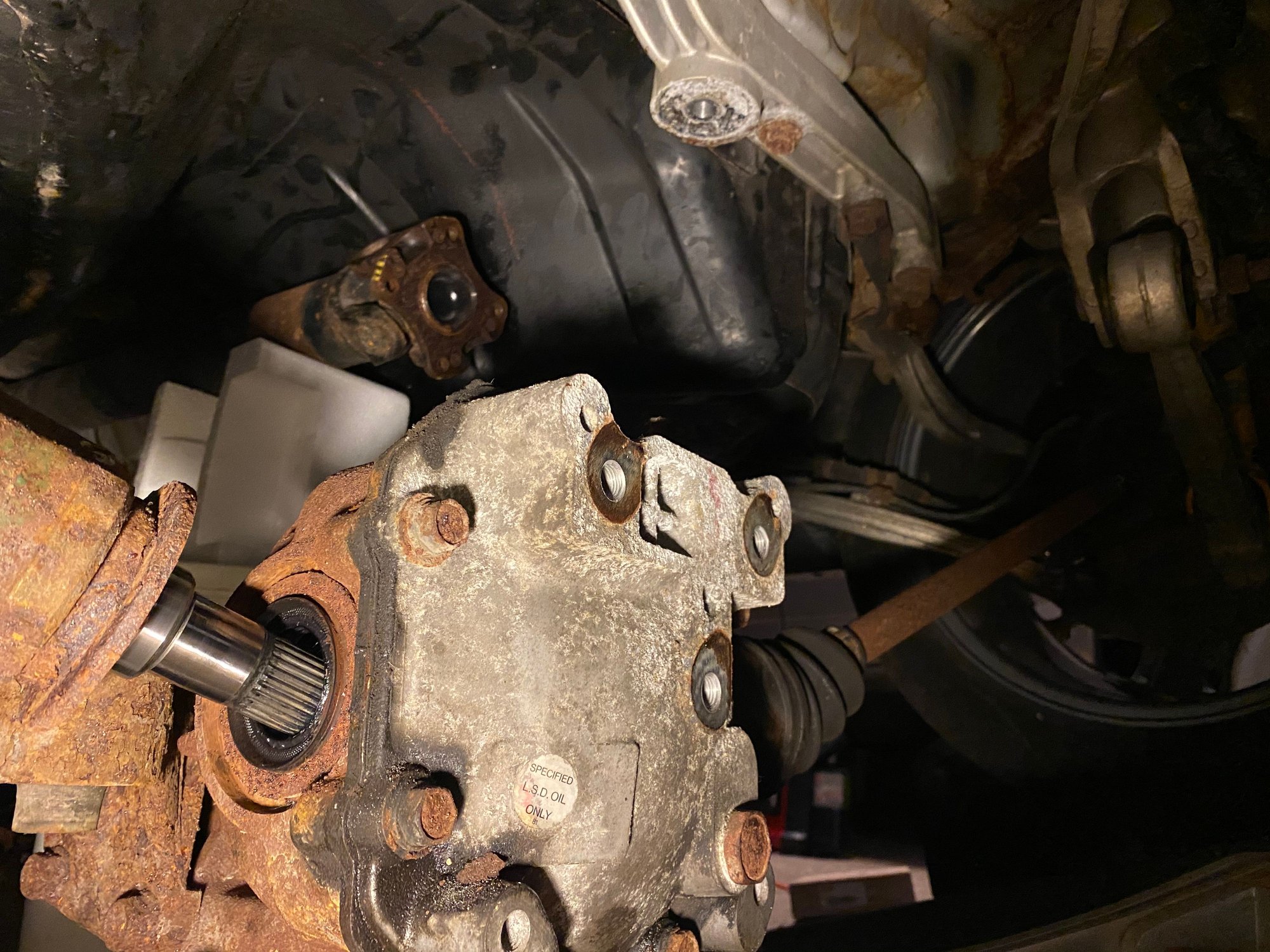

I decided to start with removing the rear diff (via the sway bar end link method). That frees up some space (also weight) to access the rear subframe. Then I think I’m going to detach all the suspension arms where they mount to the car. Then drop the subframe.
any more pictures? Do the axles just pop out? Doesn't look like there are any bolts holding that on :S
