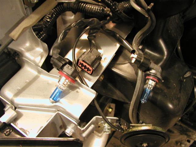

You'll need to remove the fog and high beam bulb (turn counter clockwise). Unplug the headlight harness (below and between the fog and high bulbs). You'll need to grasp the release buttons which are on top and bottom of the harness. *NOTE: Be careful not to touch the bulbs!!!

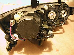

Now looking at the back of the headlight assembly, unscrew the only screw and turn cover counter clockwise.

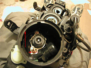

Turn plug CC

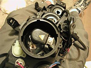

Push retaining ping down and out. After it releases, you can swing it open. You can just pull the bulb out. *NOTE: DON'T TOUCH THE BULB!!!

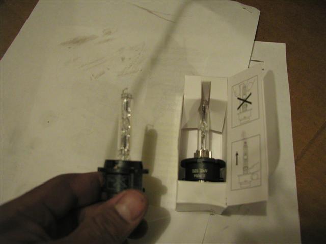

Compare old with the new in box. Make sure you don't accidently use this 'old' bulb for the passenger headlamp.
