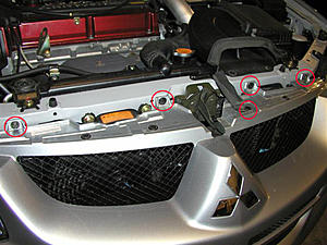

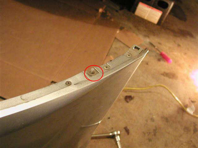

Remove 2 bolts and 3 clips on top of the front bumper

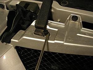

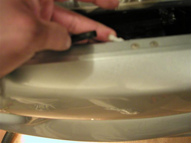

Remove the non-marked clips by prying with flat head screw driver. Pop up 1/4" and you will be able to pull the entire clip out.

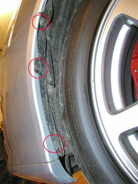

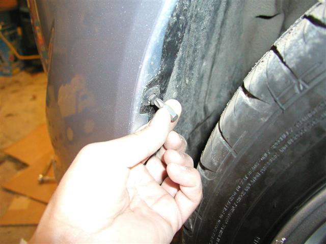

Under each wheel well, remove 1 bolt and 2 philip head clips.

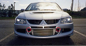

Now unscrew the two bolts holding the intercooler screen.

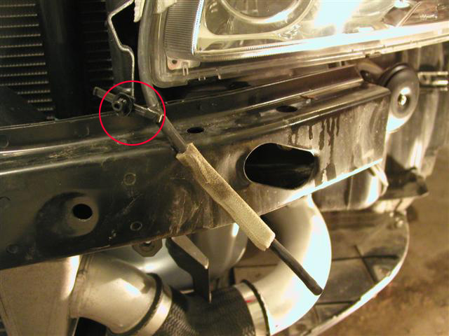

You'll have to disconnect the intercooler spray tubing. Near the driver side headlamp on the bumper, you can disconnect the tubing from a white coupling.

With the bumper slight pulled forward, get underneath the vehicle to reach and pop off a clip holder for the tubing. You will need a long skinny fork like tool to rock the clip loose.

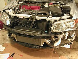

Old Mar 1, 2004 | 09:52 PM
kdogg's Avatar
Posts: 1,014
From: NW PA
Starting with the driver side headlamp....
Remove the clip on the inside of the headlamp. This will allow you access to one bolt. Unscrew the two top bolts. Remove the forward most bolt near the wheel. (4 bolts total)
Attached Thumbnails How remove bumper and install HID bulbs!-step901-small-.jpg
