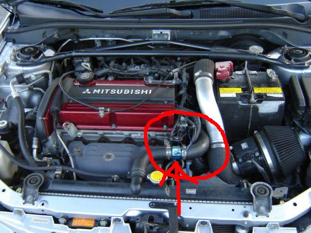

Did a search could find anything on the install....bought em used so I have no instructions either.....Help!

i saw a guy drill his thermostat housing and put the sensor there, seemed kinda dinky to me

Here is a link to a t-stat housing with a bung welded in it. These guys also have just about any fitting you'll need. This is what I plan on doing.
http://store.42draftdesigns.com/Lanc...or_p_6-56.html

Oh god no drilling. Defi says to cut the upper radiator hose, install a T fitting, and clamp off, then install the sensor into the T fitting!!!! If you have defi gauges I have the instructions, and I just posted a pic of this same thing on another thread in the last 20 minutes. Search for that one.

Picture of a upper inline sensor.
I've been looking for one of those.. that can handle a mechanical water temp gauge.. where did u get that ? ? ? ? ? ?

I actually sell them. But I can't really go into specifics, since I am not a vendor here.
