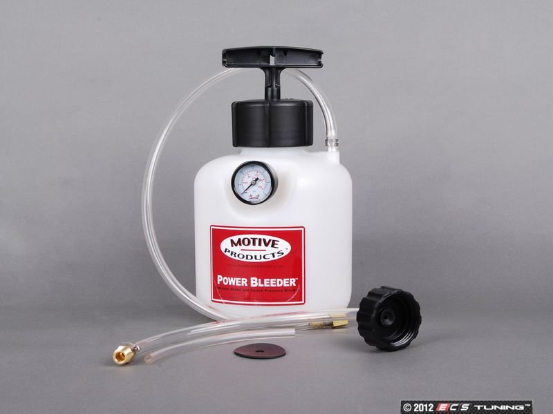

Originally Posted by barneyb
I like this reverse bleeding idea. What did you use to do it?
Pressure bleeder FTW.
Old Feb 4, 2018 | 09:12 AM
gpdriver's Avatar
Joined: Sep 2011
Posts: 15
From: Va
Power bleeders are the best.
