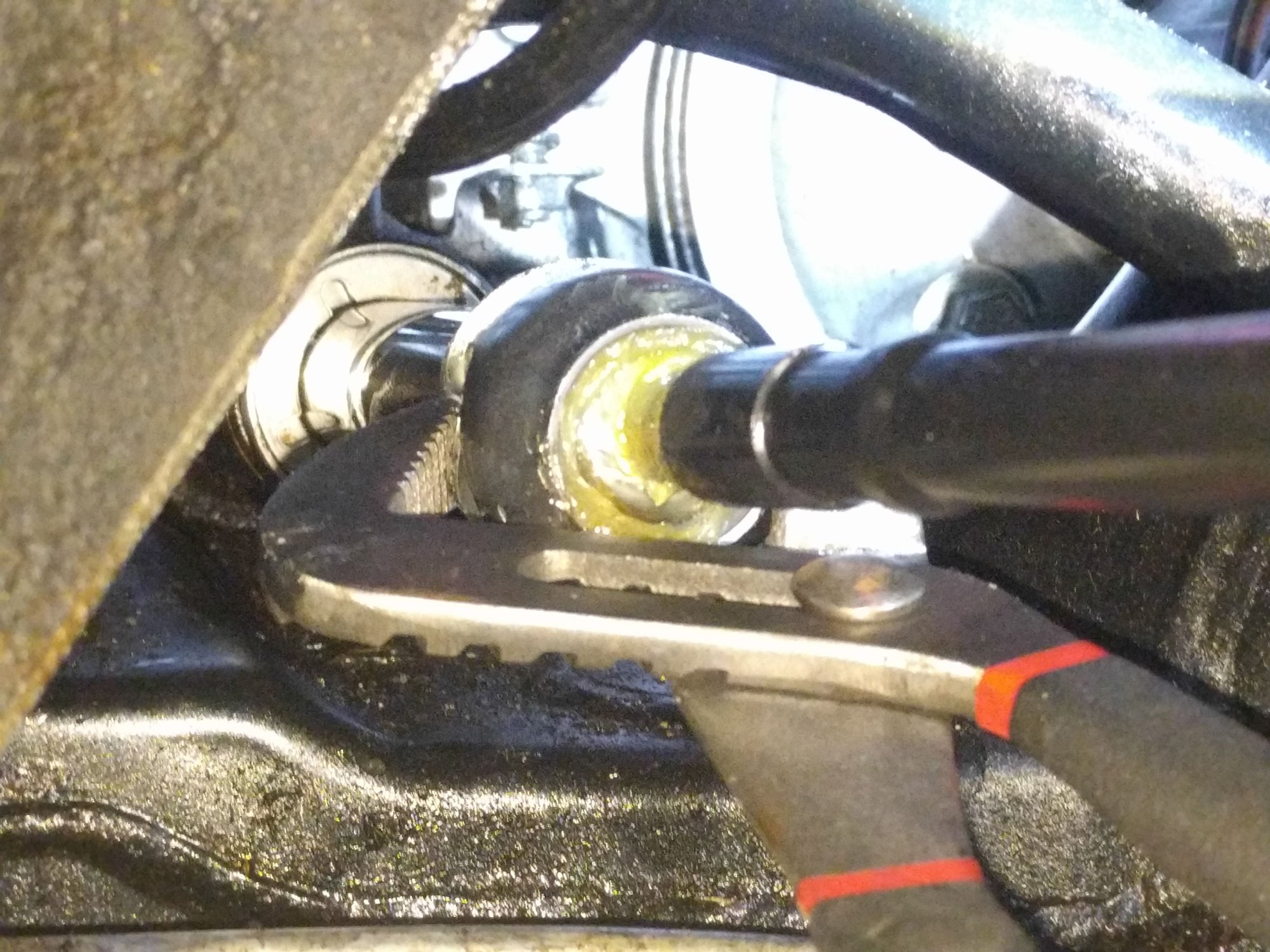

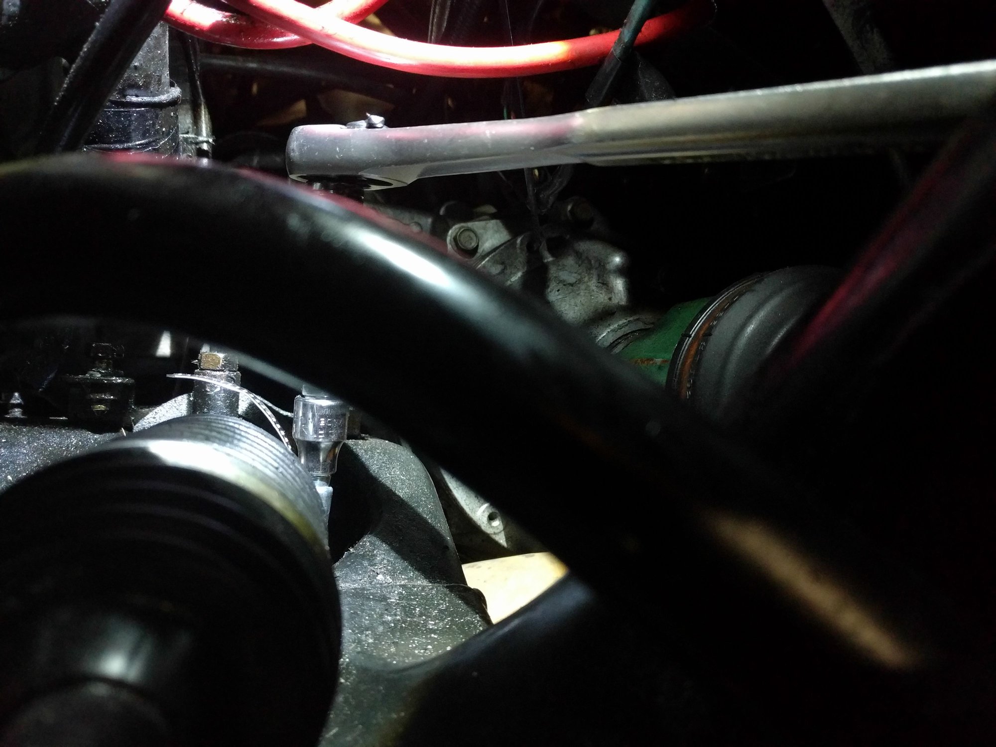

I did this today and ended up getting the metal strap off the boot from the top behind the intake manifold with a pipe wrench. I wasnt able to get the metal strap off completely, what I did was push it off of the boot toward the rack so it wasnt squeezing the boot down. Then with the tie rod end off the tie rod pulled the boot off.
I then used the same pipe wrench to crimp the lock washer.
I also used a hose clamp to tighten the boot down to the rack. Which made it much easier to work on. A regular 3/8 ratchet had plenty of room to move around down there.
