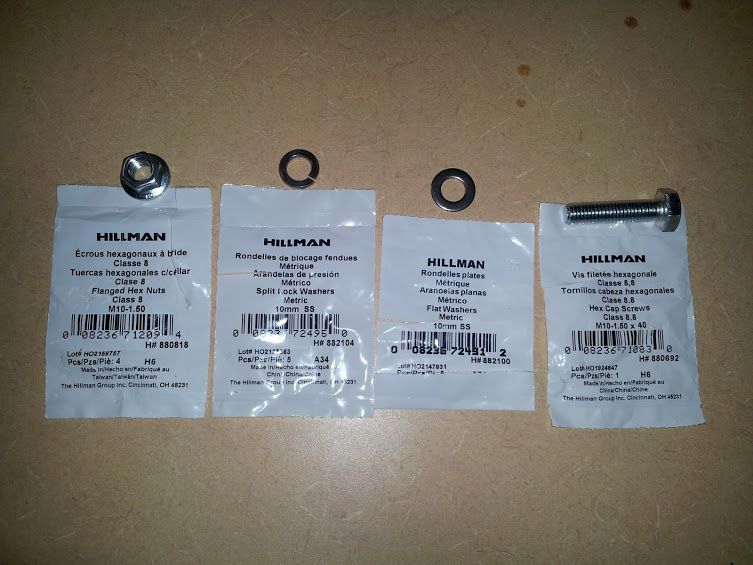

The hardware I used.

Attached using said hardware. My advice would be to use a washer that has more diameter so that the bolt is able to hold onto the caliper across a greater surface area rather than what is right under it. I will be changing mine out this weekend.

Anthony, the hardware was what I proposed when I first started. The bolt is a 40mm bolt in length and truly looking at it now I needed a 45mm bolt to allow myself to run a lock washer on the hardware setup. But instead I installed only the bolt, washer, and nut.
The nut is for the other side of the mounting ear on the hub. The bolt goes through the caliper mounting ear with the washer attached so that there is a flat non wavering surface for the bolt to seat upon. The bolt should protrude then through the mounting ear on the hub if you elongated the caliper mounting holes enough and then the nut is installed. So looking directly at the caliper (as if you were looking down the middle of the rotor looking into the vanes) the hardware would be installed starting from the right: bolt then washer then caliper mounting ear sitting against hub mounting ear then nut. I torqued mine to 36 ft/lbs to start. I will be checking them tomorrow again after I drive the car back from Kansas City and before I swap the washer to one with more diameter. The thickness of the washer was not a concern but it needs to not bend when you torque the bolt and it must not take away from the length of the bolt. Once the nut is installed on the bolt the end of the bolt should be at very minimum flush with the head of the nut. Space is limited back there because if the bolt is too long it has the possibility to contact the back of the rotor. I would stay no longer than a 50mm bolt back there to avoid this.

Certainly appreciate your craftiness & willingness to take on a retrofit project
This view here is a real project killer & looks very un-sound / un-safe. Would not trust this on the street or certainly on the track
This project really needs a proper adapter bracket to make it worthy
BTW, If you'd like to see the proper way to retrofit Porsche 6 pots see this thread page here. Scroll down to post #177 & you will see the adapter brkts used

Minus, Thank you for the kind words and an opportunity to explain the setup along with comparisons between my porsche 6pots and his.
In retrospect, I have been going over improvements on the setup in my mind since Monday of last week and have been thinking of more sound ways to get the calipers mounted considering the closeness of the unmodified mounting holes. A bracket would very nicely clean up the setup for sure and would even reposition the caliper a few degrees clockwise or counter clockwise depending on the orientation of the bracket. Not anything bad but definitely something to consider when spearheading a retrofit.
If we are to compare my setup to Clive's, there are massive amounts of differences that don't really allow them to be compared. The GT2 6pots are a totally different caliper to the 17z calipers I used from the Cayenne. On the GT2's they are top mounted not side mounted like mine. So that would have made a necessity for a bracket to be made like Clive did. Since I saw that the caliper mounting position was close to ours I decided to get ready to bite the bullet if they didnt work and went ahead and purchased them after researching if they were a viable upgrade in the first place. And when I say research I mean I went over dozens of documentation, hundreds of posts, a handful of people who had converted to them and much more for months (6 to be exact) before purchasing them. Once I got them I made sure that I wasnt going to have to mod the hub in anyway that would keep me from returning to the oem brembos. I felt that the amount of material on the 17z caliper justified modifying the caliper to fit. Again, its not by much at all. I remember it being like literally under 5mm on each ear that needed to be removed in order to properly align the holes.
Now, about the picture not giving warm fuzzies. Yeah I admit that the washer that I used is not the one that will stay there. But I presented that info in the previous pages as simply saying that I plan to go with one that covers more area. Not as to cheat the obvious but actually to provide the bolt enough surface material that was harder than the soft aluminum of these calipers. The reason there is a nut on the rotor side is because the oem brembos are threaded. These are not. Even if they were they are on the inboard side of the hub mounting instead of the outboard. As far as any of my concerns for the caliper maybe moving due to the holes being elongated, that concern is non-existent. Reason is, the holes are not the same distance apart between the hub and the caliper. That being said, the hub has the holes positioned further apart and since I had to modify the calipers holes to match it by moving each hole in the respective direction (i.e. away from center) the caliper, in a way, is now in a position that won't allow for movement nor will it allow the hardware to become loose over time and then allow it to move.
Again, the only reason I didn't have a bracket made was to prove these could be mounted to our hubs with very little effort and money along with gaining a great amount of consistency and initial bite without tearing up the implemented design brake bias.
