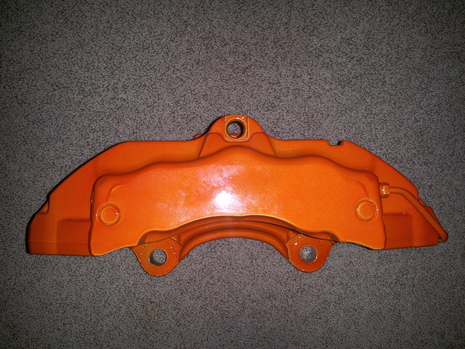

Went ahead and had them coated to match the wheels. They aren't an exact match but will do until I decide on which color to change up to.
