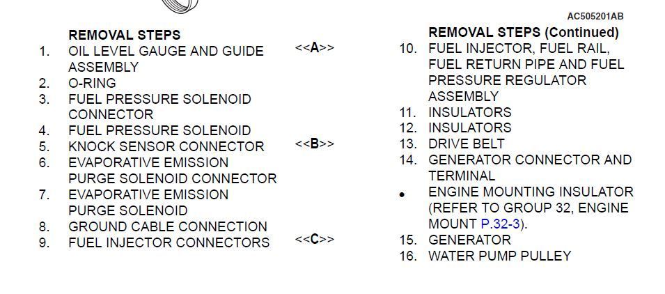

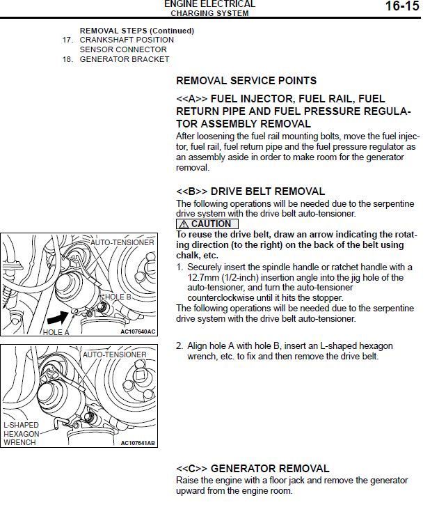

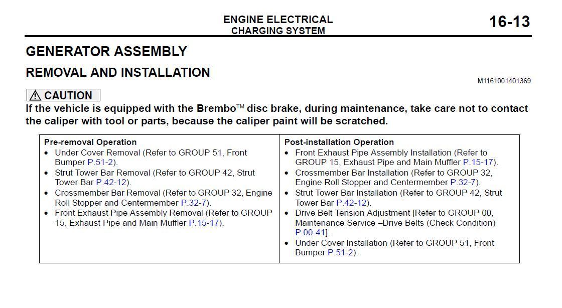

Heres the serious multi-steps from the manual. What a PITA
aint nobody got time for that! lol

Watched his Vid & doing it that way may save a few steps but its not much diff than what the manual notes
He mistakenly noted that the manual requires the intake manifold & the right front axle be removed which was not correct
The factory manual is removing the alternator from that same upper corner. The factory way will most always involve more steps than what can be eliminated in the field
