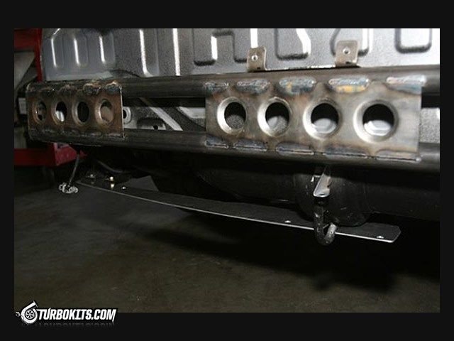

That seems to be the full list unless you wanted to add the foglight in there, I also just retrofitted my usdm plate bracket and it worked out perfectly. Also should get someone to confirm this but im almost positive there is an oem under tray that clips to the little holes on the bottom of the "diffuser" just like the front bumper has.

^ no not the cover, if you notice the small holes along the bottom of the diffuser. Kind of like what this guy made except its mitsubishi oem plastic. I cant find any pics of the oem one. Its not on stm and I think its pretty hard to find. You can see where the tabs go. Two under the tow hook cover and one on the driver side.

yea, it basically keeps it from parachuting and secures the diffuser part so the urethane doesn't bend outward. Im having a custom one made like the pic since I cannot find any sign of the oem ones for sale..lol
