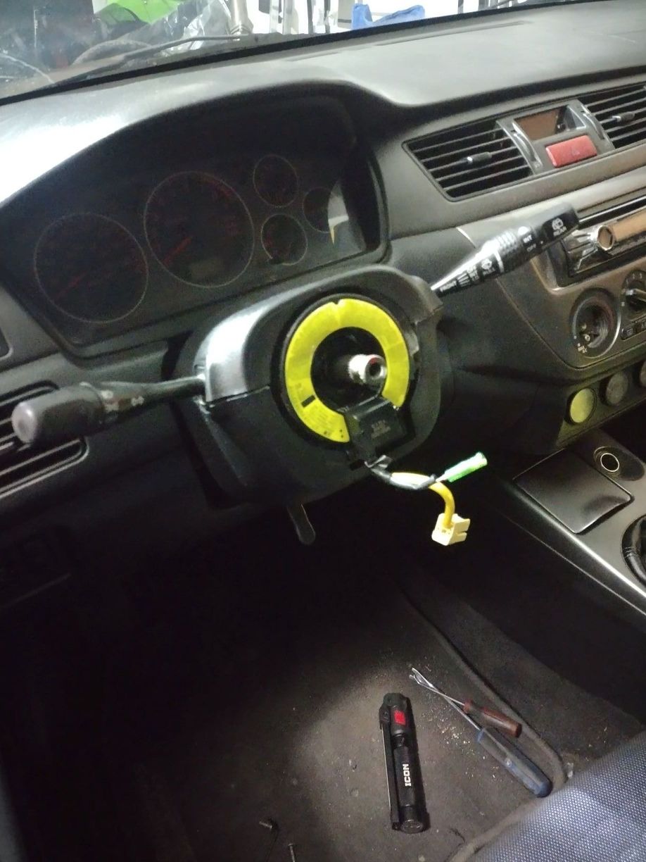

Step 2: Remove airbag and steering wheel. Place the airbag on passenger floor board, roof, underneath vehicle, with deploying side up. (Youtube and these forums have resources on that)
Step 3: Remove upper and lower steering column covers

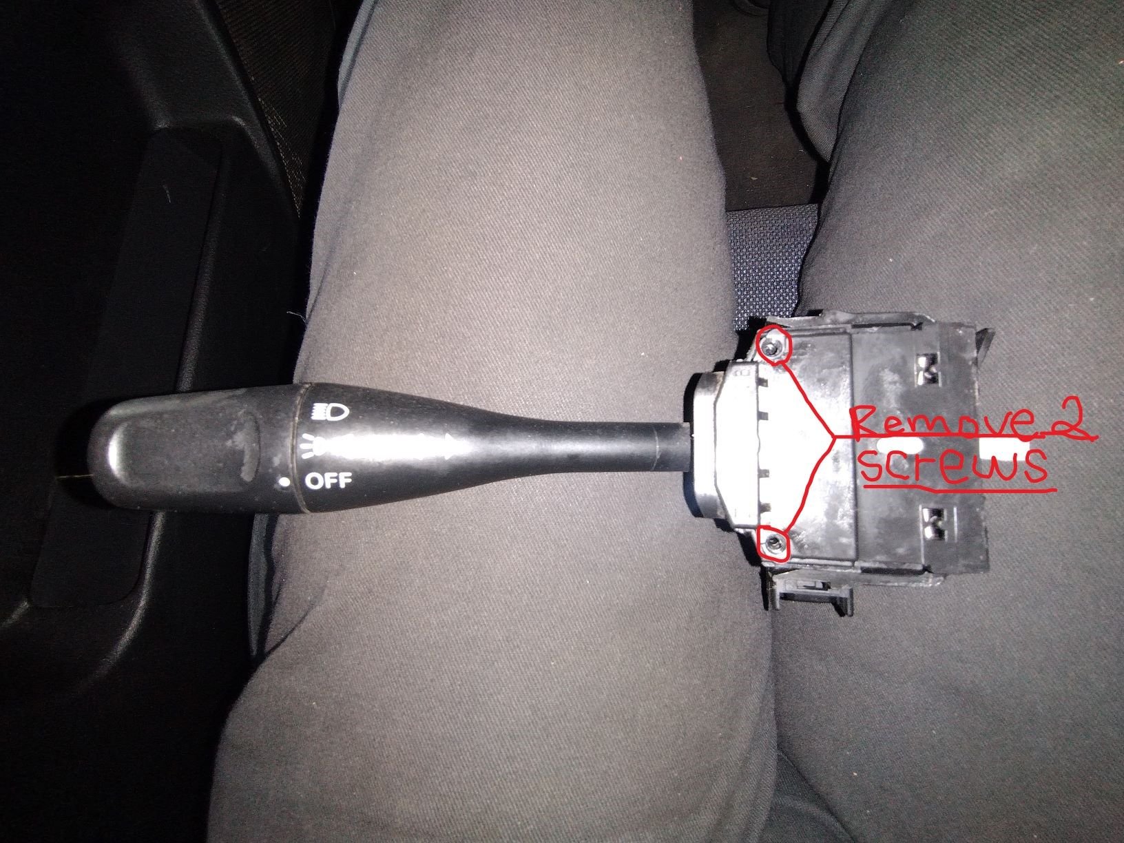

Step 4: Remove turn signal switch, by unplugging connector.

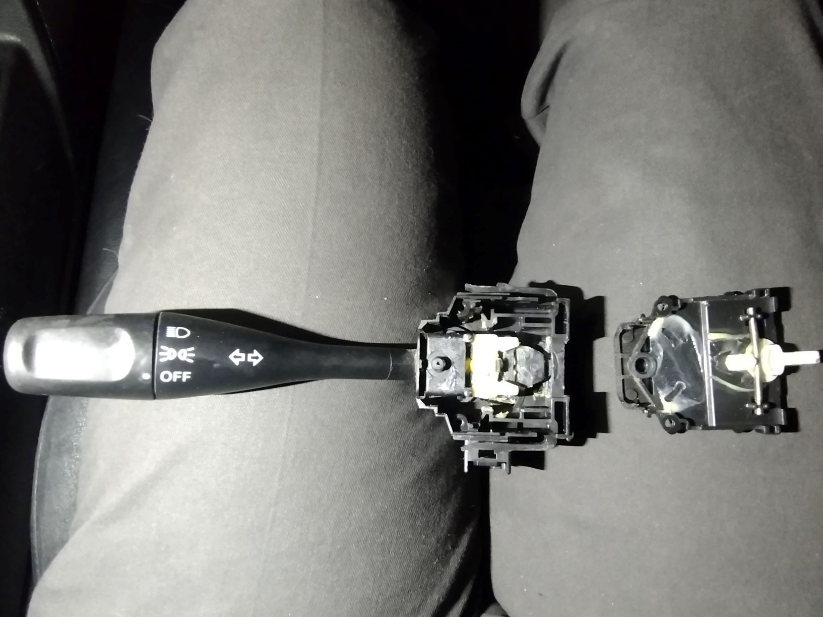

Step 5: Take apart switch using two picks or tiny screw drivers and gently pry on tables to disassemble

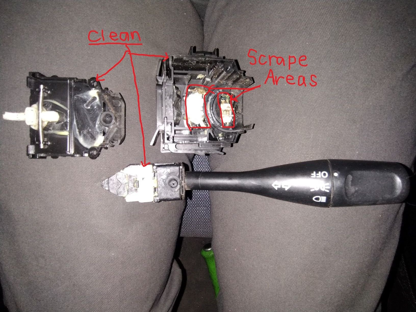

Step 6: Use brake cleaner and/or a rag to clean grease inside switch

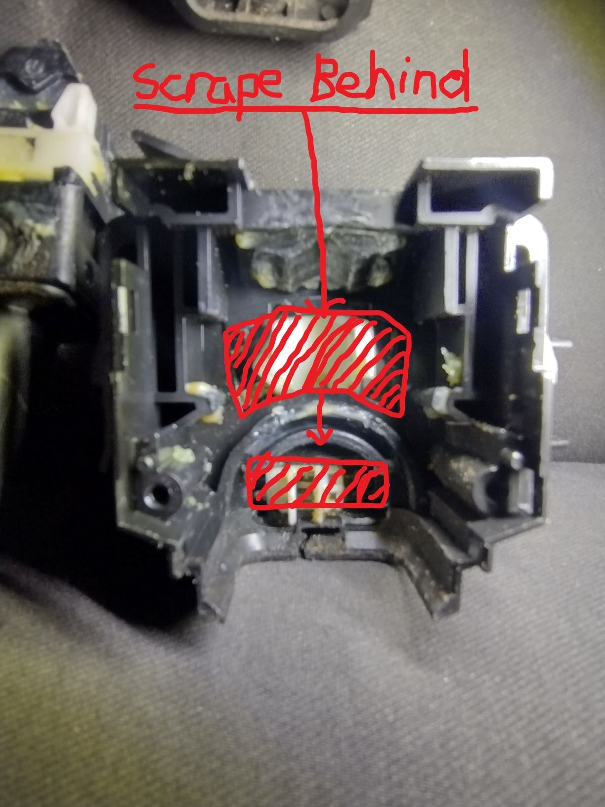

Step 7: Use a pick to scrape, or small wire type brush (small bore brush works well) to clean the copper contact areas within the switch
Step 8: Lube contact areas with dielectric grease and reassemble

Steering wheel and airbag removed
Remove two small phillip screws on switch
Degrease and scrape clean these areas, then relube
Enlarged view of main switch body
