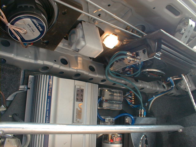

Sub installed
I ripped the interior out the first week and replaced the crappy stock system with a mostly alpine one. Made custom speaker mounts for the front from 1/2" MDF - you can get 61/2"s in there if you want to. Also, if you remove the stock tweeters then the stock mounts are fine for the alpine tweeters (you just need a coulple of bolts to hold them in place)
The rear shelf speakers will take an Alpjne 61/2" speaker, but you will need a thin mount (I used 3/8" board and made an MFD mount for under the shelf) and you will need spacers for the speaker covers to get them off of the tweeters.
As far as the sub goes - sin of sins - I put in 2 10" subs in a small box. I made a mounting bracket and bolted it to the rear strut tower brace.
The bass seems to penetrate the car from the trunk okay - even with the amp rack against the rear cross brace.
Note that there is a large empty space behind the cover on the left hand side of the trunk that you can use if you want to.
Also - handy tip - when you remove the interior panels - take the plasitc clips out of the bodywork and put them back into the panel before trying to replace them - it's easier!
perversity - thanks much for the photos - and do you have any more. I am doing a pretty small install, but more pics would be appreciated. Also, did you measure the max depth in the doors? How deep are the 6.5" you installed?
