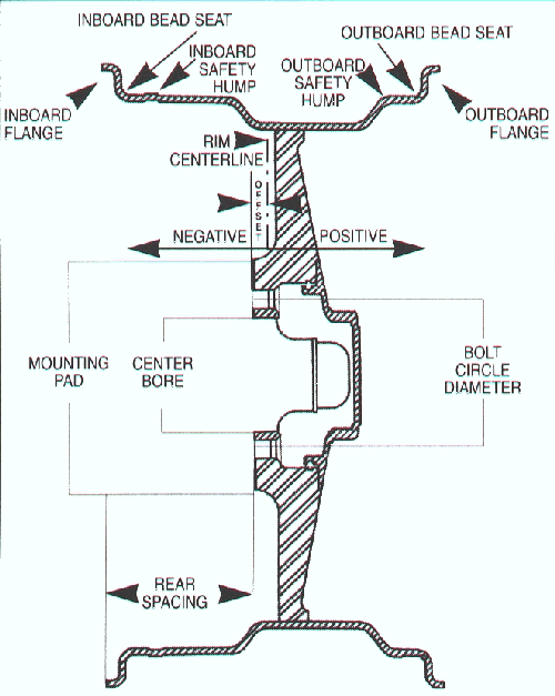

so if i get a set of 17x9 +35mm offset then that mean my rims is going to be 1 inchand 5mm sticking out rite???
Offset is a measure of "off center", so going from an 8" wide wheel to a 9" rim would only "stick out" a half inch further, plus the 3mm difference in offset (from 38 to 35mm).
Half inch (~13mm) + 3mm = stick out ~16mm further than stock

I found this page to be pretty informative.... the diagrams helped me out immensley when trying to understand offsets too!!
https://www.rsracing.com/tech-wheel.html
I hope this helps some of you out!!
This is a diagram off the above link......

Originally Posted by Jie-EVO
north miami --
incorrect
a 17x9 rim with a 35mm offset will be sticking in 1/2 inch more in stocking out 1/2 more out + 3mm
