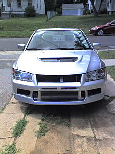

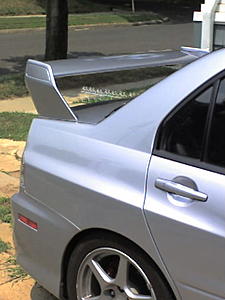

I pu the 7 bumper on mine. Luckily I got the crash beam already trimmed when I bought it. I also have the 7 wing painted to match. The bumper was a straight forward bolt on. The wing, I had to remove one bolt from it, then it bolted right up. I'm working on getting the hood next.
