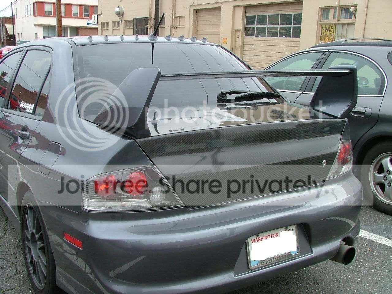

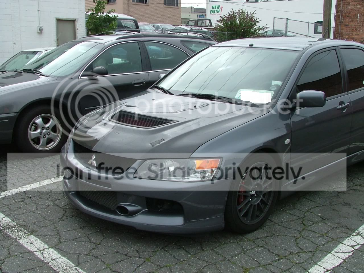

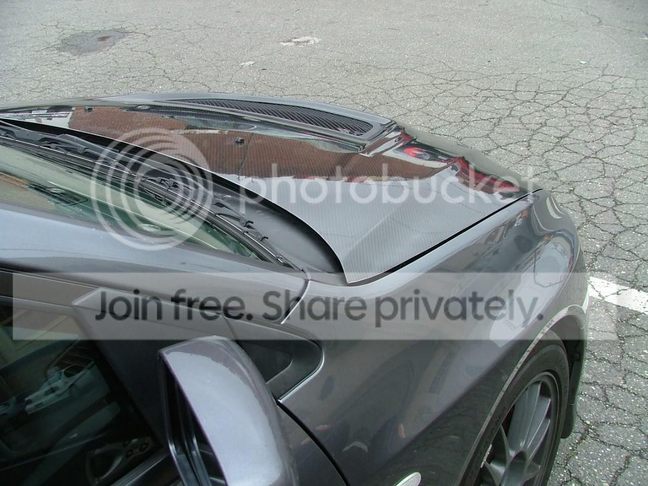

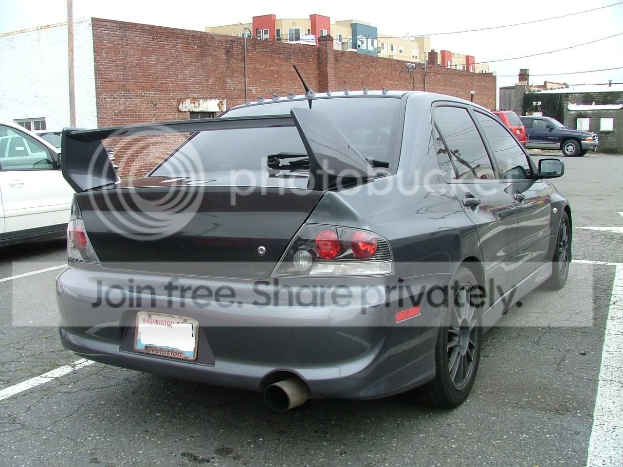

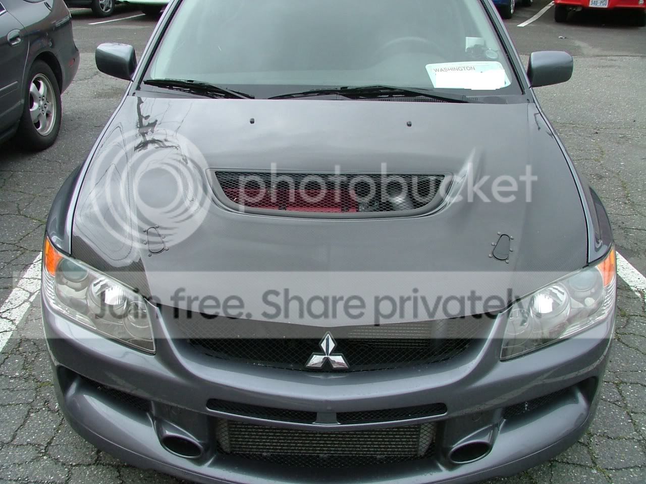

Bought from 05r6 and installed with his help last night. These are some quality pieces. They're the ones you see sold on Robispec's website, made by Fiber Images.
100% Carbon Fiber. I swear the hood is light enough to be used as a kite, if you had some string and a little wind. If you've been thinking about getting a CF hood or trunk or both, definitely go with these.
and yes, the car is filthy.

Looking at Robi's site, it's showing the hood weighing 11lbs and the trunk at 7lbs, though mine are etched with 'Fiber Images,' instead of 'Downforce Composite,' the original purchase was made through Robi so I can only assume they're the same products.
Factory hood is ~20 or 21lbs. Trunk is around the same, if I remember right. If he sees this thread perhaps he could chime in.

the factory hood is about 14~15lbs. i weighed mine when i replaced it with the Seibon carbon hood. the seibon piece is almost the exact same weight. as for the trunk, the stock trunk is about 30lbs or more, with the seibon trunk coming in at 12.5lbs. i've ditched the Seibon trunk in favor of a Chargespeed unit. the Chargespeed trunk is lighter, but i didn't get a chance to weigh it before it went on. the Chargespeed trunk is close to what Robi's are. the weave is perfect 1x1...badass. i'll be going with a Chargespeed hood soon to match the trunk, and the 1x1 on the ralliart lip and stock wing.
question...is the robi hood 1x1 or 2x2 weave?

I think the weave is 1x1, but I can't be sure. (Truth be known, I don't think I could tell the difference without it being pointed out to me first). I'll snap a close-up shot after I get home tonight. I know the weave is 'larger' than what is on the wing ;p
I'll also do some under-side shots of the hood and trunk.

Yea, right on the top of the hood between the washer nozzles.
Same thing on the lower right hand side of the trunk (You can just barely make it out in one of my trunk shots).

They're great so far. Still need to hit up Home Depot or something to get some brackets for the hood vent.
