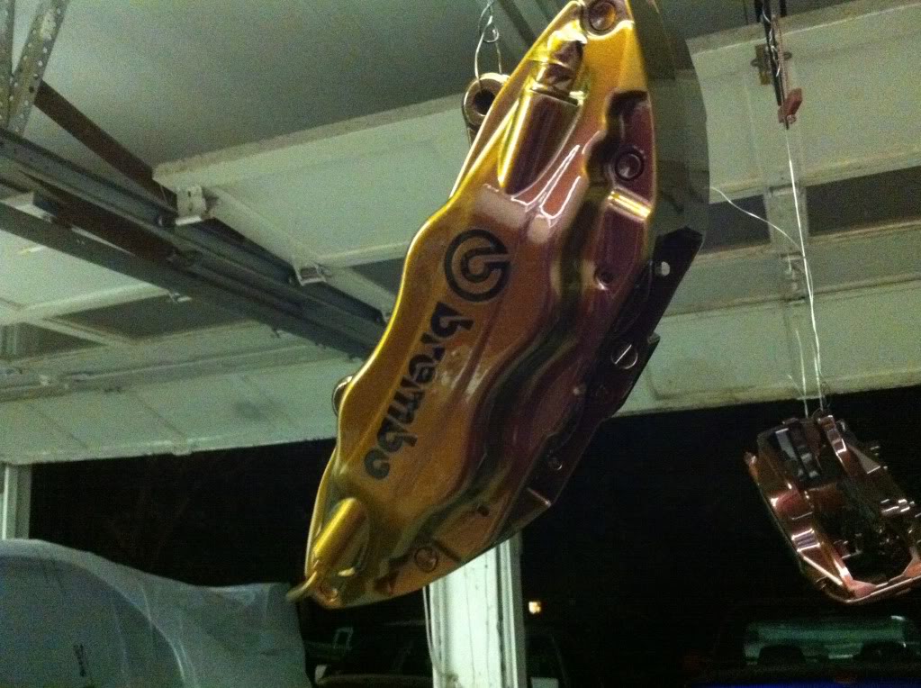

My newest color. House of Kolor Kameleon Red to Gold. It looks killer in the sunlight. Sorry about the crappy cell phone pics. I just ordered a DSLR so maybe finally I'll be able to get some decent pics soon.

nice!
