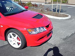

The 2 major cuts had to be made at the corner of the bumpers, making a 1" gap one on each end. Here's the driver side. Also, it would have been nice if the film extended all the way to the edge of the bumper. You can see where it ends midway across.

From the pictures and the descriptions of the issues you had were not from the lack of material, but from not having enough knowledge of how the material works. The product can be stretched and should be in key areas so that way the material bonds and conforms to the curves for a tighter and better looking fit. The Venture Tape material actually stretches twice as easy as 3M that is why many do-it-yourselfers like the material. 3M is a lot harder from the clear coat surface they use.
In almost every picture I could tell that the product was not stretched correctly. Nothing against your ability at all. I have seen many times when someone like yourself purchases a kit and tries to install and the kit ends up in the garbage can and then I get a call saying they want their money back.
I know that you cannot see from the pics of Ethan's car, but I can assure you that there are no relief cuts that had to be made because the kit didnt fit. Just so everyone also knows Ethan's car was done in the summer and yours in the last month if I am not mistaken?
I also noticed you didnt wrap the leading edge of the hood from the pic. I assume you didnt notice the notch at each end for that?
