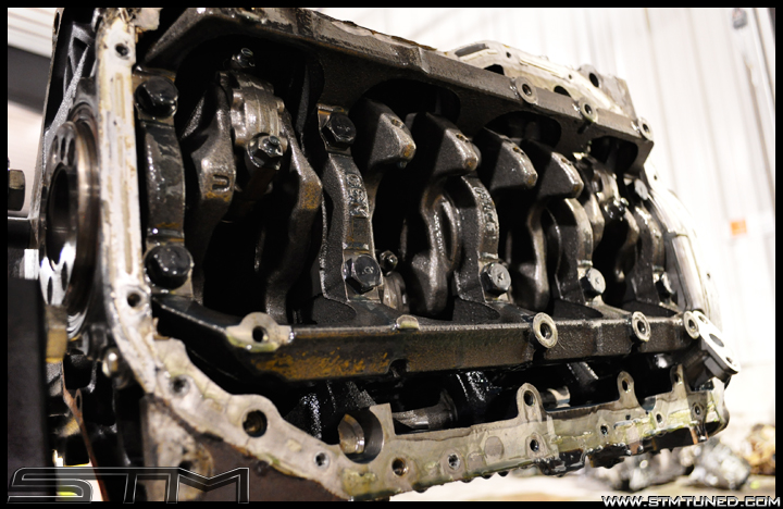

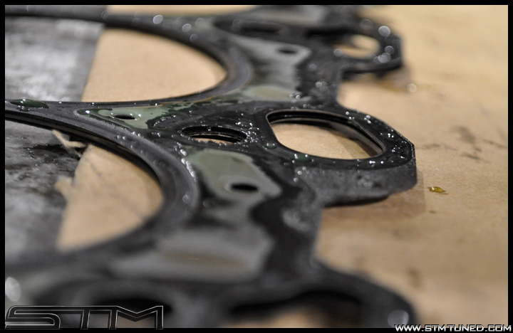

I know, I cant believe it came apart looking this good. Maybe we should have kept going. It will see a new motor soon and hopefully trap in the 160 area in 2011. Chris is going to have his hands full for sure!

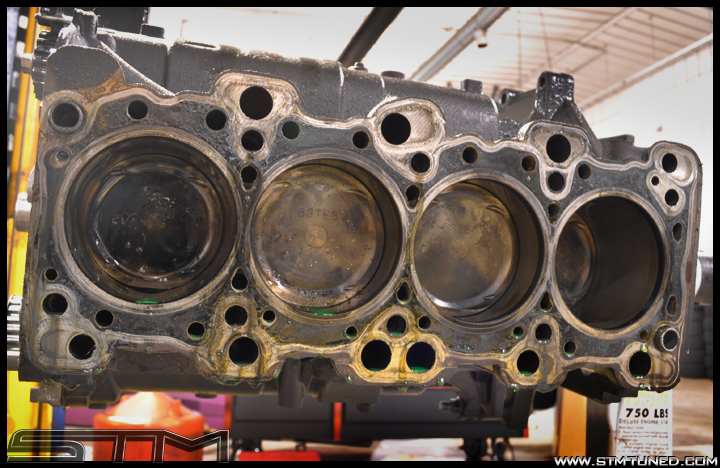

I wouldn't have said good. I remember what mine looked like when I pulled it and what damage was done after the machine shop gave it the once over with all there machines. Stock block lotto ain't nice to anyone it seems.
This motor came out looking a lot better than I expected. I am not sure what you are looking at but it seems this one had a lot of life left in it. I am still happy we made the decision to pull it though, at that power level it probably would have broke a rod soon enough.

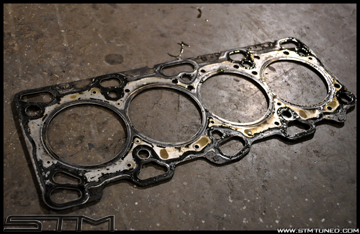

i know visually mine was cleaner and it looked mint, sat flush & everything inside looked great. but i then found out that i had stretched 6 arp headstuds and warped the deck once the machine shop got there hands on it, nothing crazy but it had to be milled a bit.(price of big boost on normal ARP headstuds) it also looks like one of the pistons touched a valve for a second, or it was tool marks from using the cylinder as a tool holder during removal of all the misc parts on a block. It also appears that the head gasket has come apart in that picture shawna took. Im sure senior buschur has a nice block ready for this car and it will do some amazing stuff next year.. 9.50 for sure.
The head gasket was fine on this car. That's pretty much how they all look when they come out. As far as your head studs stretching goes, Did your HG blow or was the car pushing coolant?

The car was pushing no coolent, but once the head gasket was removed it was obvious where it was starting to let go, as the layers were coming apart. I can post a iPhone pic of my block for comparison once I get home if you want.
So your head was lifting enough for your HG to come apart but did not push coolant? I'm baffled.
