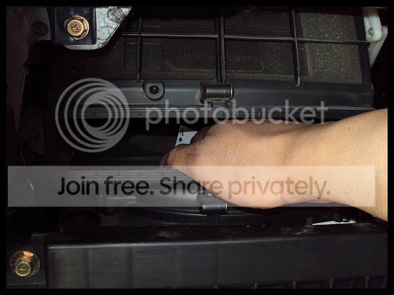

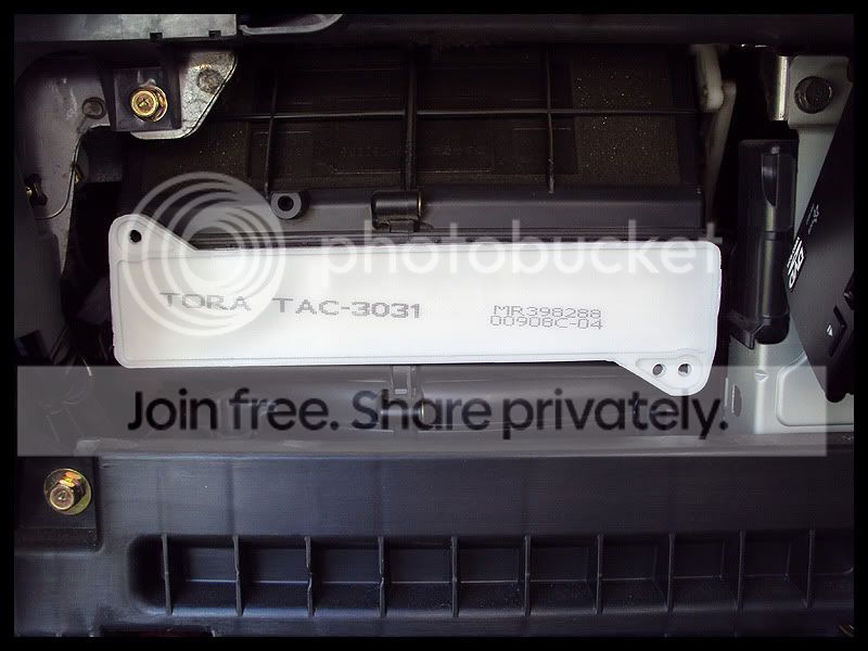

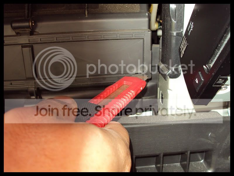

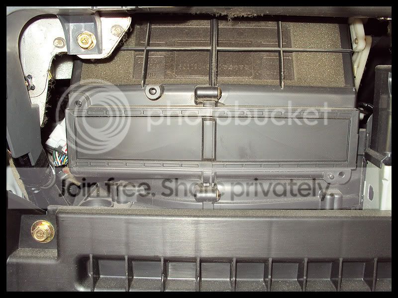

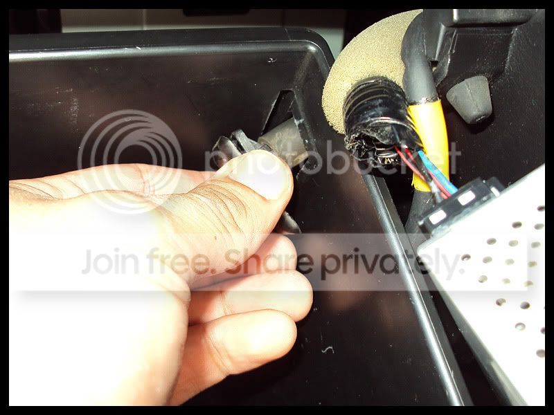

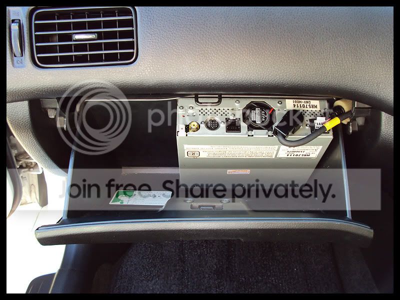

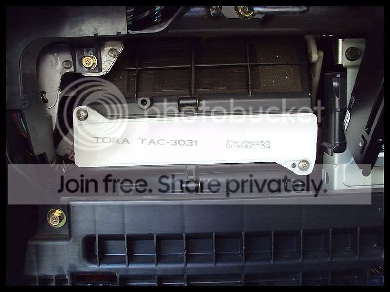

Time to install the cabin filter.
Glove box opened and ready to be removed.
One push on this tab and the whole glove box pops out. Sweet.

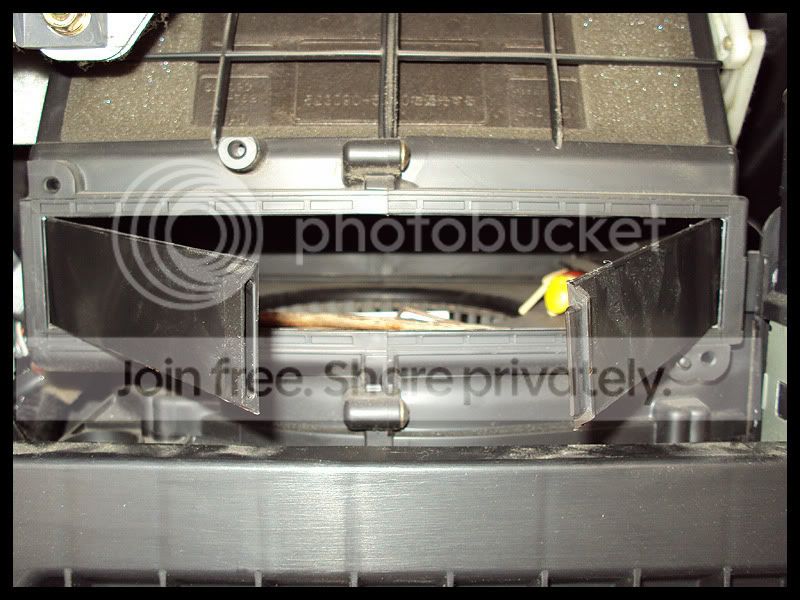

Sealed doors to the dungeon
Like a hot knife through butter. It's almost like it was meant to be "cut" away.
**** is all that in there...
Oh ****.
Crusty old sticks, Barney Rubble and a Saddam Hussein play card
This is the very reason why we need a cabin filter installed.

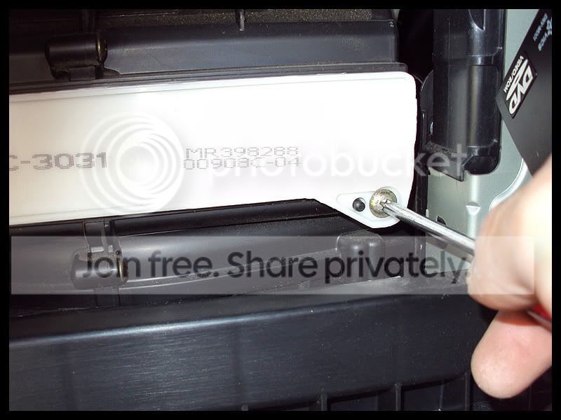

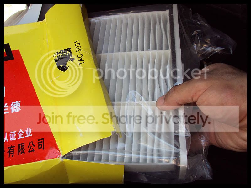

Time for the filter to go in.
Direct fit.
Using some spare Mitsubishi screws i pinched from a wrecked Magna's head unit some time ago.
There [img]style_emoticons/default/smile.gif[/img]

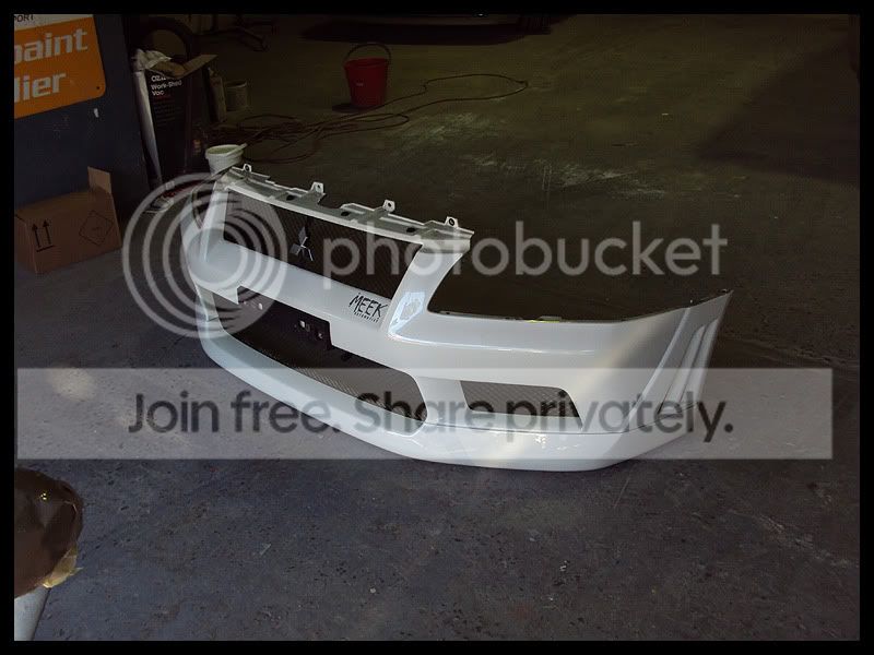

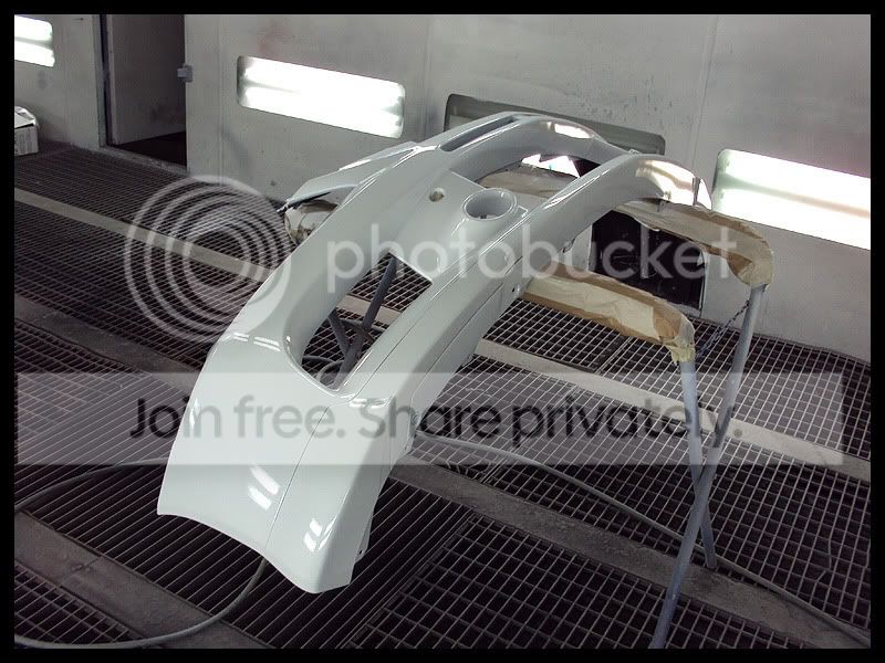

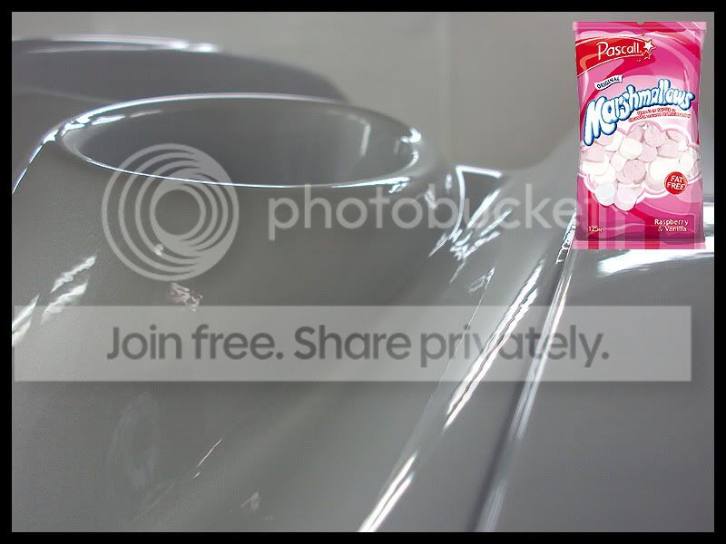

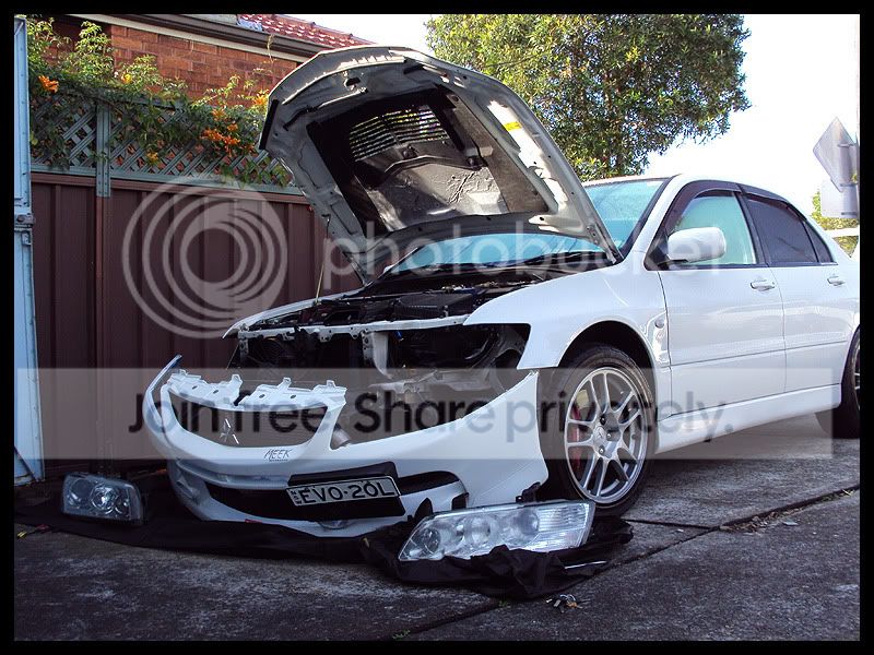

Evo 9 front bar freshly painted. Still wet though.
Paint code - W13 Silky White Pearl mixed with Marshmallow [img]style_emoticons/default/laugh.gif[/img]

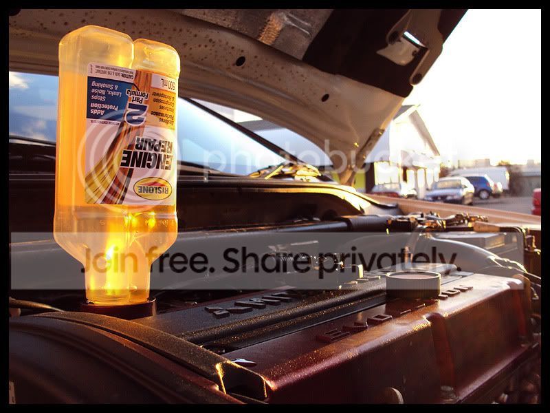

Some maintenance goods i got over the weekend.
Rislone Engine Repair. Claims to restore performance, increase compression, reduce friction and cleanse engine.
Guarantee's results can be felt within 150 kms of driving.
Full product info here.

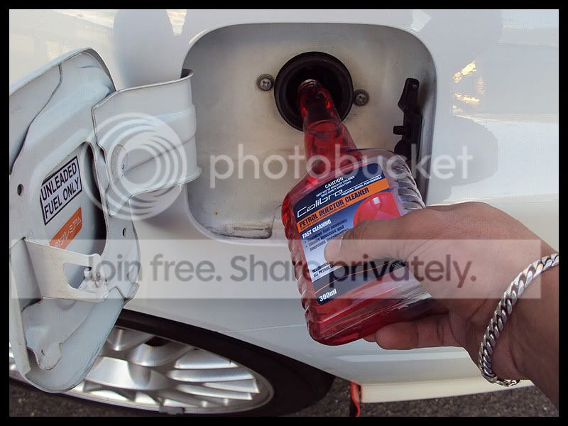

Thirst quenching injector cleaner.

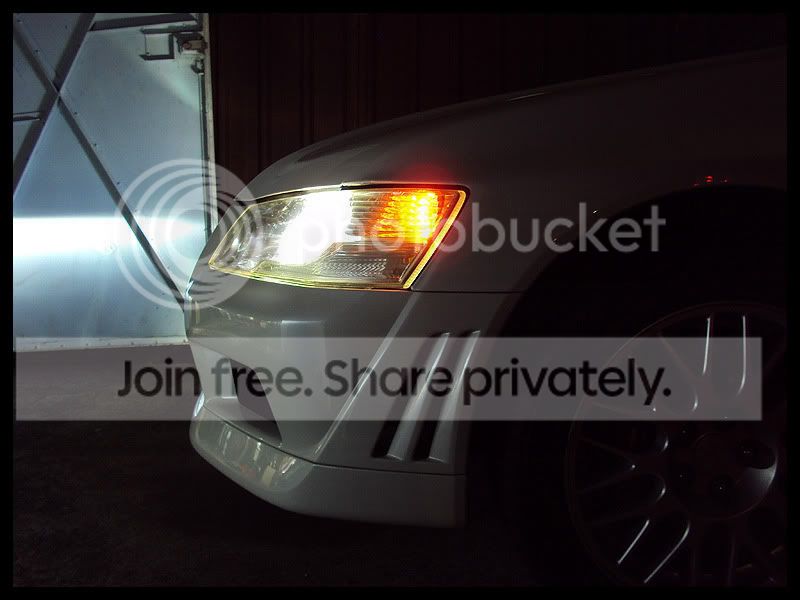

Amber parker bulbs for winter and snow driving.

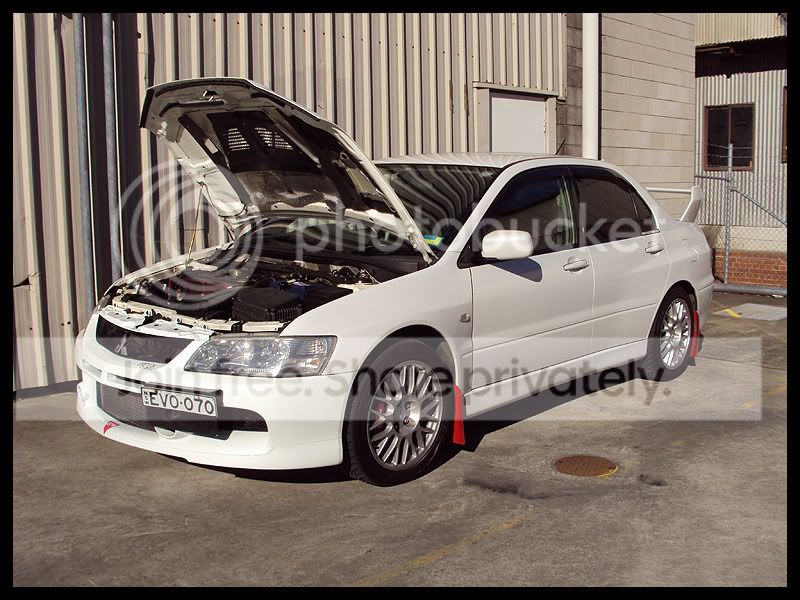

Bye bye Evo 7 bar
Hello Evo 9 front
Perfect fit. The Evo 9 oil cooler duct slotted into place as well.

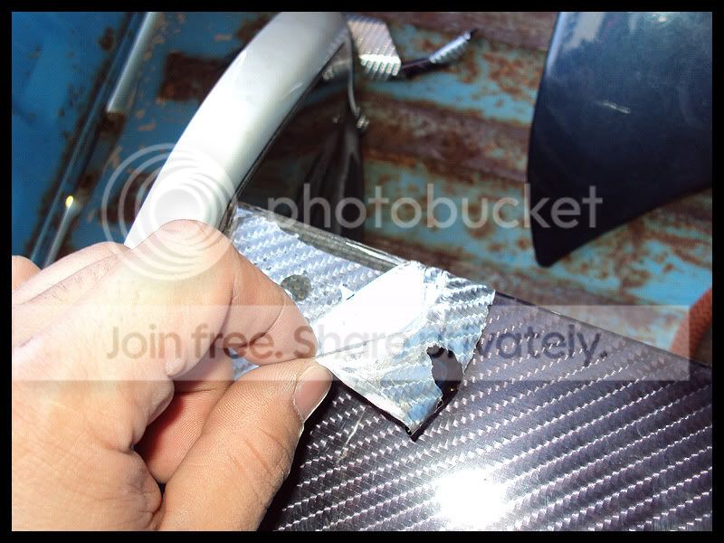

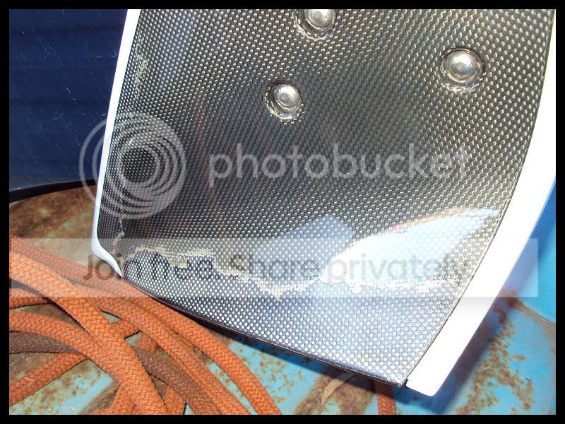

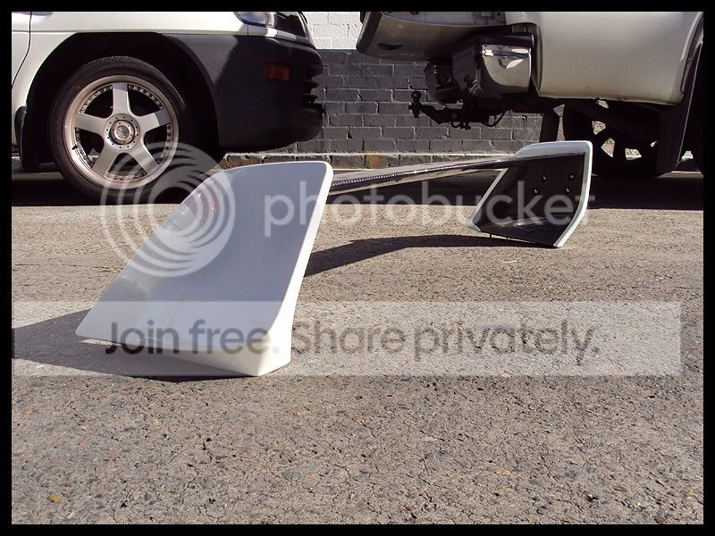

Managed to find this Evo8/9 wing for $150 on the forum.
Pretty **** condition though.
The original owner put carbon stick-on wrap to hide the blemishes.
This is all going to come off and the wing to be restored to factory condition (and the sides colour-coded to match the factory pearl).

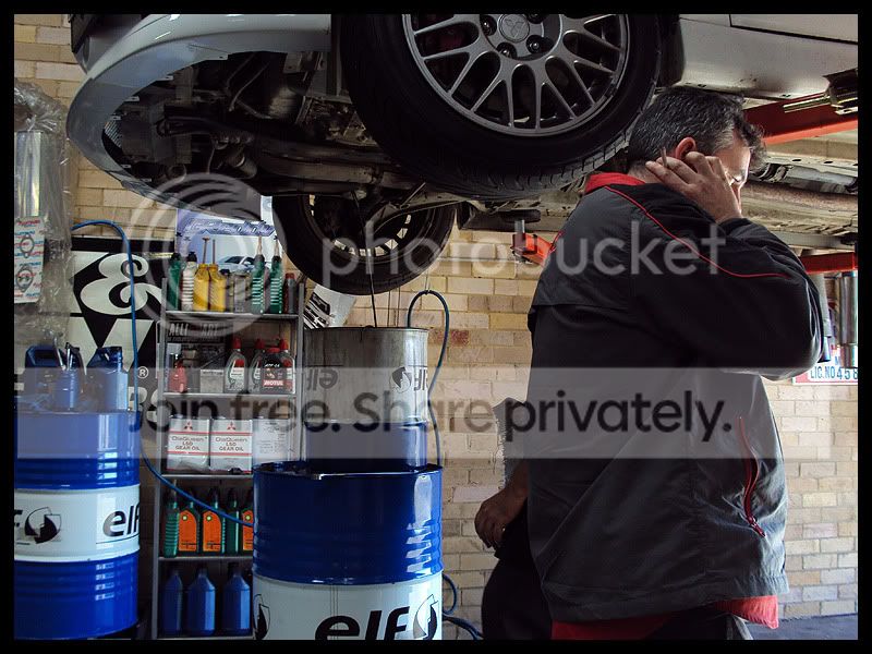

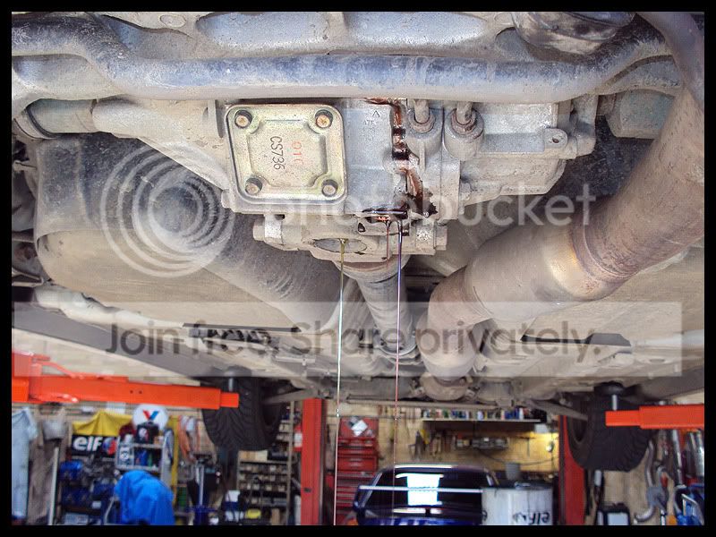

Major service. All oils changed including transmission, AYC, front and rear diff, transfer case etc.
$365.

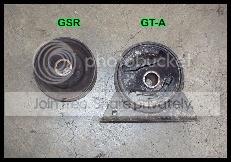

Also upgraded my front engine roll stopper to the GSR one.
The old, hollow GT-A piece of **** one was farked. I was getting a "clunk" sound when letting my foot off the accelerator in 4th and 5th gear cruising.
Definitely a difference between the two. There's no more knocking sounds on take off either.
$25 for the GSR one.

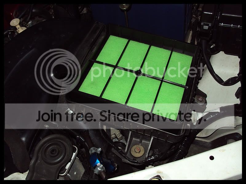

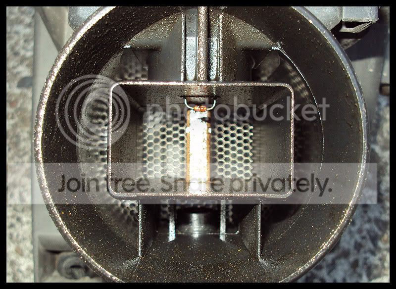

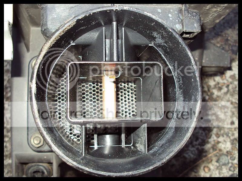

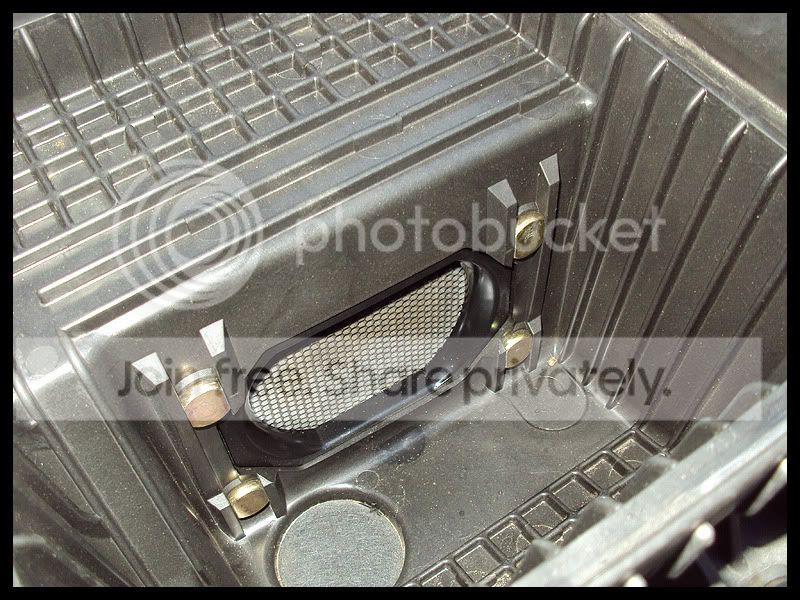

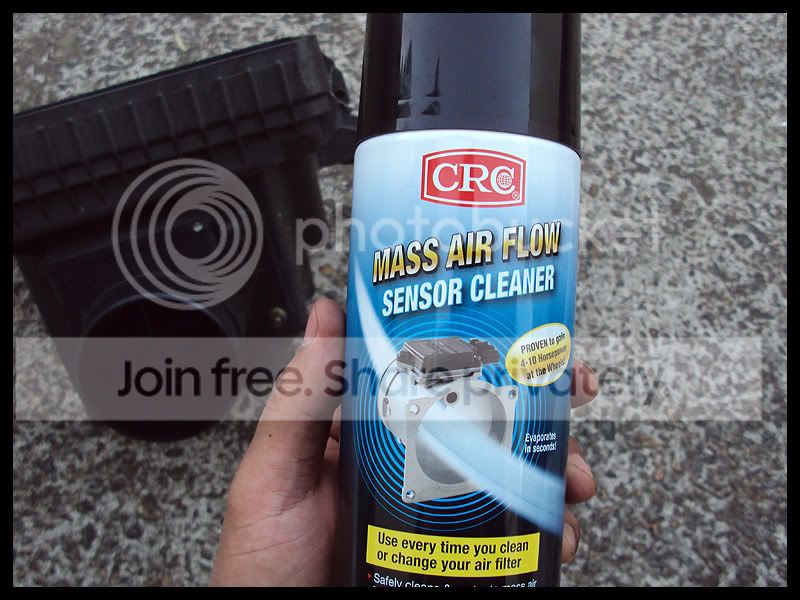

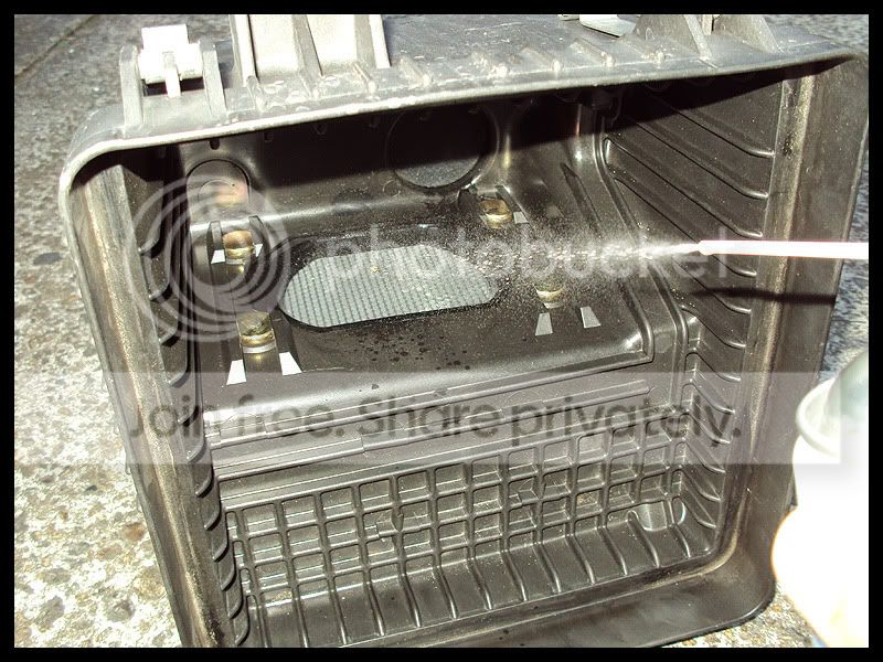

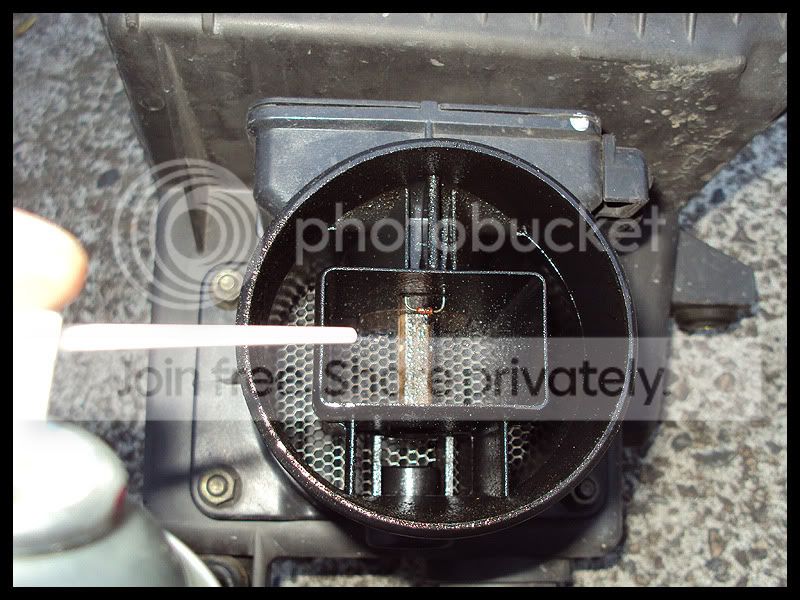

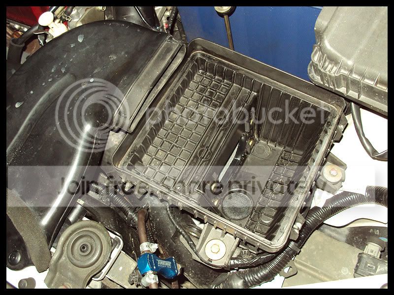

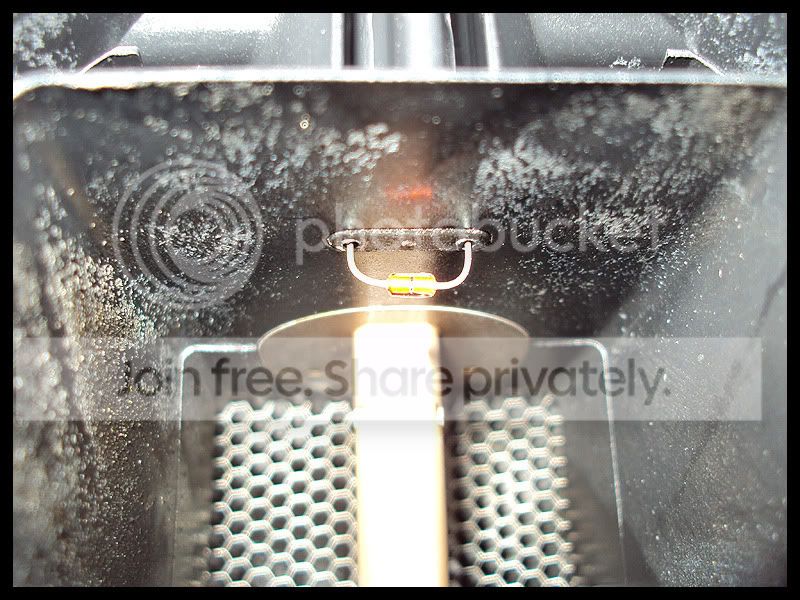

Time to inspect my MAF sensor.
Looks like an old smoker's lung.
MAF sensor cleaner. $29 from Super Cheap Auto (Thanks Johnny aka Crooza).
Little Questacon looking sensor is now nice and clean.
Time to put it all back (yes i know my engine bay is filthy).
New HKS panel filter i scored off Aaron for $40. Thanks mate.
Happy with the results after cleaning the MAF, i'm now getting 310km per tank (45L). So an increase in 15-17km per tank.

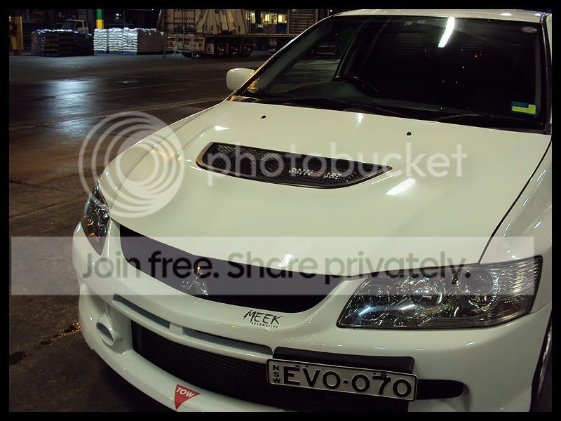

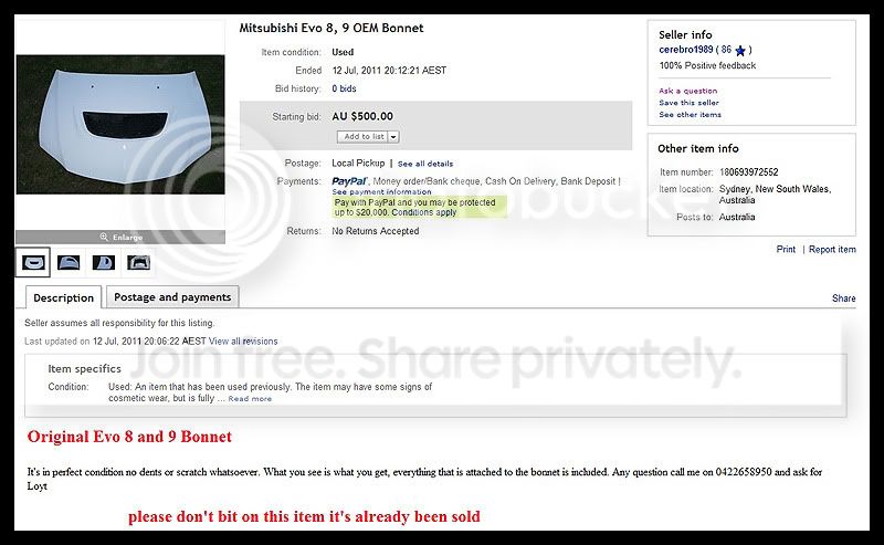

Tristian (citris) hooked me up with an Evo 9 bonnet he saw on Ebay.
So i called up and offered the owner $650 cash and the classified was closed.
Upon closer inspection, it was actually a bonnet from an Evo 9.

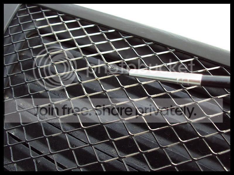

Complete with fins, mesh, water jets and insulation.

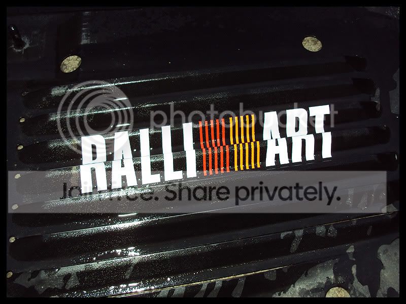

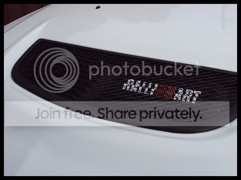

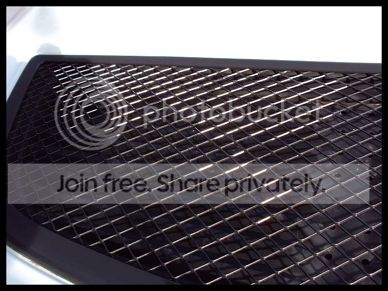

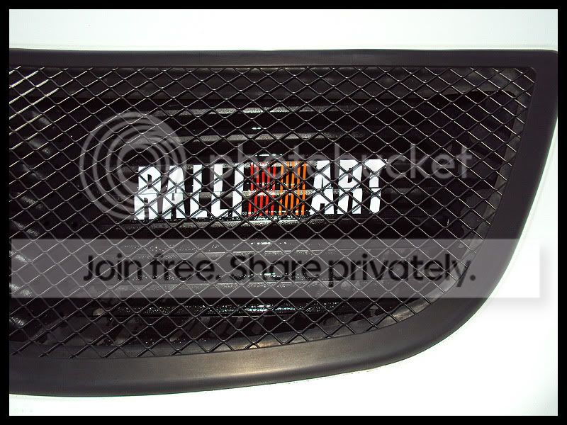

Experimenting with Ralliart bonnet fin decal.
Just experimenting for now. If i'm happy with it i'll keep it. If not, i'll scrub it off.

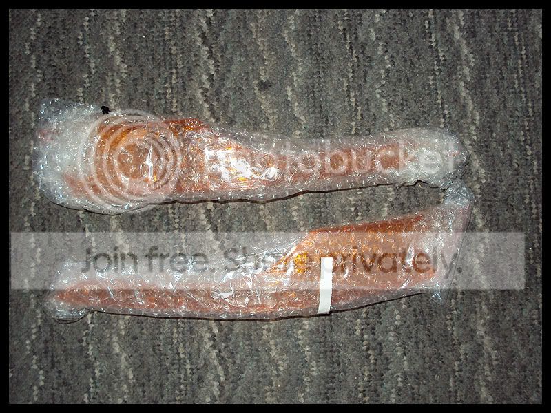

As part of my Evo 9 headlight upgrade, Trae offered to send me his GSR orange indicator lenses. Thanks bro.

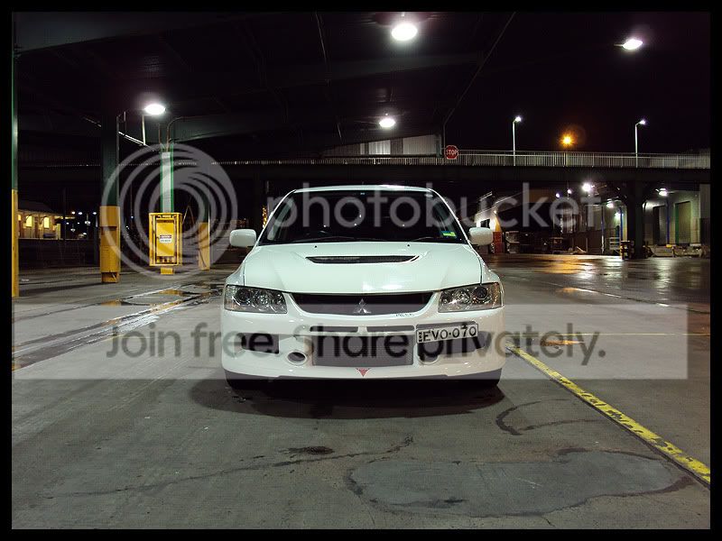

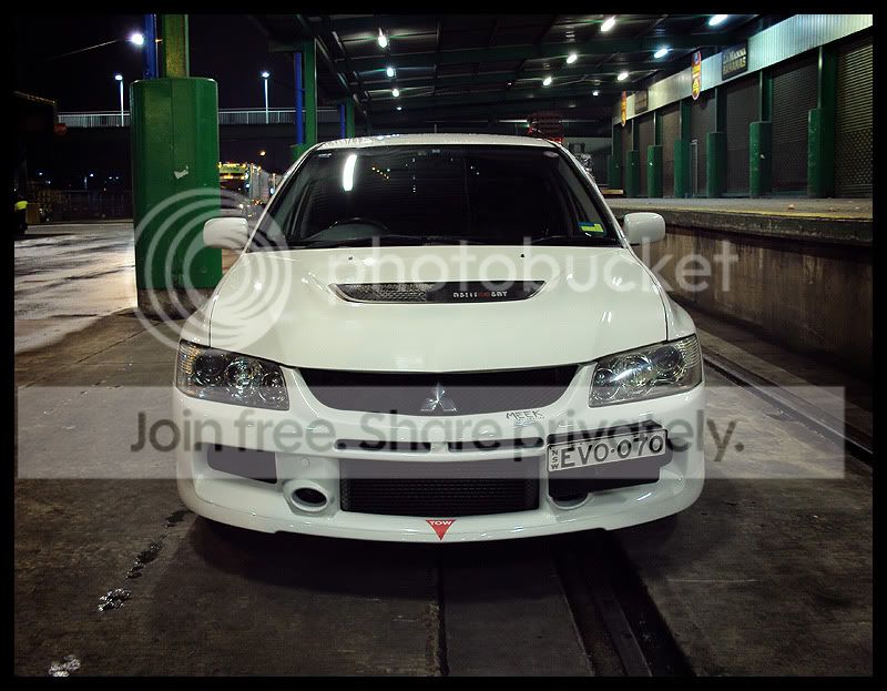

Slowly starting to look like an Evo 9 now.
The next update will hopefully see my lights finished and my wing and bonnet painted [img]style_emoticons/default/smile.gif[/img]

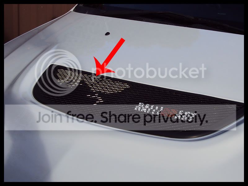

Kinda boring (i know) but gets the message across right?
**** happened to my vent. It looks as if someone printed a prehistoric world atlas onto it.

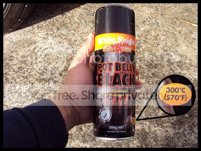

Time to get that **** sorted out.
High temperature BBQ paint. $19 from Bunnings.
Only one coat was required with a brush.
All done.

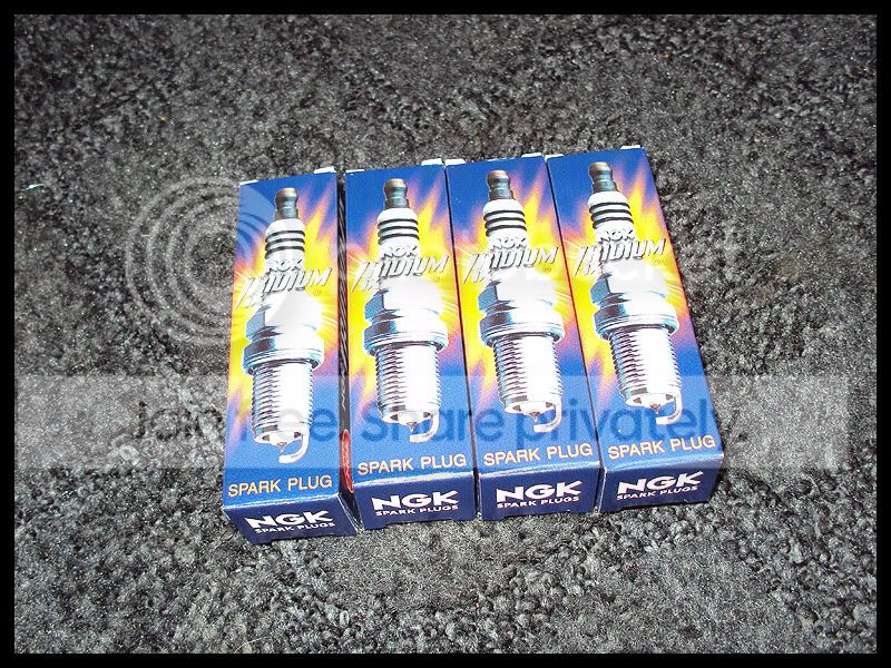

Holim sold me his near-new BPR9EIX Iridiums for $35.
Good for 20-28PSI.
Thanks bro.

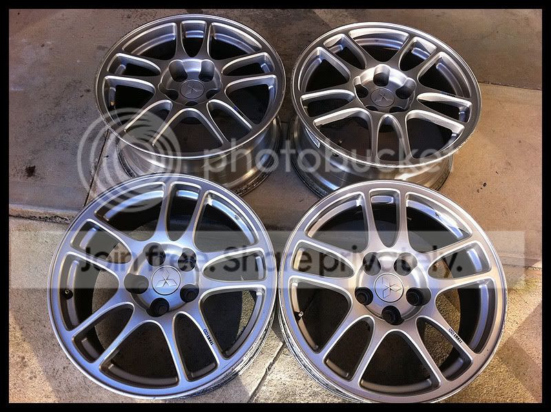

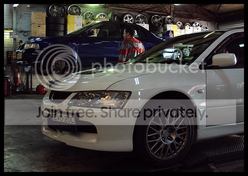

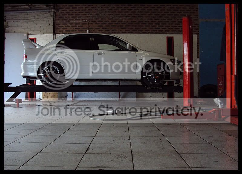

Evo 9 wheels arrived. Got them off young Damo for $650 including courier from South Australia.
Wheels arrived. All packed nicely and they easily fitted inside the car.
Waiting to get them fitted.
Done. Now just getting them balanced and aligned.
There. Nothing exciting but they have a bit more of an updated look over the Evo 7 GSR wheels.

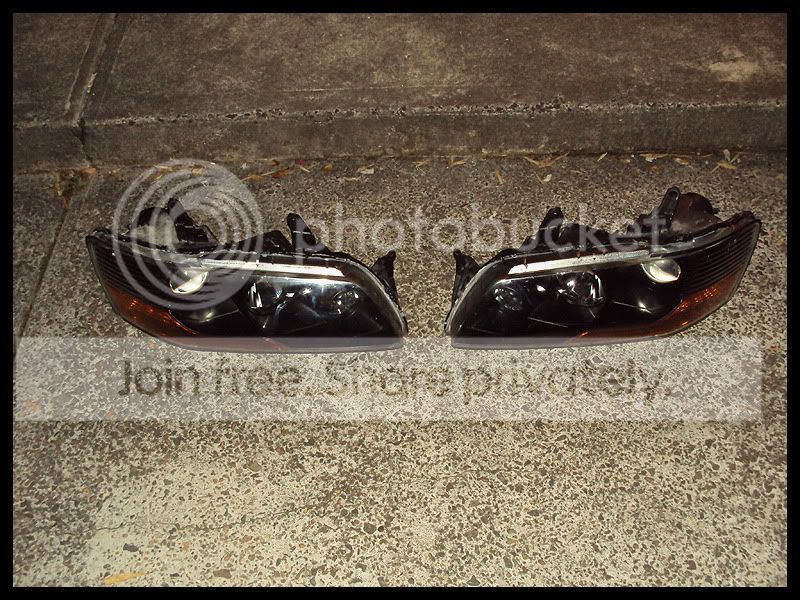

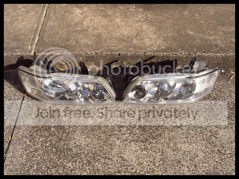

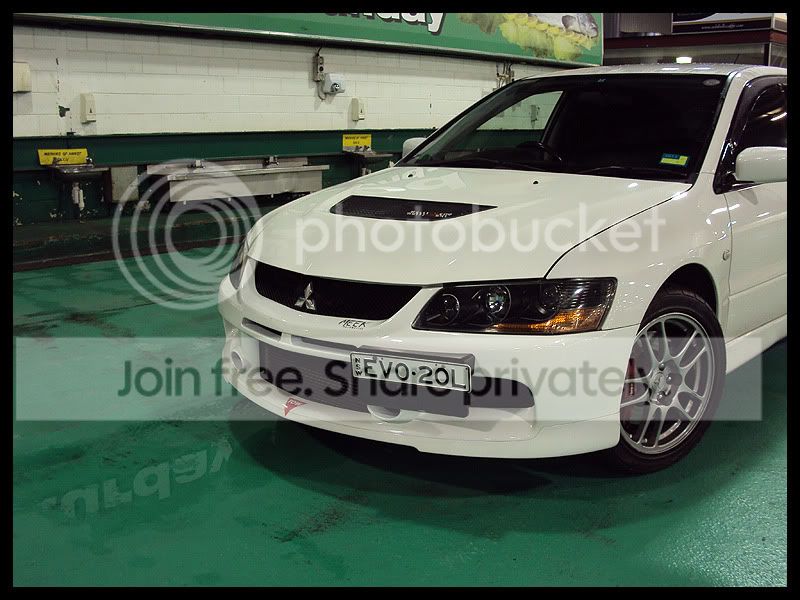

Right. It was time to get the headlights out to prepare them for the MR/Evo 9 upgrade.
So Stuart came to pick up the headlights on Sunday morning.
Here they are originally looking homosexual.
After the conversion (**** house photo i know).
Lights re-fitted.
The front is almost looking one hundred percent Evo 9 now.
