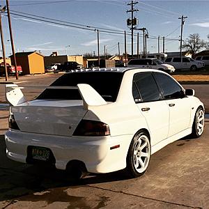

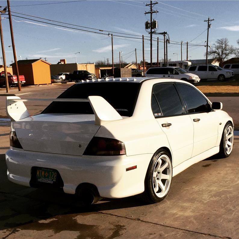

I have raceland coilovers on 18x9.5 rota grids with tires 245/40 only rubbing issues are when I have passengers in the back and if I hit a good dip or turning up a high driveway at an angle other than that no rubbing issues my fenders are stock and also rolled front and back
