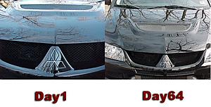

UPDATE DAY: 64
Well after 64 days of salt, cinders and brine our weather finally took a day off. With mid-50's in the air I decided it was time for the first real test of our comparison...the first hand washing.
Nothing special here, just some Meguiars soap and water, rinse and dry...no additional waxes or polishes of any kind.
In the end I noticed a few things.
1) Both sides continue to look great even after not washing the car in the worse condisiotns for 64 days.
2) Both side shine and reflect equally.
3) As far as feel I'm amazed. Both sides feel glass smooth. Meguiars had a few rough spots but so did Zaino so I think that was probably just conditions. The hood feels great and almost perfectly smooth, but the sides, especially the lower sides feel the roughest and feel in need of clay and re-waxing. Overall the Meguiars side had fewer rough spots but that is probably just a result of conditions.
There is no clear winner still. The next test will probably be the same sort of thing, and after that I'll probably sytart testing to see if either side comes out better after freshening up the wax/polish layers.
For now I'd say the only winner may still ONLY be based on price and ease of application (both going to Meguiars).
This is a long-term test so stay tuned. I'll let the original layers go as far as I can before re-waxing so we get a valid test, BUT at some point like I said above I will re-apply each side and keep the test going. I think it will be interesting to see how they behave in summer with easier conditions, but hotter sun (on a black car).
Stay tuned...
PS With 13-inches of melting mush and road salt dust in the air I suspect my clean Tarmac won't even last a day!

Up close

The lighting is certainly different here, time of day & Dec. sky vs Feb. sky...but I think you get the idea. It is the same camera and roughly the same angle.

i have never used Zaino, but personally ALL I use is the Meguiars line, because it is easy to buy with Zaino... I think the only place to purchase is online. I work closely with Meguiars and so I am sponsored by them. Their new line just came out - NXT (Next Generation Garage) Line which features synthetic polymers. I can always agree that Meguiars knows there **** when it comes to car care products. A car museum with priceless vehicles uses Meguiars... showcars in the show scene whom the owner's simply LOVE their car, use Meguiars. I have no other reason to say, what the hell is the point of using Zaino. As in the pictures, you cannot even tell the difference. Meguiars is also more cost-effective if you are constantly cleaning your car. This is just my opinion.
