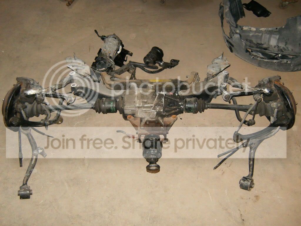

and what exactly are you talking when you say rear end? I'm thinking you're talking about more than just the bumper.. so evo 8 trans, axles, rear diff, tacase, how about the driveshaft, upper and lower control arms..? would any of that matter.. sorry for the newbie questions, I'm actually learning a quite of few things just brainstorming this project
This is a complete Evo 4 GSR rear end. You need all of these parts minus the diff, axles, and AYC pump stuff. It's basically just the knuckles, control arms, and subframe parts.

Thanks for the picture man, that actually helped. so pretty much I'll just replacing the e4 gsr parts with e8 diff, axles, transfer case, and etc.?? alright lets say I use a RS transmission.. I'll just have to get the RS diff, axles and xfer case and everything will still be good right? Correct me if I'm wrong but aren't the RS and E8 axles and etc pretty much the same? but yea i'm just trying to keep as much E4 parts as possible, but still able to pass smog and get bar'd..
