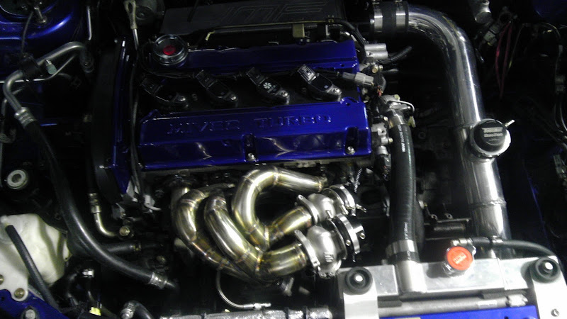

You get the gist. I basically changed the entire car inside and out (minus paint). I'll have a parts list after all the documentation but I spent way more then I anticipated.

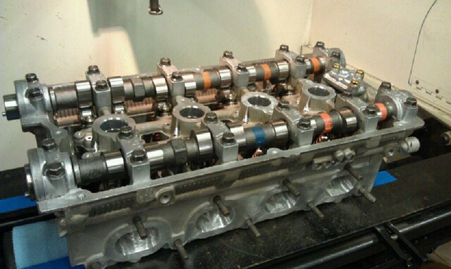

For the motor I went with a 2.4 and for the turbo setup its a 6265 twinscroll. I pulled the trigger on the turbo setup in March and April I pulled the trigger on the motor. All the other stuff was purchased along the way.
GSC was on backorder for the S3's and my buddies shop Zen was super backlogged so it took a while for the wrenching to start, but once it started it was slow motion, car sitting for over 6 months, moving from my garage to my buddies shop.....parts went missing.
So on to some of the issues I ran into. Apparently my motor blowing was so severe it cracked the transfercase housing. I found one locally but it was for a non ACD 8. Bought one from someone in Hawaii and had it 2 day'd (I wanted my car fixed really bad, lol).
Intercoolers pipes I got from the same maker of the manifold were a little off so they had to be modified a bit. Had a leak coming from back of the head where the mivec filter was and then one from the block where the mivec line car from (Those should be resolved now. Been driving for a day and no leaks).
I had an issue with my double pumper (BlaqOps), when I had a quarter tank it would act like it was running out of fuel. Never got a chance to sort it out last year when my car blew so we had to figure it out now, finally figured out the socks were pointed the wrong direction (simple but missed fixed).
I was working with English racing on email tuning but I got into a little trouble on my closest open road with the local LEO (like 5 cruisers, guns drawn type trouble). I talked them down off taking me to jail and they just gave me a speeding ticket after all the drama (I think they were bored). I showed them I wasn't just joy riding I was actually trying to tune my car. I had plans to go to Spec-Ops in NC but Scott from TTP was in town and was at my buddies shop. After talking with him he agreed to come back the next day and tune the car.
He spent almost 10 hours at my friends shop....mainly chasing issues.....some small, some potentially engine blowing. I know he gets a bad rap from some on the numbers his dyno put out but all I know is I owe that man alot. He KNOWS his stuff. I'm a believer. If it wasn't for him I could've been parting my car out after blowing the motor again.
Anyways he was able to street tune it to 24 PSI but the car was breaking up. He suggested i go back to the OEM plugs (I was running one step colder Denso's). After taking the Denso's out we noted that 3 of the 4 plugs had bad cracks in the porcelin. Swapped the plugs in and the misfire issue was worse. Swapped back to OEM coilpacks and the situation did NOT change. We pulled the plugs again and sure enough one of the OEM plugs had a crack in the porcelin (we missed when we pulled it originally). Got another set of OEM plugs and the car MOVES OUT at 24 PSI (on E85). I've been in some 600HP cars before and this feels like that.
So now the last thing to check is my clutch. I'm having to put my foot all the way on the ground to get into gear and even then sometimes its a struggle. Might have to adjust the clutch fork....I replaced the master cylinder last year so I doubt thats it....maybe a slave cylinder.
That being said I broke my rule. I'm posting this because I'm excited about the car but I didn't want to until I had a dyno sheet to post. There is a drag event coming up in November. I plan on taking it down the track once to see what kind of trap speed it will pull. I'm not launching it and I'm not putting slicks on it. This is a street vehicle.
We should be finalizing the E85 tune this Friday. I'll tune it for 93 later next month (I never run it anyways but in case i want to take it out of state).
As for driving impressions. Car is scary just at 24 PSI. Can't imagine what more power feels like.

Engine:
2.4 Block
MAHLE MOTORSPORTS CUSTOM PISTONS (10.5)
TOTAL SEAL PERFORMANCE RINGS
MANLEY TURBO TUFF LONG RODS
CLEVITE RACE ROD BEARINGS
CLEVITE RACE MAIN BEARINGS
CLEVITE THRUST BEARING
ARP MAIN STUDS
COMETIC CUSTOM 87mm HEADGASKET
ARP 625+ SUPER ALLOY HEAD STUDS
FERREA +1mm INTAKE VALVES
FERREA +1mm EXHAUST VALVES
FERREA DUAL VALVE SPRINGS AND SEATS
FERREA TITANIUM RETAINERS AND LOCKS
SBI BRONZE VALVE GUIDES
GSC POWER-DIVISION S3 CAMSHAFTS
CLEVITE BRASS FREEZE PLUGS
CLEVITE BALANCE SHAFT BEARINGS
BORE CYLINDERS
POWER HONE WITH TORQUE PLATE
DECK BLOCK
LINE HONE MAIN JOURNALS
POWDERCOAT BLOCK
O-RING DECK
MACHINE FOR EVO OIL SQUIRTERS
MACHINE FOR COSWORTH OIL SCRAPER
MACHINE FOR MIVEC OIL LINE
BALANCE ROTATING ASSEMBLY
KNIFE EDGE AND POLISH CRANKSHAFT
CHECK ROD BEARING CLEARANCE
CHECK MAIN BEARING CLEARANCE
CLAY BAR FOR PISTON-VALVE CLEARANCE
MACHINE HEAD FOR OVERSIZED VALVES
RESURFACE HEAD
STAGE 3 PORT AND POLISH
POWDERCOAT VALVE COVER AND OIL PAN
OEM BSE (stubby shaft)
MAPerformance Mivec oil return
Gates 4G63 timing Belt
Gates accessory belt
Fidanza Cam gear

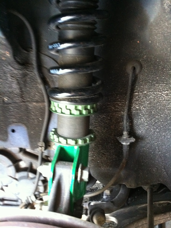

Suspension/Handling:
Tein Type Flex w/EDFC (traded a local my BC's plus cash, might upgrade again next year)

Great Job on the car H, it really looks good. That manifold looks like its serious business too. There are so many high hp evo's running around the A-T-L now that its crazy! I cant wait to see it in person and in action on the streets/dyno. Well done sir.
