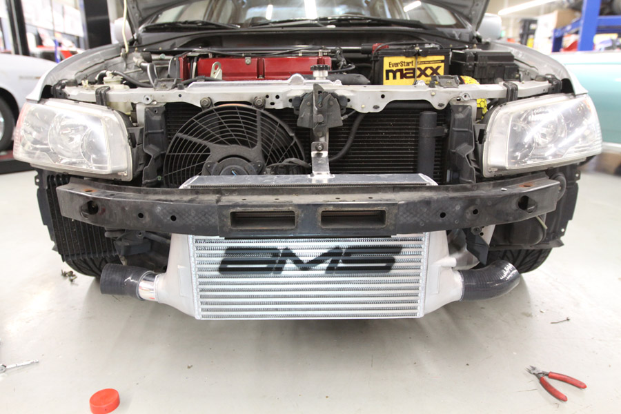

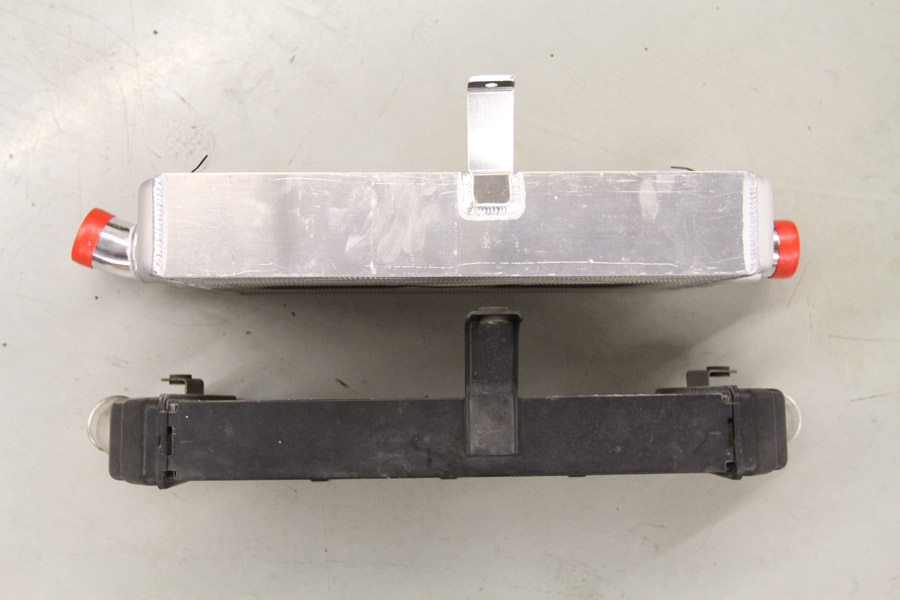

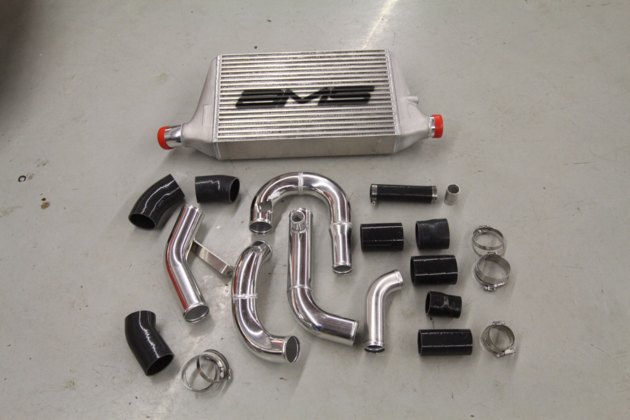

Making power without a good intercooler is futile, heat soak onsets rather quickly with the stock unit so I went with a brand that I've used in the past, AMS. Their intercooler kit fits behind the stock re-bar which was a key selling part for me.

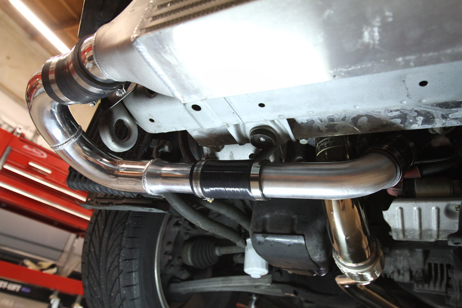

I also picked up both upper and lower intercooler piping kits since running the stock rubber piping was a no-no. Watching it expand on the dyno gave me all the reason I needed to replace it.
Here's why I won't worry about heat soak anymore. Check out how much thicker that core is.
Fits just like stock!
Fitment on the piping is superb.

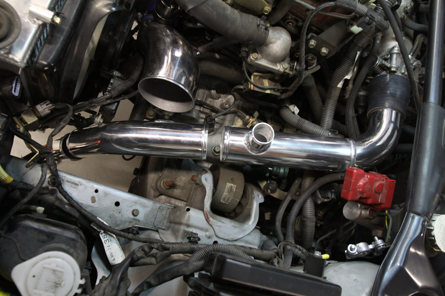

The upper intercooler piping has a shorter route to the throttle body which is great but you need to get rid of the stock battery.

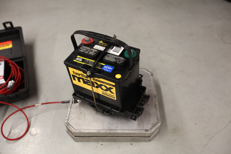

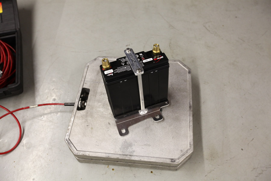

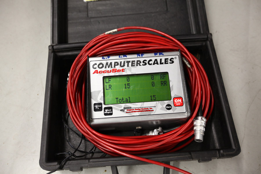

To replace the stock battery I picked up the AMS small battery kit. It weighs a modest 15lbs and has a nice solid mount setup.

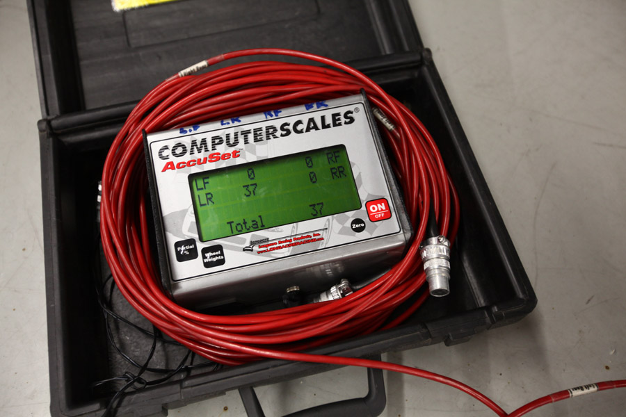

My stock battery was just a little bit heavier at 37 lbs.
Unfortunately, the stock Evo + battery terminal was just a tad short for my tastes so I lengthened it.
Since AMS recommends disconnecting the battery when the car sits for long periods of time, I replaced the - terminal with a quick release terminal since my car does sit around quite a bit.

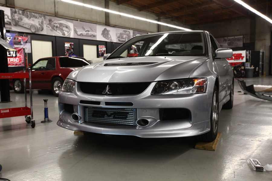

Ditching the Evo 8 bumper seemed like it would be an easy swap over to the 9 but damn I wasn't expecting so much work. Since I didn't buy everything new for the 9 bumper I had to swap over a couple brackets and retrofit the IC sprayer.
The entire process ended up taking way too much time and if I had to do it again, I would buy all the pieces needed rather then try to use some of them from the Evo 8 bumper.
After all that fuss, I had a completed Evo 9 bumper ready to install.
I also caved and traded my Evo 8 headlights for a set of 9 lights. I thought about the JDM black housing lights but wanted a more OEM look so for now I'm sticking with them.
Of course the 9 bumper fits like a glove which is why I don't think I'll ever run any aftermarket fiberglass body part ever again. They just don't have the fitment that I want.
