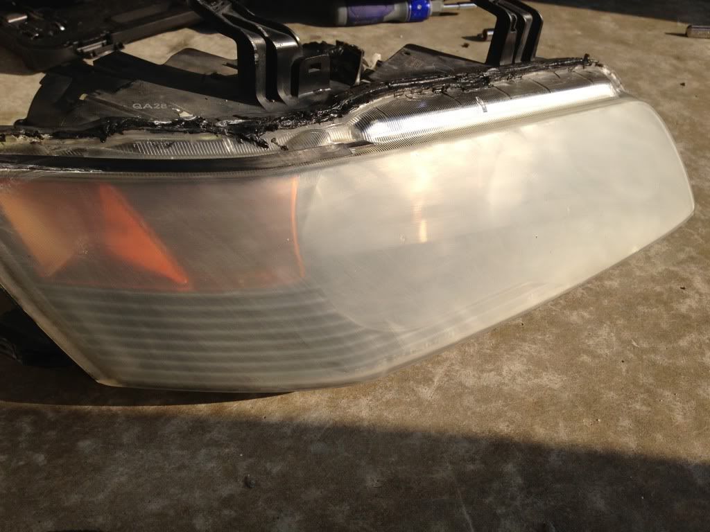

I used a metal polish on mine. Take your time. It's like polishing boots(military). I'm an absolute OCD dude about my lights. To me it's an art. Haha.
Sanded with 2500 grit
First coat of polish
Somewhat final product I probably did a few more after this...
I would reccomend the UV coating, but I've never done it. Just touch up once a month or so....
