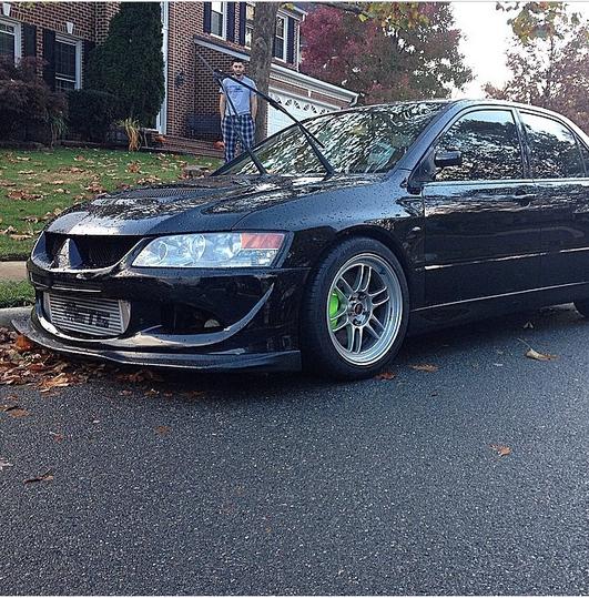

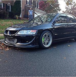

Since there's a lowering spring there's figured a coilover thread would be nice.
Here's my 05 with fortune auto 500's 10k rear spring/8k front spring. 255/40/17 with enkei RPF1 in 17x9.5+38 no roll no pull, 20mm spacers in front.

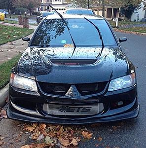

Front shot
