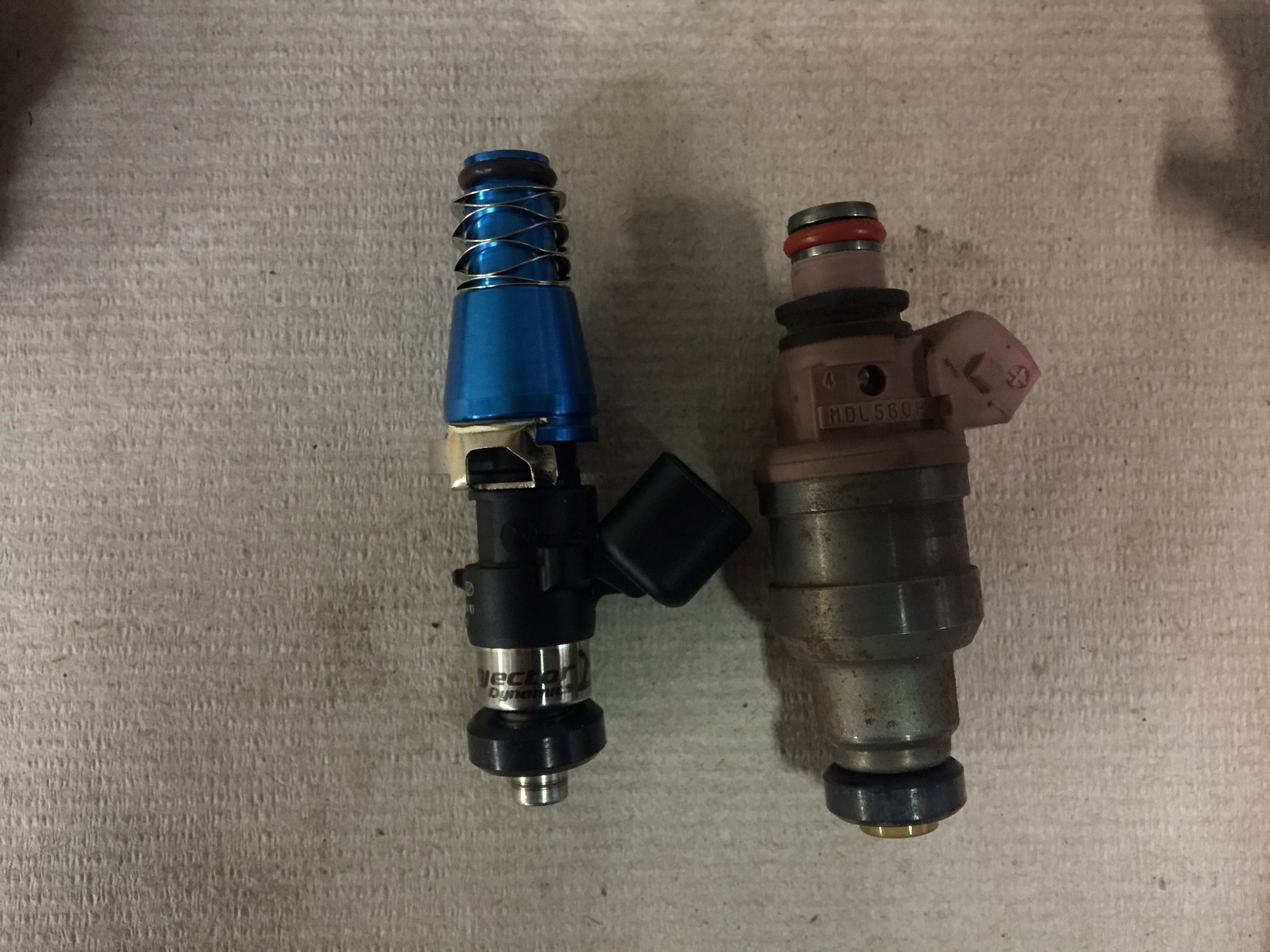

Well, got the Walbro 255 in the mail yesterday. Got my old pump out etc...which I may add was similar but slightly easier than my 3g Eclipse was. Got the pump out of the housing and realized it already had a hefty 255 already in it Oh well, worth the experience tearing it apart and just put the new one in anyway for peace of mind (so I may have a used one for cheap if anyone needs it, or may keep it as a spare).
Got the factory (i triple checked before tearing into it ) injectors out today too, and the ones from ID should be hear tomorrow. Glad to get the little things rolling and plan on ordering the head studs soon!

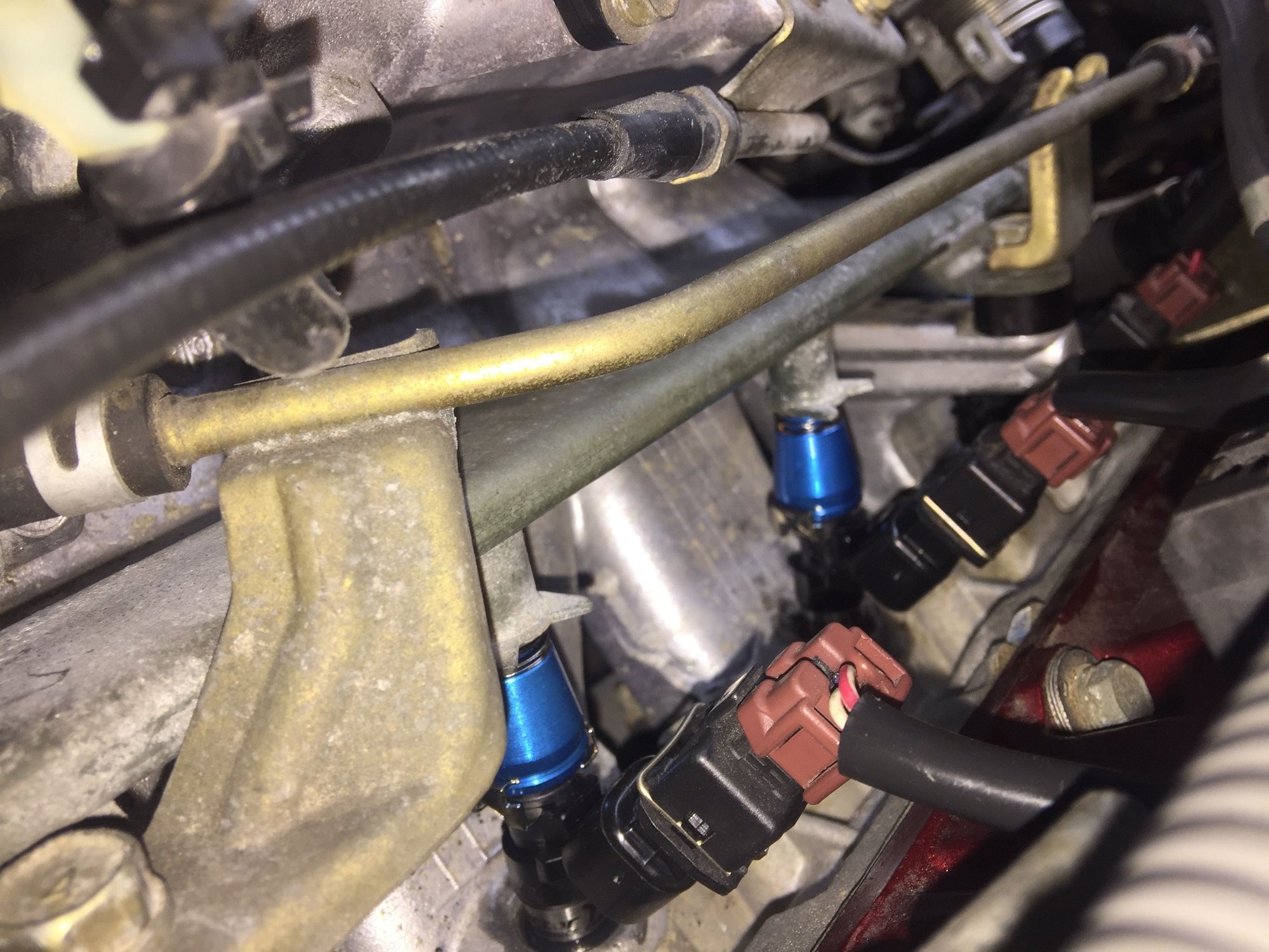

Injector Dynamics 1050cc w/ plug and play clips installed today!
For future reference for anyone who may do this similar setup definitley order the plug and play clips! They plug directly into the black portion of the OEM clips coming from the wiring harness, not the red portion that is around the OEM black part which I originally thought. And from there obviously plug into the ID injectors themselves!
