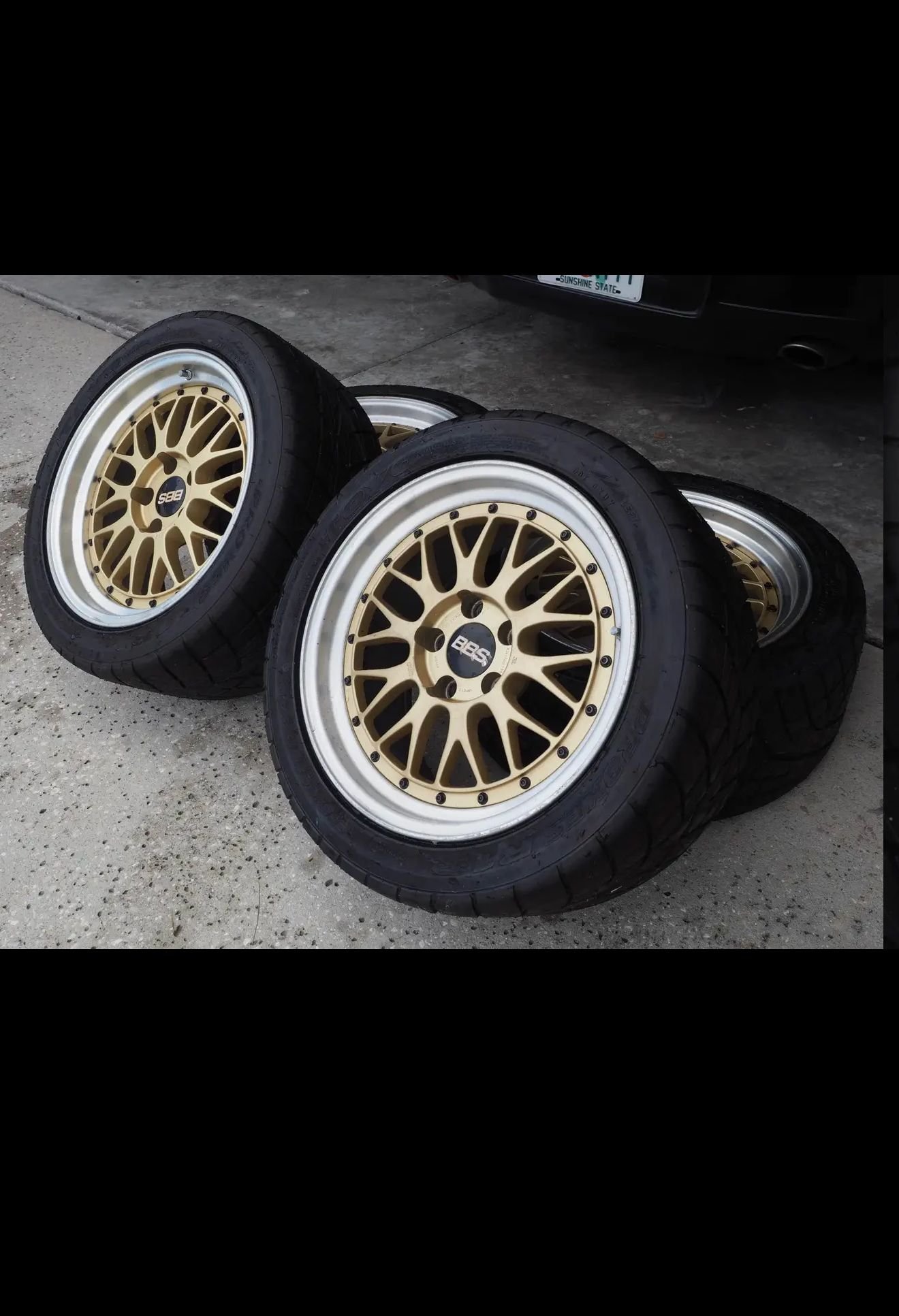

Hello, I recently purchased a set of BBS LM 17x9 +20, 17x9 +35 combination. Tires are 255/4017. I’m on stock suspension. Would I be better off running the +35 up front or in the back? Will the +20 clear the brakes and strut tower without spacers? Any information would be well appreciated.

Nice find! Run the +35 in the rear. You'll need a 3mm spacer up front for the +20. Make sure the hub rings in the wheels have a 67.1mm ID bore ( part number is x0923414 on ebay). I have no experience with stock suspension though. Good Luck!
