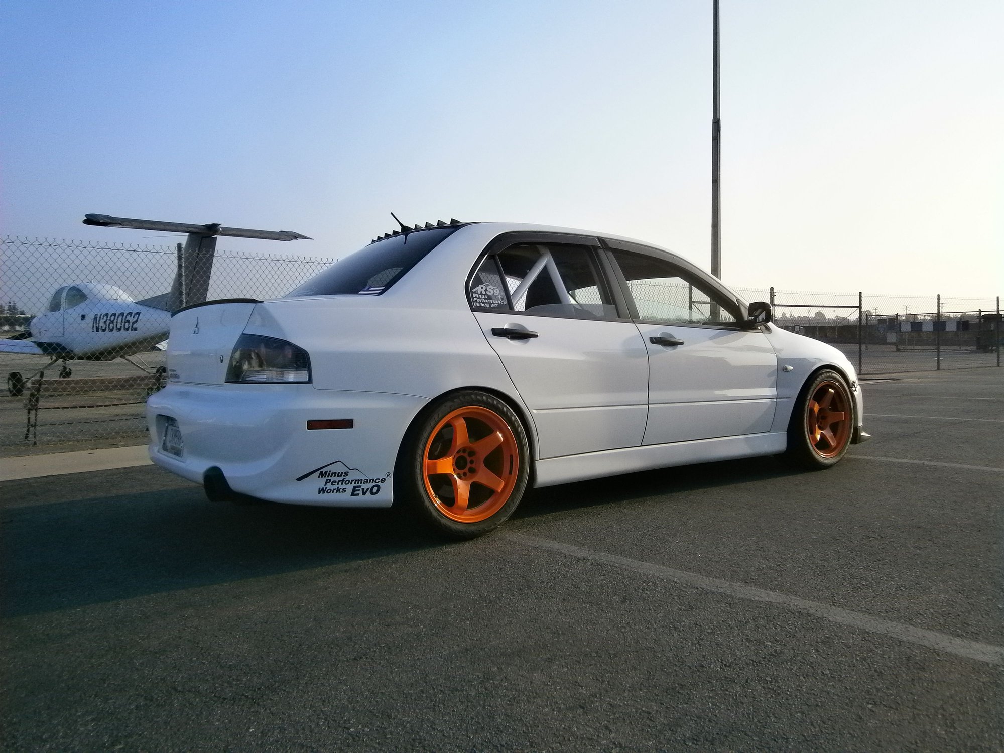

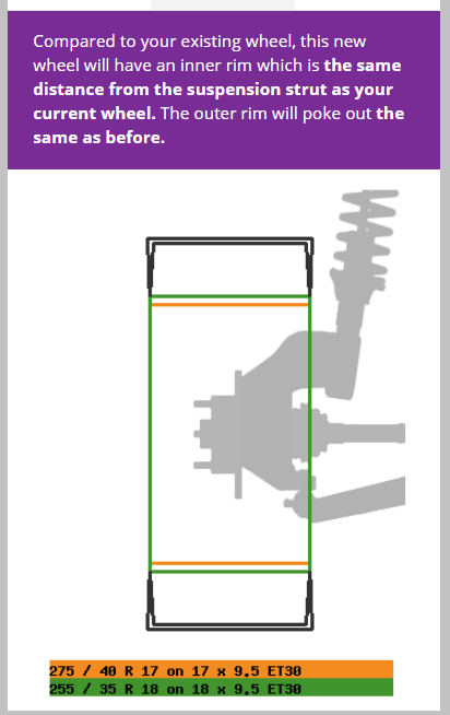

Old Mar 29, 2021 | 12:33 PM
  #431
Originally Posted by VeebeeIX
Rear fenders are already rolled.
what other work would need to be done to fit them ?
Using 255/35 tires.
Heres a comparison between what i run & your proposal. Its hard to say for sure, but i think you will be needing a very tight rear roll & possilbe bumper bolt re-location. (hopefully you wont need a rear pull)
My setup required all the tricks to fully clear. Now if youre OK w/some rub then raising the ride height & over -2 degrees of camber could do it. For me, rub can not be accepted at all

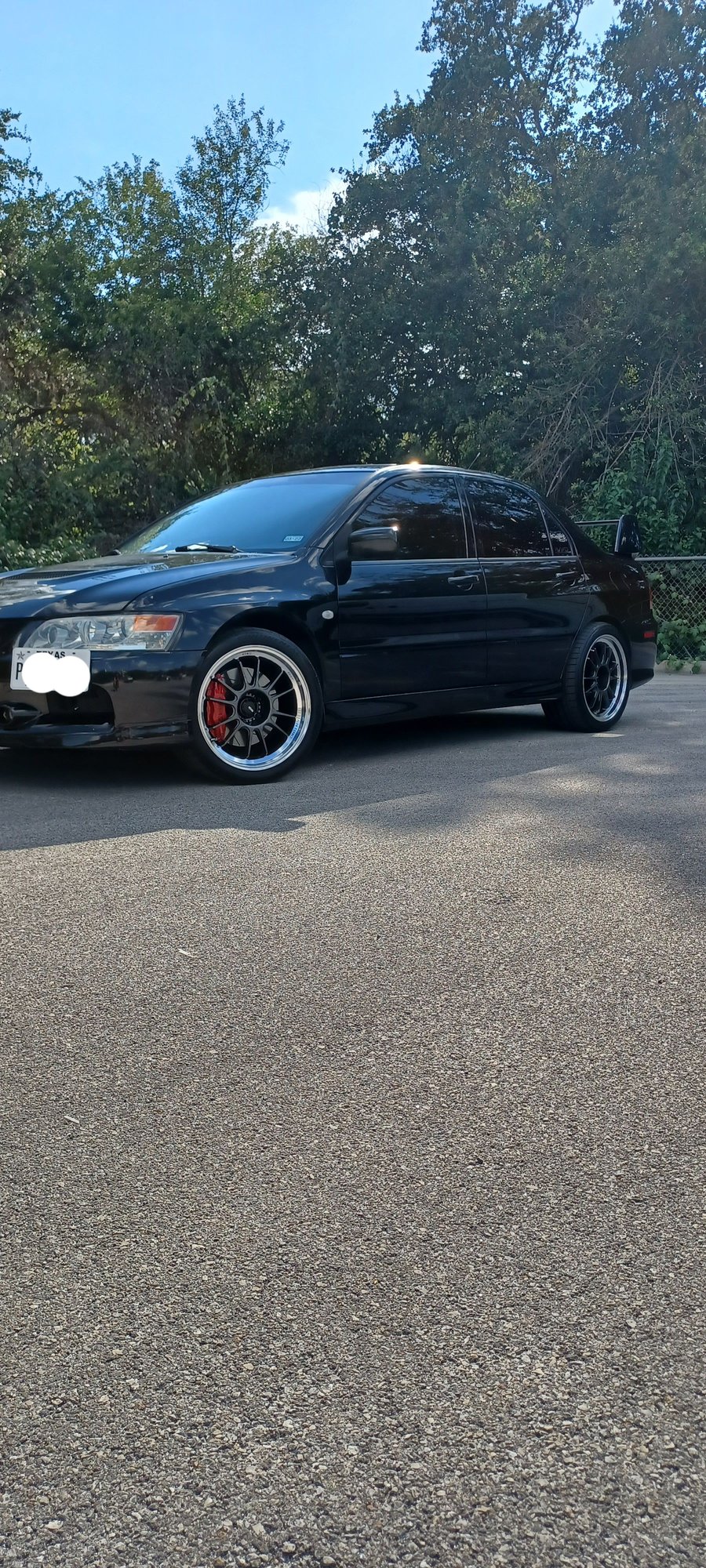

Old Sep 18, 2021 | 07:50 PM
  #432

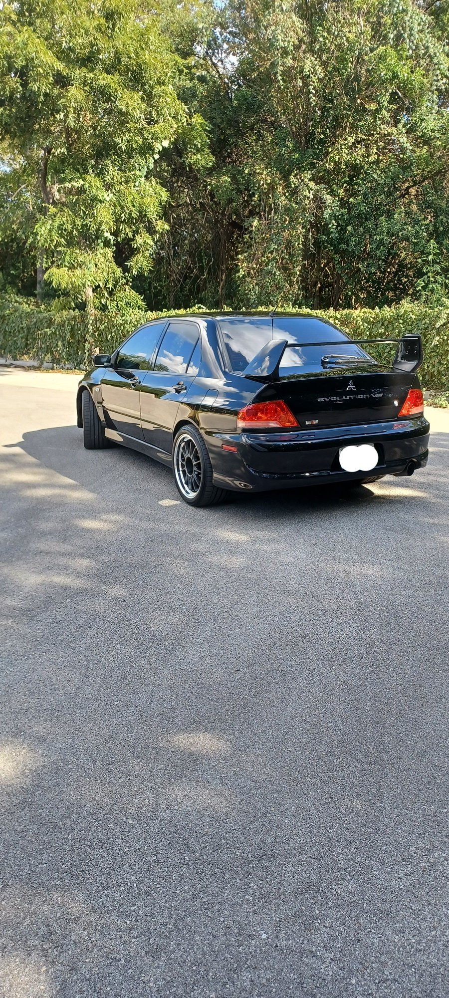

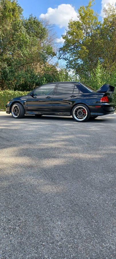

sotxEvo's Avatar
Joined: Mar 2011
Posts: 51
From: texas
New tire/wheel set
Wheels: Konig Hypergram 18x9.5 +25mm
Tires: Continental DW Extreme Contact Sport 265/35/18
OE suspension
Rear fenders rolled
No spacers
Old Sep 19, 2021 | 05:03 AM
  #433
OE suspension
Rear fenders rolled
No spacers
Good post noting the wheel & tire size, suspension & rear fender treatment. Looks real nice & that wheel & tire spec is certainly on the aggressive side. Have you thought about a set of springs? You may need some additional rear fender work if the ride height is lowered?

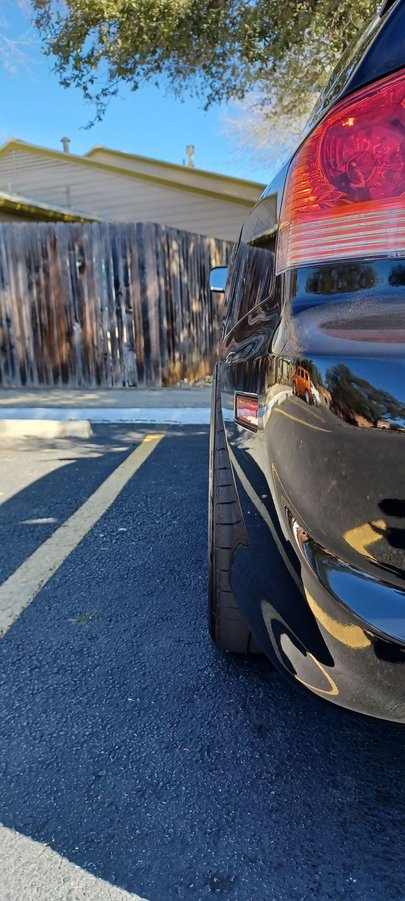

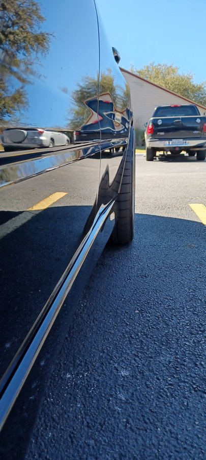

Old Sep 20, 2021 | 03:56 PM
  #434

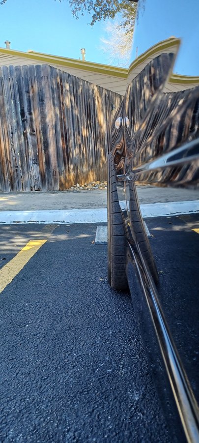

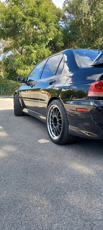

sotxEvo's Avatar
Joined: Mar 2011
Posts: 51
From: texas
New tire/wheel set
If I make any changes it will be switching over to Bilsteins like the Evo MR. Other than that I don't plan on doing anything else to the suspension.
I added some close up pics to show the offset a little better.
