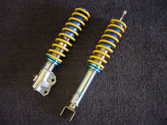

One thing that I don't like though, is that the damping adjustment screw for the front pair is actually at the bottom. So I can't just pop the hood and adjust it. I have to raise to car up to get to it. The rears though, are on top as usualy just like the tein flex.
-Kenneth
