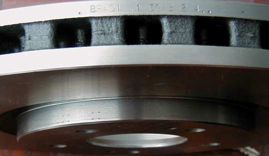

Actually there is a replica of the original OEM disc from Bradi wich is considered a lot better than the oem disc and it's used by a large number of gr. N rally teams in Europe.
Bradi Gr. N disc pic...
I got my bradis for an excellent price from Express parts http://www.expressparts.co.uk/ contact Paul.
plus oem pads are considered cr@p, go for pagids 4.2's or ferodo 2500.
