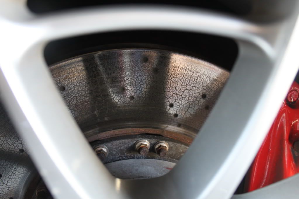

This happened to my old rotors. Heat checking, can't get anyone to throw liability to the wind and turn them.
So I need new rotors. Rotors that can take the abuse of deceleration from 150mph down to 45mph over and over again for 20 laps w/o heat checking like this.
Application vehicle is a 03 Evo 8 530awhp 500wtq track ***** with stock brembo calipers. Road course, specifically, and light autoX.
Any recommendations?

Those look like Performance Friction 2 piece rotors? Why not buy the replacement rotor rings?

Never was a fan of drilled rotors. Looks like most cracks radiate from the drilled parts.
Why not replacement rings?
What ducting do you have?

They are PFC rotors. I'm afraid if I buy the same thing again I'll get the same result, which is usually the case
Ditto, not a fan either, these are technically dimpled, not drilled through, but the same effect.
I have no ducting. Its something to look into.

Ducting for sure. Evo needs it - bad.
From the picture, looked like dimples go thru.
PFC does have other options. PFC how about blank or slotted options? (PFC posts here too).

After reading all the stories about rotors like this, it seems I'll be going down the blank route too (or maybe 2piece AP strap drive rotors that aren't drilled or dimpled but are slotted) and some proper brake ducting.
