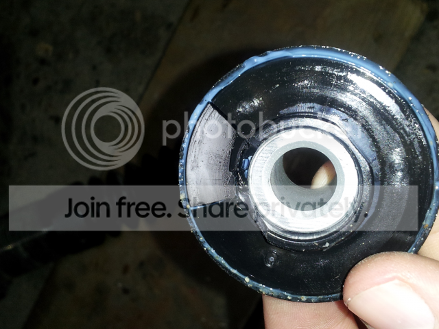

I did some research on these coilovers before I bought them. Heard a lot of good things even from STM. So I bought these d2 coilovers about 2 weeks ago. They were put on last saturday with no issues no broken bolts only took about 2 hours. They were put on by a friend of my family who owns his own shop. I noticed a vibration coming from the passenger front afterwards. I went ahead and bought an axel to fix the problem. I got the old axel out and the new one in and went to put the bolts back in the bottom of the strut. Next thing I know boom the strut rod breaks. The spring hits me in the head after ricocheting off the inner fender and damaging my fender a bit. Now I have a $1100 suspension that is broken on one corner and im afraid to drive on the other 3 if I was to replace it. Luckily my head is ok and I wasn't driving the car it could have been much worse. This is my daily driver so I also now do not have a car to drive to work. I don't exactly know how to go about getting a refund or getting this taken care of. Any suggestions would be appreciated.
A few pics of the broken strut.

I contacted d2 they said these just dont break like this. They asked me if I had lubricated the pillow ball mount. I said yes and that I used the lube that was provided with the coilovers. So does that mean that if you dont lubricate them that these will break? That doesn't seem right to me. Im sending them some pics and was told they will open an investigation. Not really expecting to get to far with them honestly. Since I paid with paypal im escalating it to a claim.

I've never ever heard of having to lubricate pillow bearings and mounts. In any case, the pics clearly should it snapped at the shaft.

FWIW after researching spherical bearing for a couple of weeks I found out that most of the time when used in an automotive application such as in your top hat they are sealed and dont require lubrication. A lot of them are teflon lined, thus dont require lubrication.
With that being said, I am quite confused and my only conclusion is that they were defected from the manufacture or were somehow weakened during installation. Given that you were installing coilovers aka a complete setup and didnt have to touch that top nut I dont see the likelihood that they were damaged during installation. Good luck!
